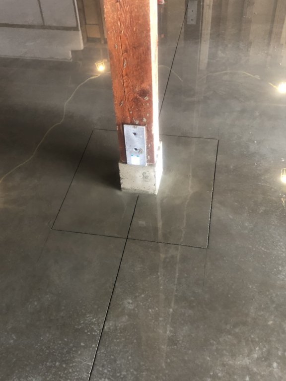

    Went in and cut the crack control joints and flooded the slab to rehydrate it .
