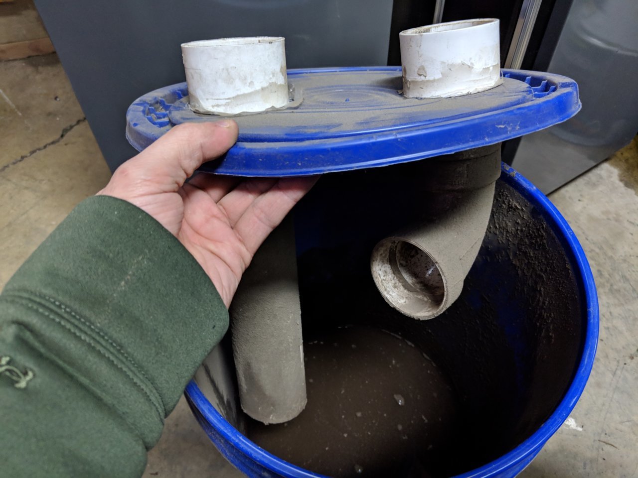

    I have a similar setup but bit differently setup. Left over parts same as you lol. The 90 degree is the outlet to the vacuum. The long down pipe is from my sand blaster. I keep it with ~2-3" of water in the bottom but Im only really concerned with the fine dust from blasting.
    Ill someday get a dust deputy for it or something else but this works fine for now....dont really notice must blasting dust in the vacuum.

    I wonder if I should switch my hoses around? Easy enough to swap them. I will try both ways but your way seems to make more sense to me

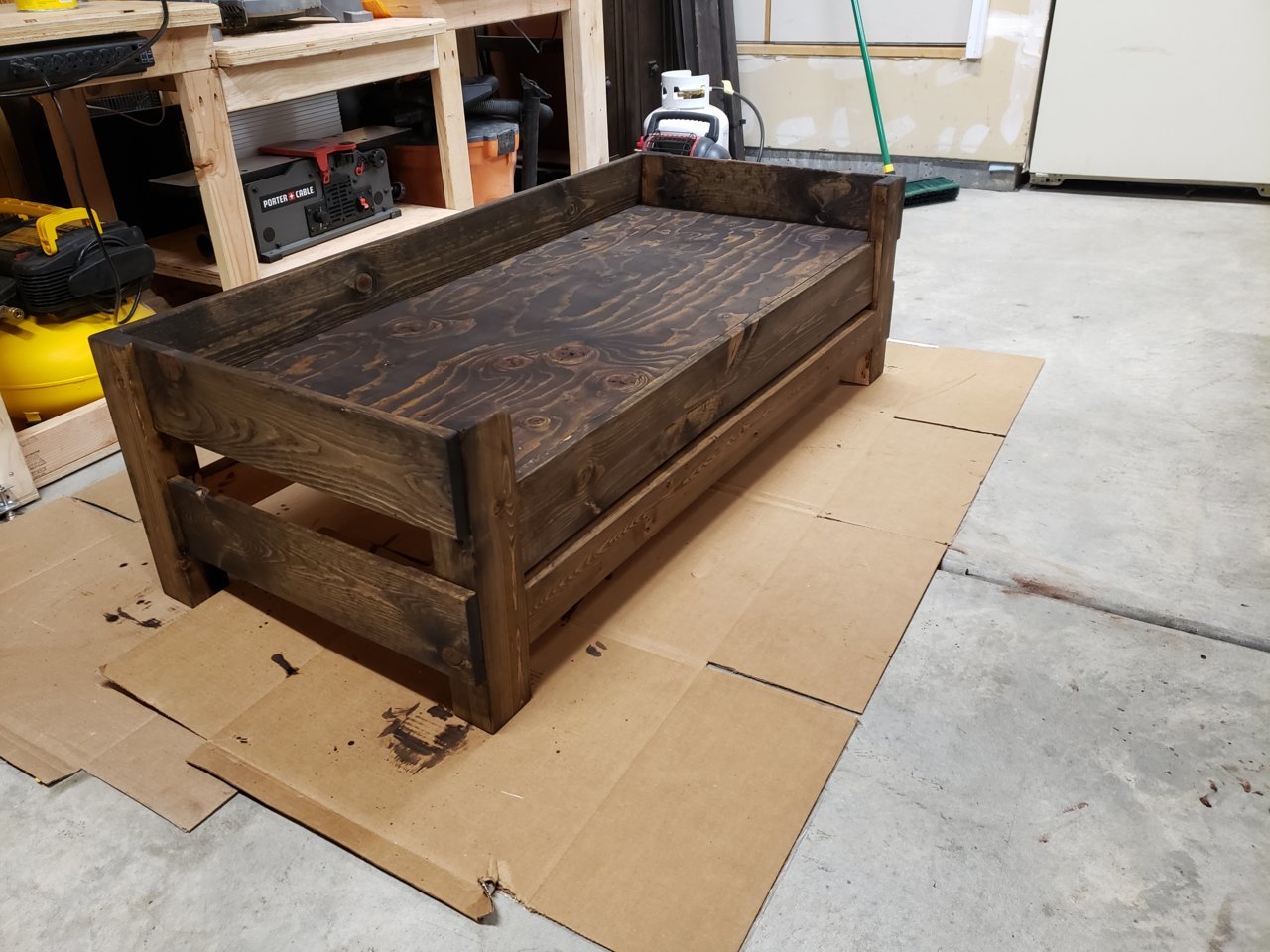

    Double doggy bed complete

    Just give it a try both ways. But I would leave it as is. That particular dust collect I showed is set up to have as much fine dust "sucked" into the water since it is a very fine dust.
    The other one works well for things like saw dust. I just emptied it and it was filled halfway so its doing well.

    Awesome job! Looks great.
