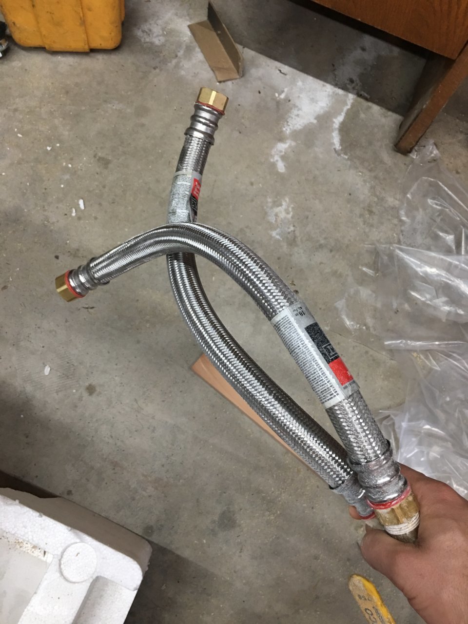

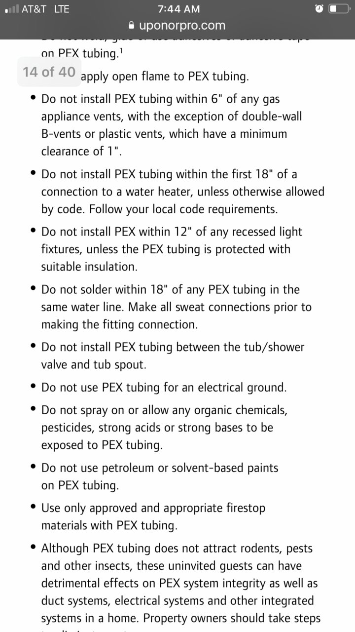

    Good looking out. Thank you.
    I just double checked the 2015 IPC, which my town follows. I didn’t see anything in the piping section, water heater section, or in my towns amendments that says you can’t install pex within 18” of a water heater. Let me know if I missed a section. I’ll call my building department tomorrow to verify.
    If not allowed, I can swap these boys in real quick. (The back side of the wall is currently opened)

    That’s what I do is use 18”-24” wboos. You can make a loop downward so you don’t have a flex in or thru a wall. If you’re careful you can reuse the wursbo male adapter
