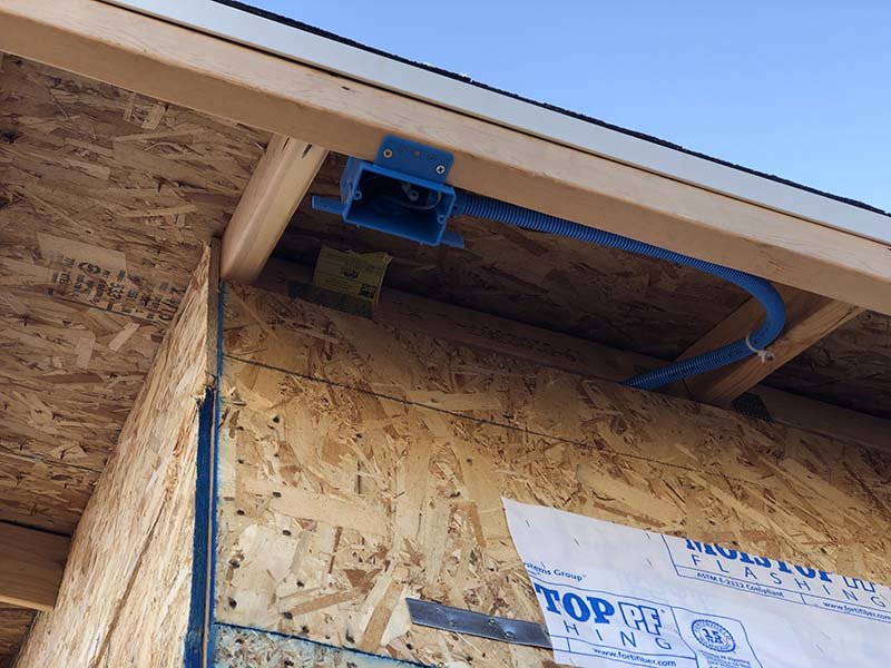

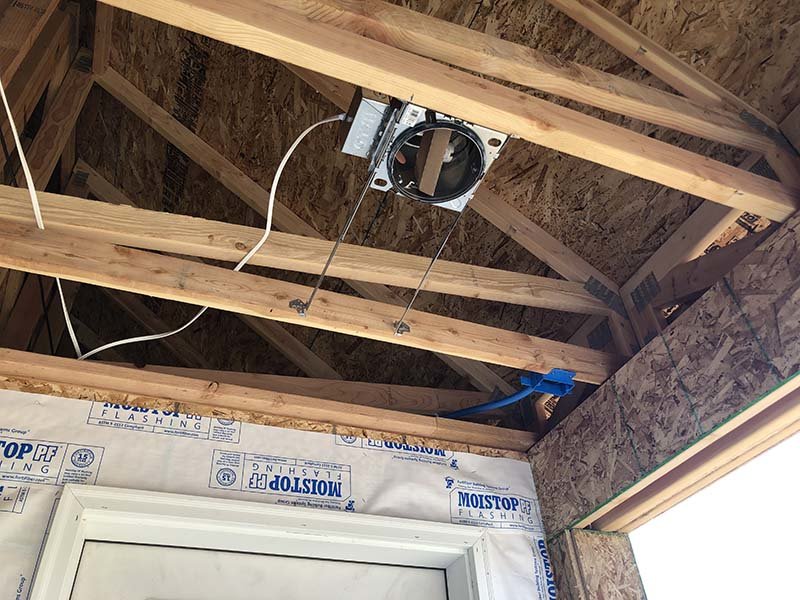

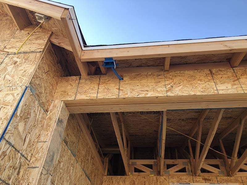

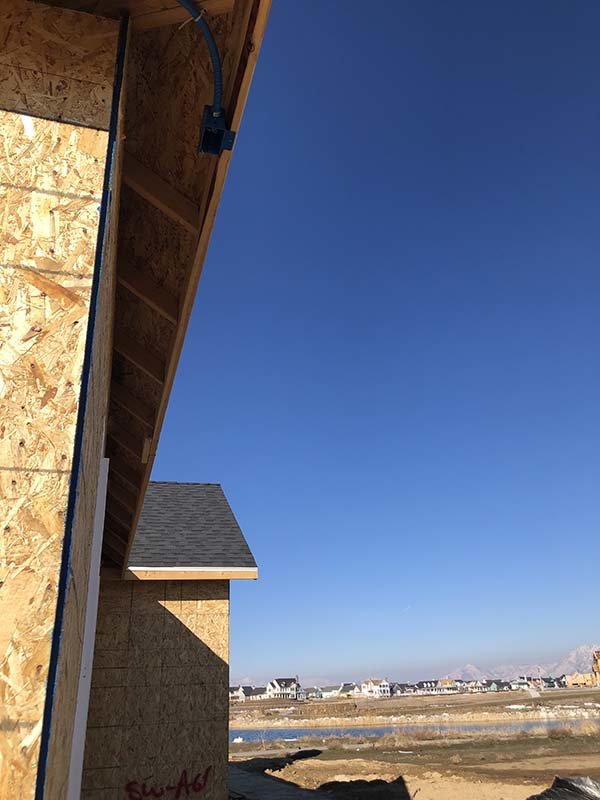

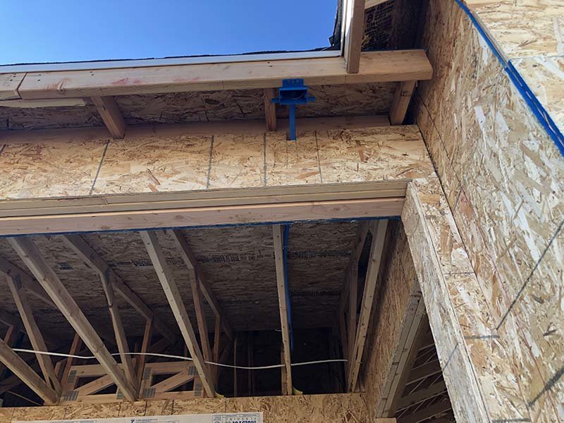

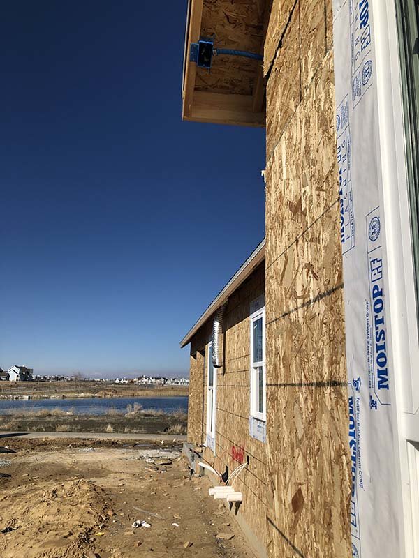

    Today I installed the rough in for the outside security camerasIMG_6762.jpg IMG_6767.jpg

    I'm curious about how the top of your rough openings are framed . Looks like 2 ply headers and then a 2x4 plate inside and flush to the bottom of the header . Is that a standard framing practice in your area ?
