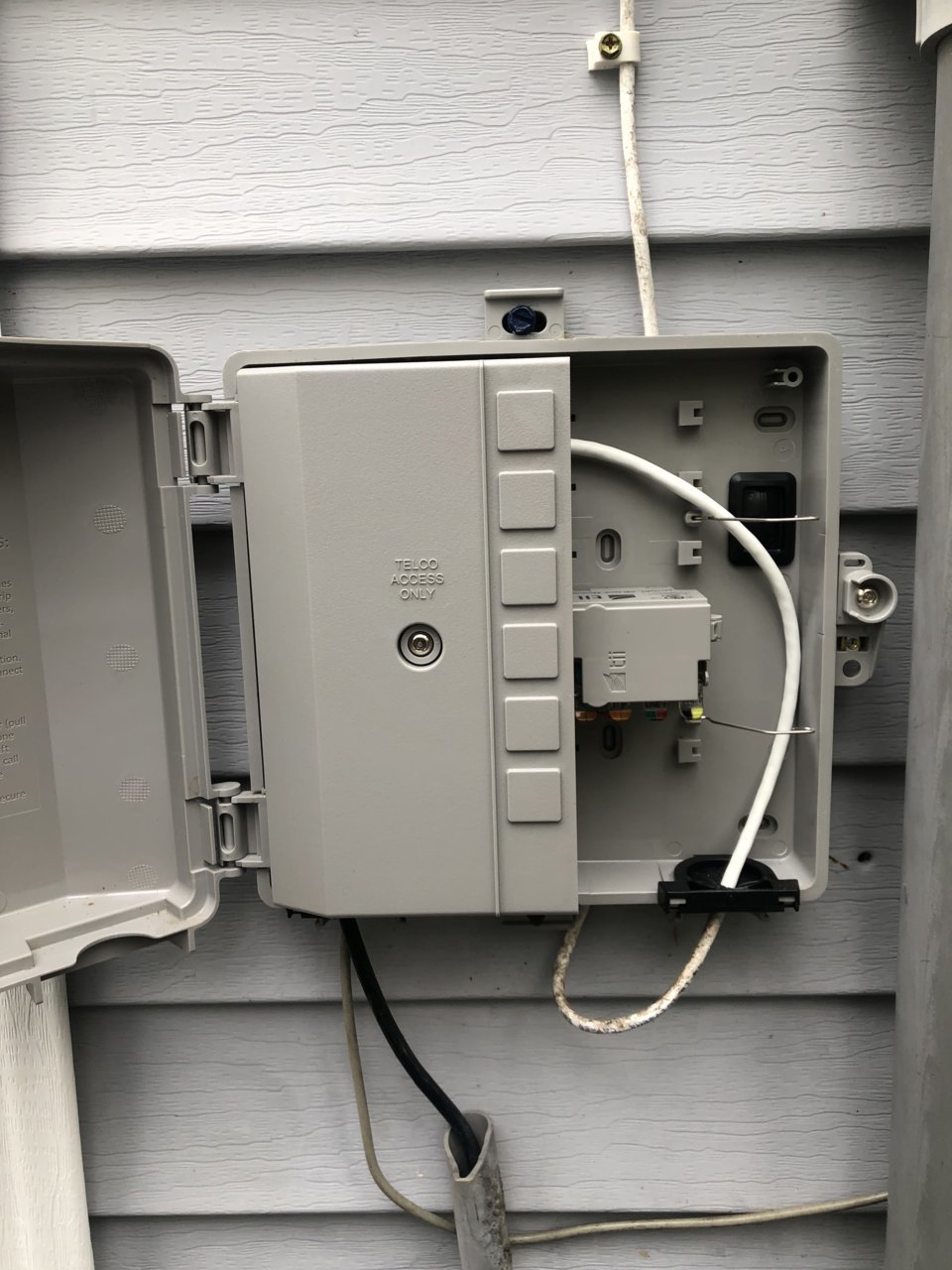

    There is a phone box from AT&T, from what I can see there’s one wire coming in the bottom (from the ISP) and the. The DSL line that’s currently running to the modem up the exterior wall and straight into the upstairs bedroom where the modem is.
    I had considered the possibility of the Cat 5 running into the back of the box but RJ45 (Ethernet) connectors are only used from the modem-in (I.E. from the modem to the user side) as RJ-11 is used for phone and DSL so I would likely* see RJ-11 at the wall if it went back to the phone box.

    Open that box up and see what’s in there lol then check the attic and crawl

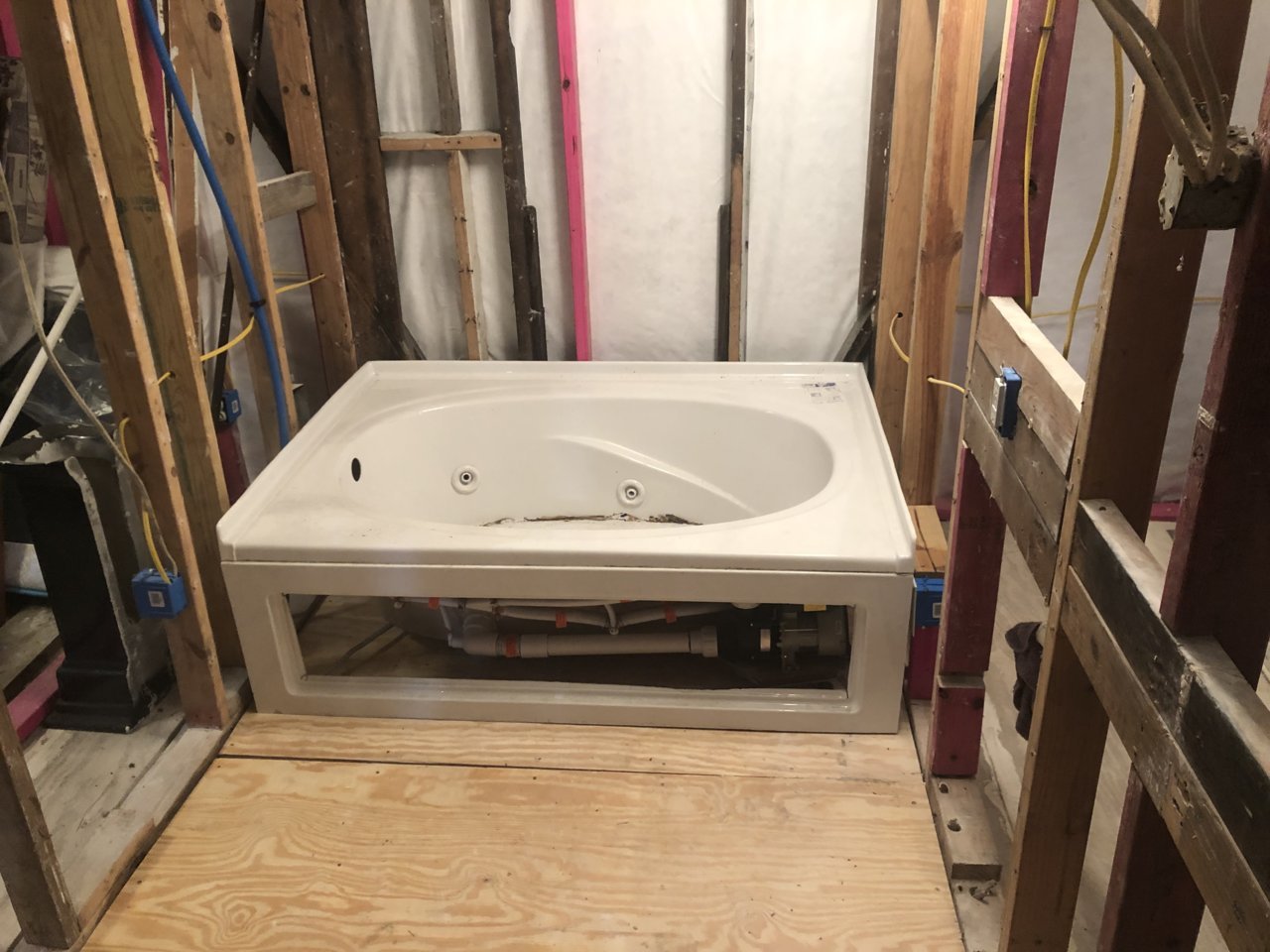

    I set the jaquzzi tub yesterday and have mounted ledger boards around and shimmed the bottom feet, however there is no nailing flange on this tub, so I am not sure how to hold it in place. I want to make sure that I have this right before I mix cement and put under it.
    Here is a picture of the tub before I built out the wall on the right side and added ledger boards around the sides to support the tub.
    So the edge that you see going up; I am going to lay backer board down to this edge and then tile slightly past the backer board to overlap the rolled edge.

    You are correct re the backer board and tile . Sometimes that style of edge detail comes with a clip that slips over the edge and screws into the studs

    U gonna leave any access into the jacuzzi guts?

    I assumed that front gets a snap in or magnetic access panel but if not you make a good point

    The jaquzzi guts is all front accessible. The motor/ pump is to the right and the faucet will be on the right side where the drain is.
    Not sure what else needs to be accessible?:notsure:

    Yes, it has panel that snaps in place...

    I’ve set some of those in the past but rock was on wall already and tiled in afterwards. I set so many jacuzzi tubs years ago I got a bakers cyst in my knees. Some important factors are don’t get in tub or you’ll crack it. Dry fit drain piping and once you get it glue it all in place. Pull tub back out and set it on a large bed of mortar but not so wet it squeezes out. Set tub back in and make sure entire bottom is supported and do not get in tub! Hook up drain trim and let it dry rock hard before putting water in it. Then you have a solid bottom. Sounds easier than doing it.

    The jacuzzi I have now actually sits on slab built that way from factory, it has feet and supports. It was a bitch on ones that didn’t have that.
