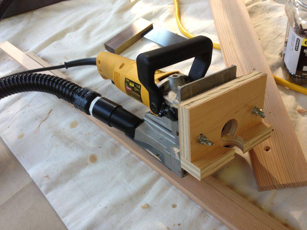

    No new pics of my curved trim project but all the curved trims except one have been laminated so by the weekend I will be installing them .
    I had to create a shallow table for my biscuit joiner in order to be able to use it on my doors , lol
    Build the tools to build the house , haha

    Now i see why you needed to make the custom fence, i figured you needed a lower depth than the regular fence allows but i couldnt figure out why. I had one of those disasters today, messed up some measurments on my cut list this morning, ended up losing 3 hours and now i have 6 raised panels that are 3/4" to small :facepalm:
