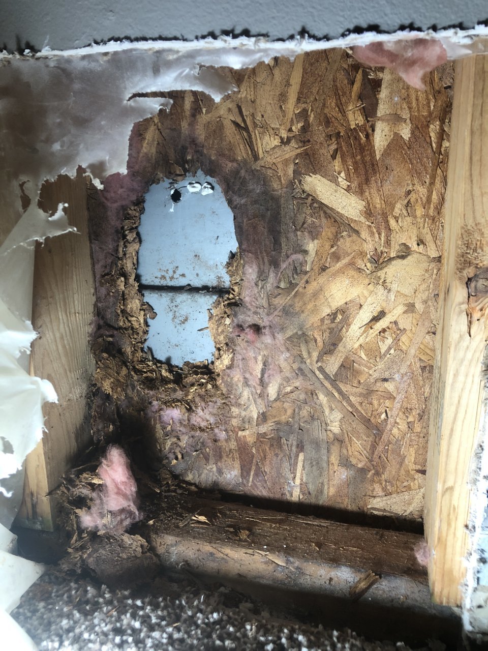

    Lol that’s kinda fuct that a small hole in the siding caused that....vinyl usually breathes enough around its edges that this shouldnt be happening that high up the wall. Is there any housewrap on the outside of sheathing?

    I didn’t see any evidence of it, I also don’t see any evidence of it at the corner of the house where the dogs removed trim.

    I don’t see anything for it other than pulling the siding and applying housewrap and flashing after sheathing repair
    Looks like u have a vapor barrier behind your drywall, I’m a newb as far as how that plays into wall assembly but @OZ-T uses it I think
    Does your insulation have a paper face on it?
    Are there any outside features on the house that could be channeling water towards the hole? Ice formation?

    Negative on the paper face, the insulation sticks together pretty well but I believe the plastic sheet is to keep it from falling out before drywall.

    Wonder if @95 taco lives in a warmer climate where a/c use would maybe change the condensing surface to allow the insulation a continuous moisture source to wick and feed the rot? Seems like excessive rot for just sheet flow of water thru a hole in the sheathing that minuscule

    OSB is prone to sucking up water and holding it far longer than plywood , thats why I.never use it .

    Ya having a place for airborne moisture to condense into insulation is not good :(
    Might be why they didn’t run housewrap, like they were thinking they didn’t want anything hindering wall assembly drying to the outside

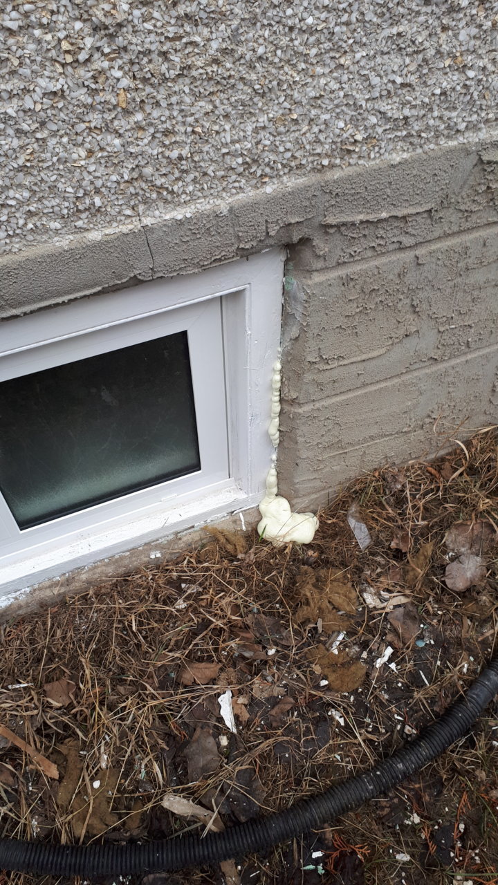

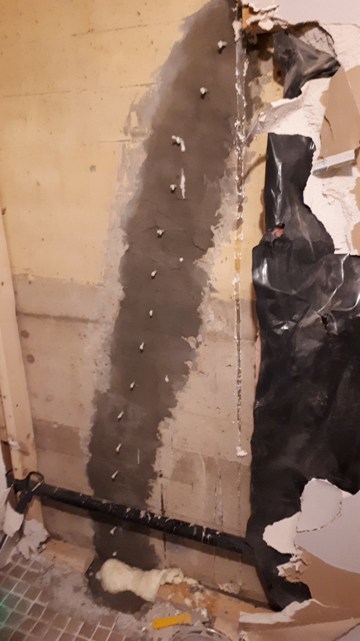

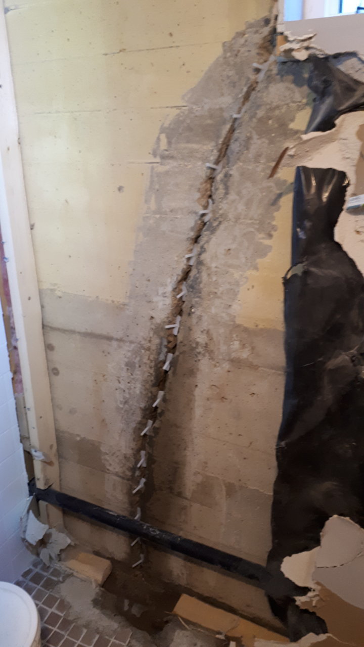

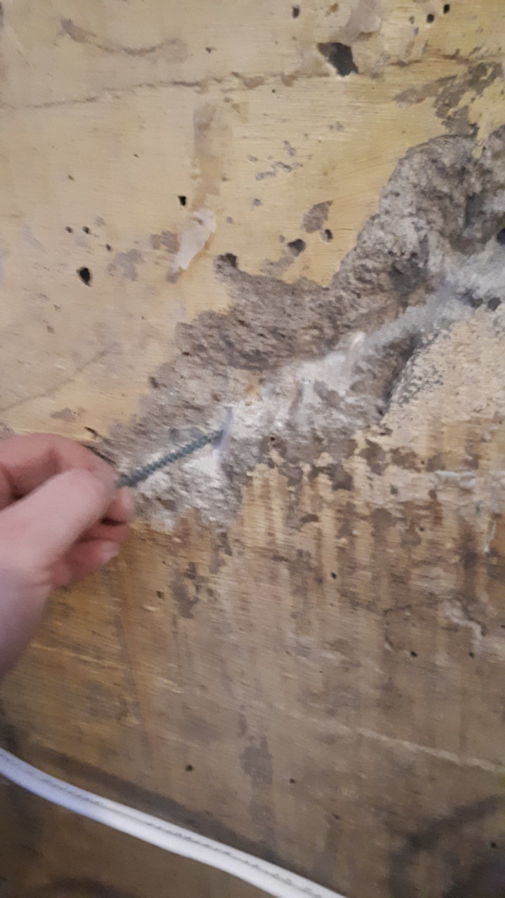

    Well...think I got BOTH cracks all sealed up. That was some of the messiest work I have done in a while. Anyhow here are some pics. Still got a lot of work to do once the ground thaws out. Drainage, grading and a bunch of other stuff.

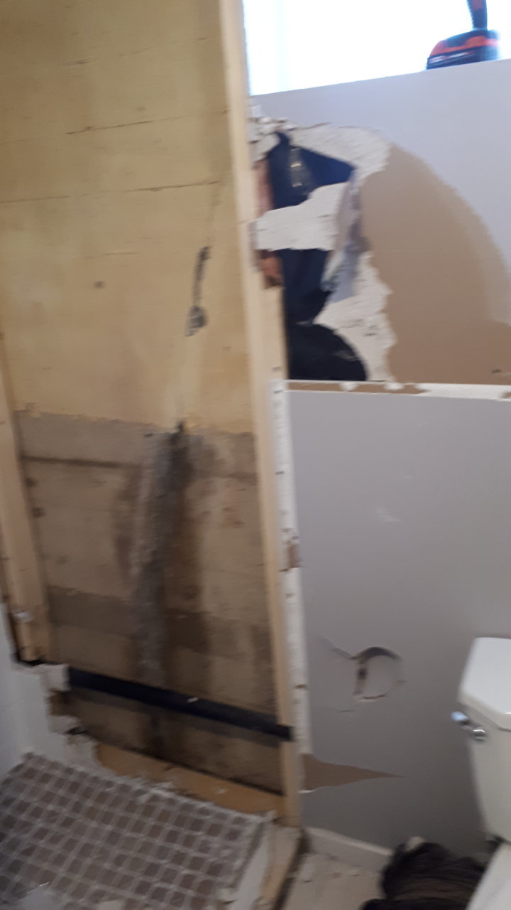

    So, originally found the one crack with the water on the floor. Found water in the bathroom and assumed it was from this crack. After I chiseled it out I picked the crack (heh) with a dental pick to open it up further so the product could enter as far into the foundation as possible..20190318_151249.jpg
    Once that one was sealed....found more water in the bathroom. Sooo out comes a wall....to reveal this guy.
    Sorry bout the crappy pic.
    After about 12 or 18 hrs of chiseling and picking, I was able to open this one up much better than the original crack. Now with practice and knowing how the product would behave, I was able to ensure better results.

    I also found their installation of basically anything they touched was wrong. Vapor barrier wasnt taped, electrical splicing INSIDE my walls and numerous cut corners. Not familiar with shower installs but drywalling into the concrete and glueing the tiles on doesnt seem right..
    Basically. Everything that isn't original will be removed and start from scratch....:puke:

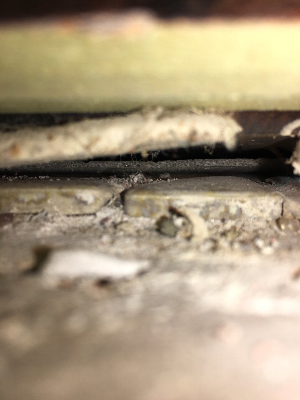

    So I found out what type of tile was original to my house.
    Previous owner didn’t remove it in the front entry. They just laid the laminate wood directly over it.
    FML. Guess I’m just going to leave this room alone for now.
