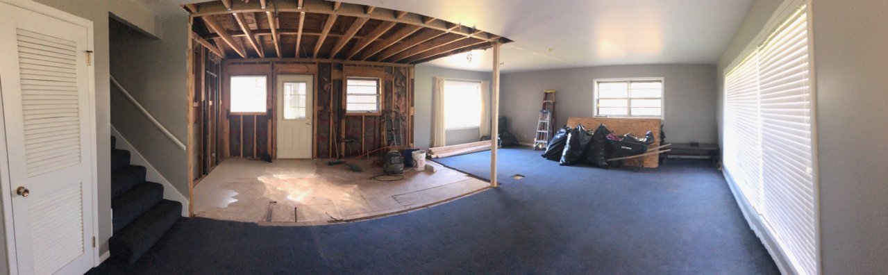

    well after adding to the scope of work we are finally moving forward more now. 3 weeks of not being in my house so that it could be 100% redone electrically and brought up to code has been a pain. contractors are patching drywall and wrapping those projects up now so I can get back in this weekend, then we can finally get back to putting the bathroom and kitchen back together. hallelujah.
    Hawco636 and truchador like this.

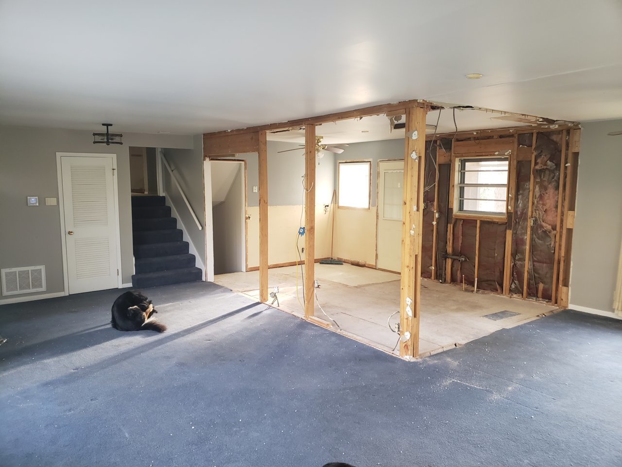

    can't remember if I shared this shot or not....close to where we currently sit progress wise..
    robssol, Slashaar, Crom and 1 other person like this.
