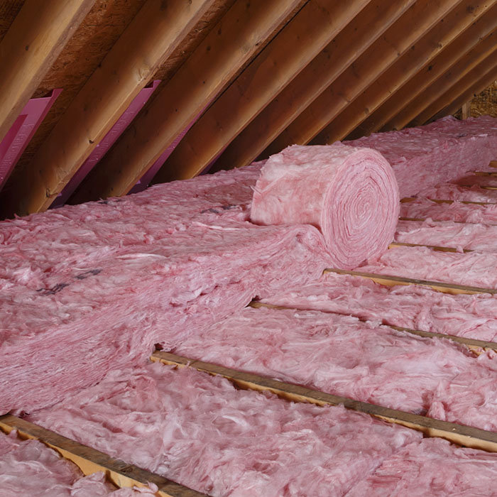

    Yes that is where you will get thermal bridging , but I see no soffit baffles , you should be using those too

    Exactly
    also soffit baffles present and accounted for :thumbsup:
