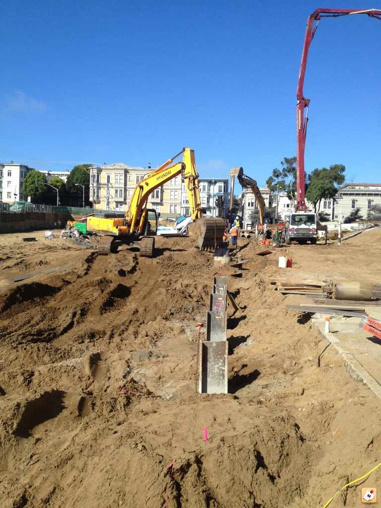

    Hopefully today is the last day of soldier beam installation. The sand is killing production.
