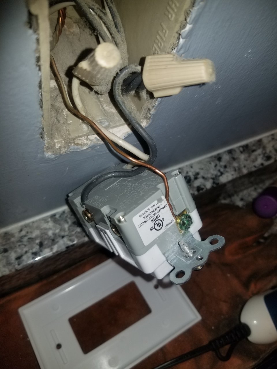

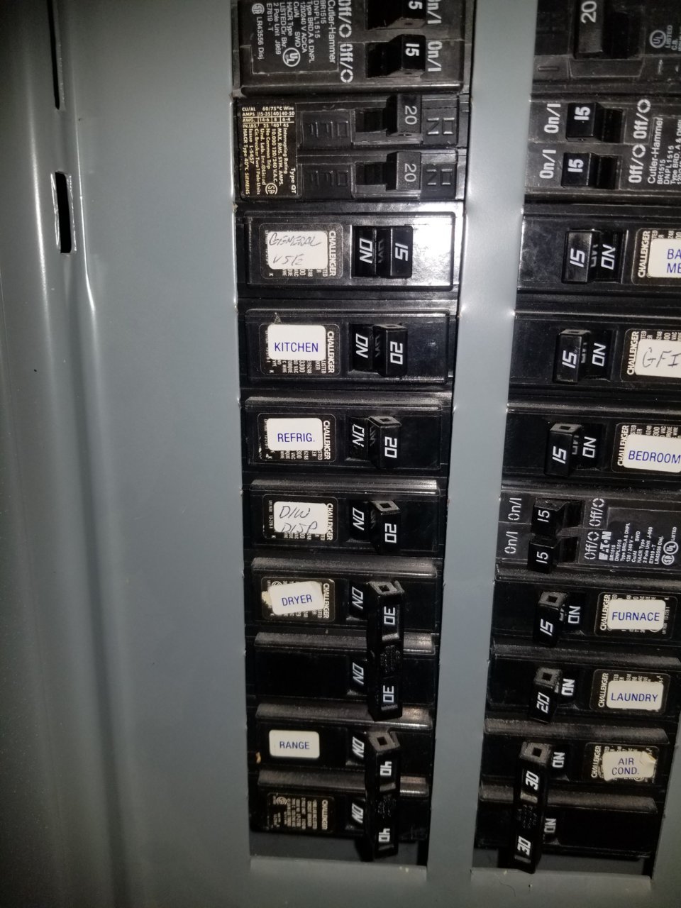

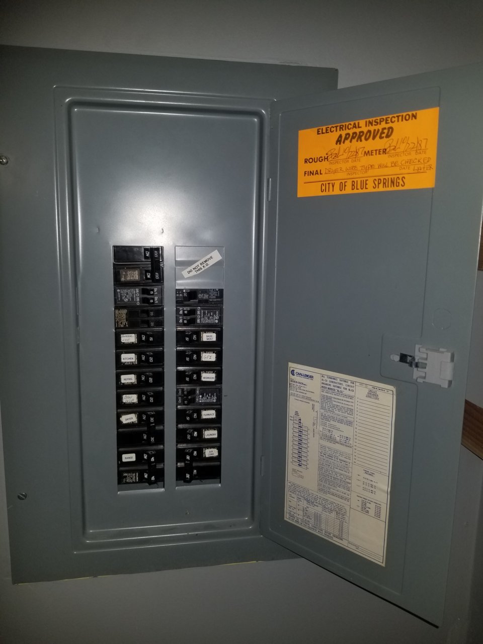

    Im no electrician so you’ll want to verify but I’m pretty sure the last gfci outlet in a run should be connected on the “line” side not the “load” side
    @Slashaar i just confirmed with a master electrician that if u only have one set of hot wires plugged into a gfci they should be on the line side :)

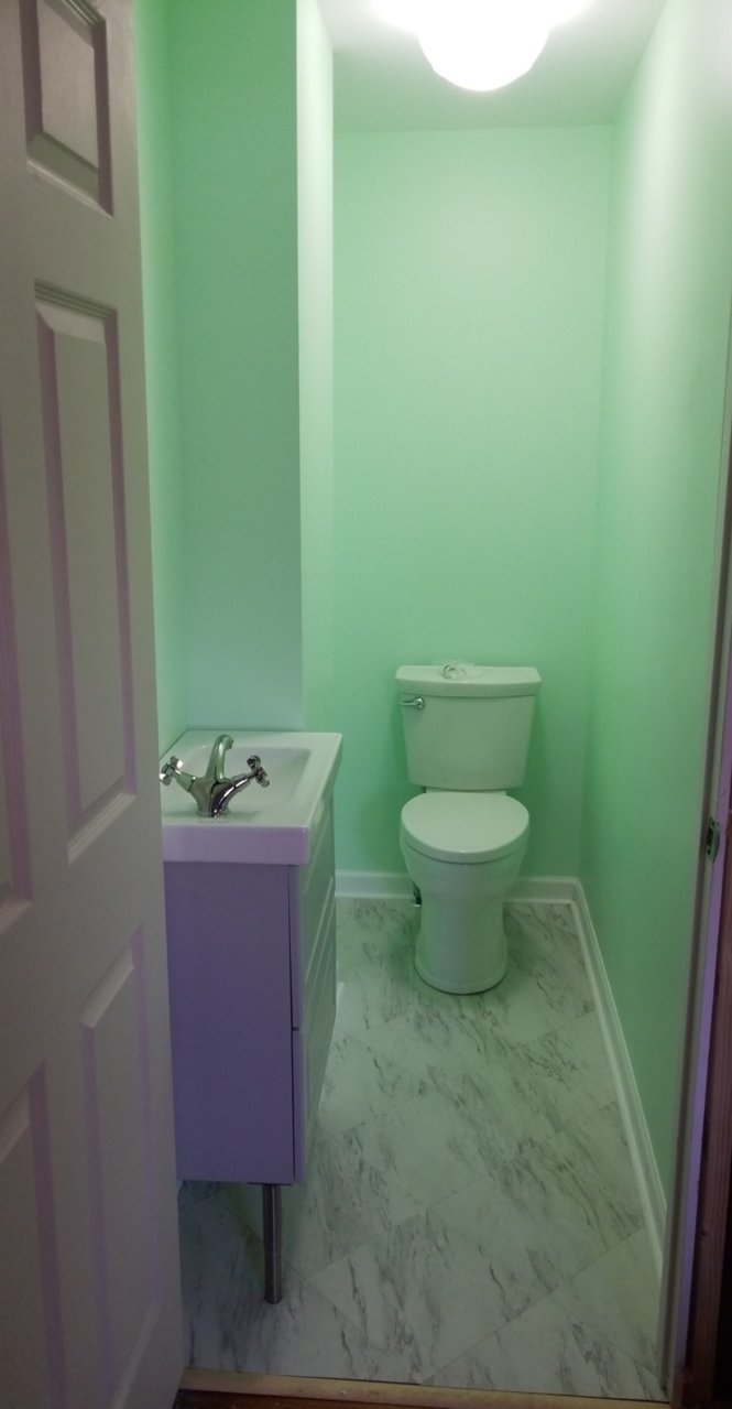

    Nice work. What model/brand is the vanity? I'm trying to get the ball rolling on a bathroom project with an existing pedestal sink. Hate the pedestal sink but also every other small vanity I've seen.

    Just to clarify. I should move the Black (hot wire) to the area marked line, retaining the side its on, and also move the white (not hot) to the line? Currently, its wired upside down, and both wires are across the load line. Could it be possible they are wired backwards and on the wrong line do to the outlet itself being upside down? This seems to be the last GFCI in the run since all the others function. Thanks.
    EDIT: seems they are on the correct sides and just needs moved to the line directly down. Thanks for your help.

    Doesn’t matter to the wiring which way is up on the outlet face, so long as the black wire is attached to the brass screw, white to the silver screw and ground to the green screw. In this case on the terminals designated “line”
    And to reiterate: free advice on the internet can be worth what you pay for it so be careful and maybe read over some basic literature on residential electricity.
    In other words it’s not my fault if you burn your house down :)

    I figured it out. Was wired wrong. Moved the wires as @truchador said to the line instead of load and viola. Power. My 3 prong tester reads good as well.
