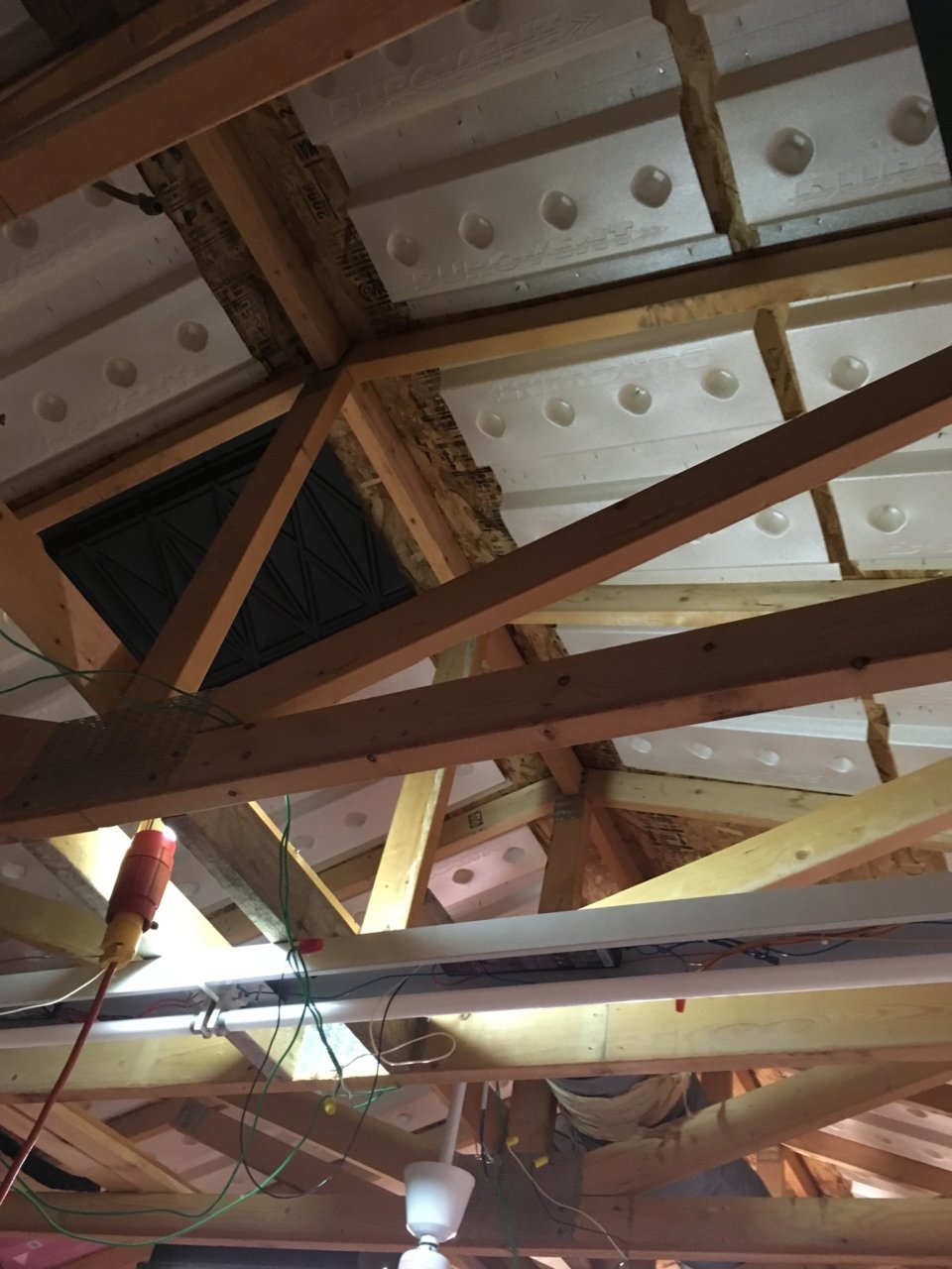

    The Durovents are 24" wide with perforations to split those to 12". Not trying to sound like a dick but no airflow will lead to overheating your attic in summer and can lead to mould growth on the underside of roof sheathing in winter

    Were you insulating the top chord of the trusses ?

    im going to be putting some of these in my attic. do I run them all the way up? I have only seen them a couple feet up.

    Yes, Installed a Ridge Vent as Well.

    For blown in or batt insulation in the bottom chord of the truss or ceiling joist they only need to extend about a foot above the top of the insulation

    Sorry, My Bad. Cathederal Insulated with Roxul. Then Duroboard over top.

    Ok OZ-T question for you on these baffles. Sorry I don’t know some of the structural terms. When I put these between the roof joists and down to the vents they don’t actually go on the vents. The stop against the face board that’s nailed against those roof joists and the vent is nailed to the bottom of that board. If that makes sense? Do you fold them to go down that board to the vent?

    As long as the baffle (Durovent) gets to the soffit (ie the portion of the rafter outside the wall where the vent is) that will allow the air to flow from the soffit vents up above the insulation to your ridge / pot / gable vents

    Still debating if a poly vapour barrier is required with this 1" duroboard. Better to be safe than sorry I guess.
