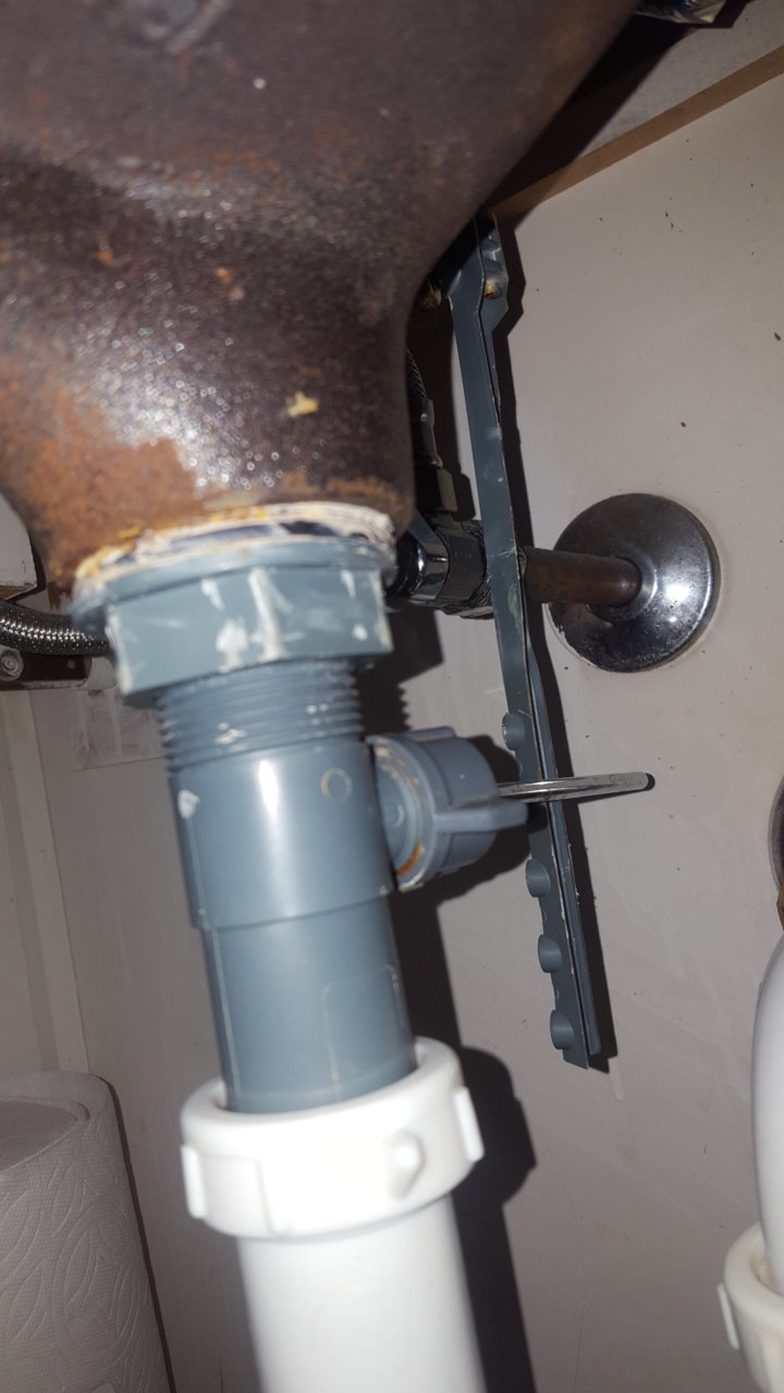

    The 3 cast Iron that everything ties into is your waste and vent stack. Your lav drain that ties into it, has it been redone? original would have been threaded galvanized pipe or lead. Check that. Does the sink drain have a pop-up or grid strainer like in a public restroom.
    Grid strainer air gets trapped underneath and drains slow and if its a stopper, have you taken the stopper and trip lever out and cleaned?
    Start with the dirty arm going to your main stack.

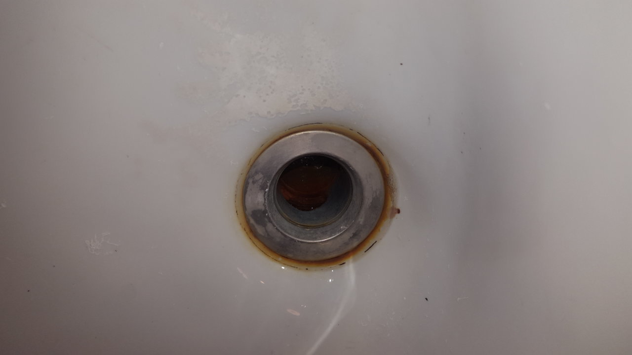

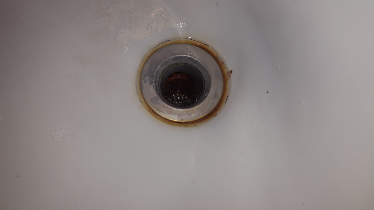

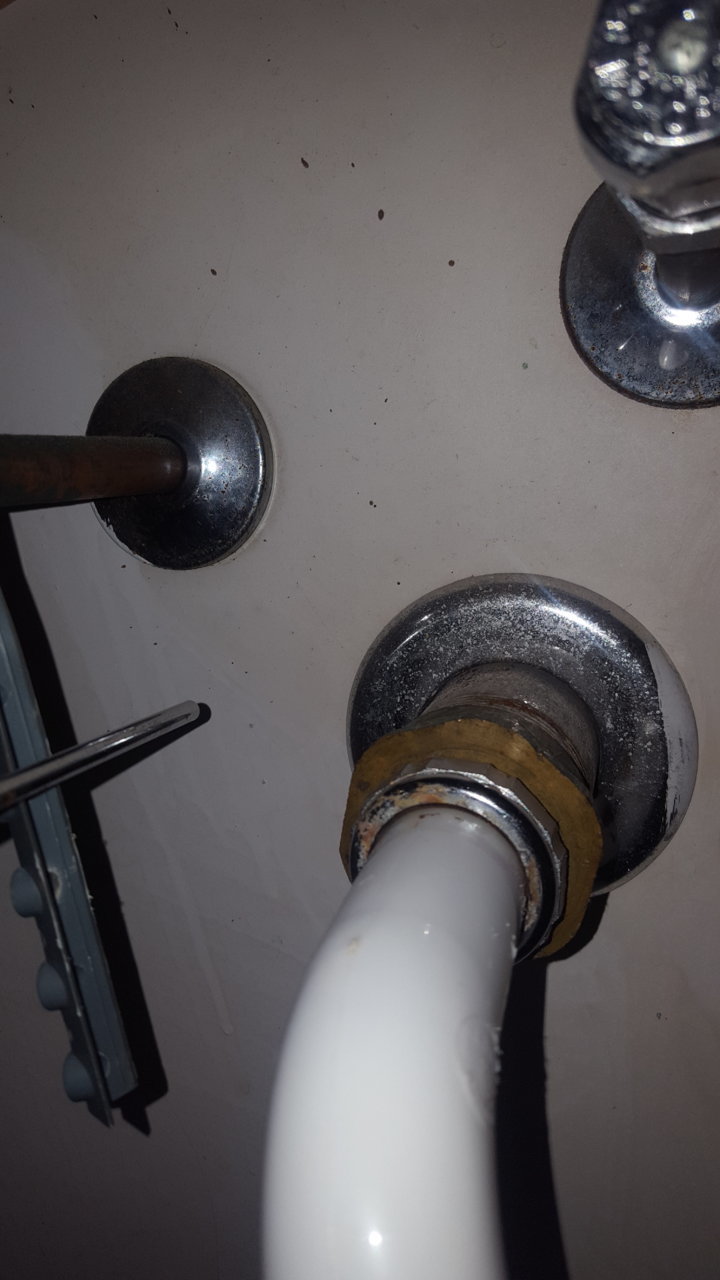

    Yes, PVC goes into what I would assume is cast iron at 90 degrees.
    There is a stopper but it is not connected, I originally figured something was wrong with that but when I removed the white PVC to inspect for clogging I looked down the drain noticed there is nothing attached to the stopper part inside in the pipe, thus I didnt bother replacing that part, figured its just a straight pipe now.
    I can buy one, not sure what you mean by vented properly, Ive only ever had to deal with plumbing before it gets in the wall before.
    I know after hurricane katrina(2005) the downstairs was redone including the bathroom, I dont know about the upstairs bathroom though, based on the condition of the sink and the metal pipe the PVC goes into I would assume not but I could be wrong.
    See top quote about the stopper, I was hesitant to replace that section of pipe since it looks like there is sealant where the nut attaches to the sink and I wanted to reinstall the pipe and see if cutting the PVC shorter did anything, the PVC that goes into the cast iron pipe was pretty long so I cut off about 2 inches, was thinking maybe it was almost hitting the back of the 3 inch pipe thus slowing down drainage, but that didnt fix anything.
    I assume by dirty arm you mean the short metal pipe the PVC goes into that connects to the large 3 inch pipe which I assume is the stack?
    When I removed PVC I could look right through that short pipe into the large one with nothing blocking it.
    Stopper that is not attached that is just a straight pipe.
    Where PVC goes into smaller metal pipe that goes into large 3 inch pipe.
    Holes in sides of sink drain semi visible, probably not important.
