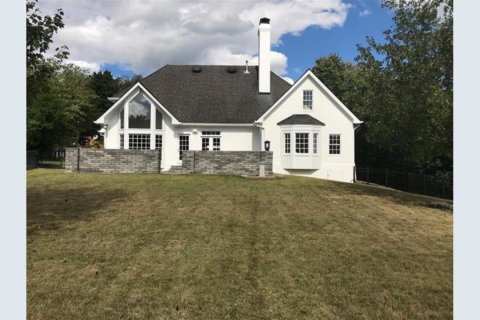

    ^^^ View from patio to lake and from lake to back patio.
    Here are some pics of the house I just sold. Had it 21 years and worked on it all 21 years as a retirement project.
    Took it completely apart (TERMITES EVERYWHERE) did 99% of the work myself with a weekend helper (subbed out roof and counter tops) ... replaced all the stills and bottom plates, some walls, floors, removed all hardcoat stucco, Styrofoam foam brand sheathing and installed 1/2" plywood back in, blocked ALL edges of the plywood and nailed it every 8" around the all the edges, replaced all hardcoat stucco, windows, doors and flooring, new driveway, new xeon zoysia sod and stuff I can't remember.
    Got a good deal on it and still lost money but had fun until I got tired in the end ...

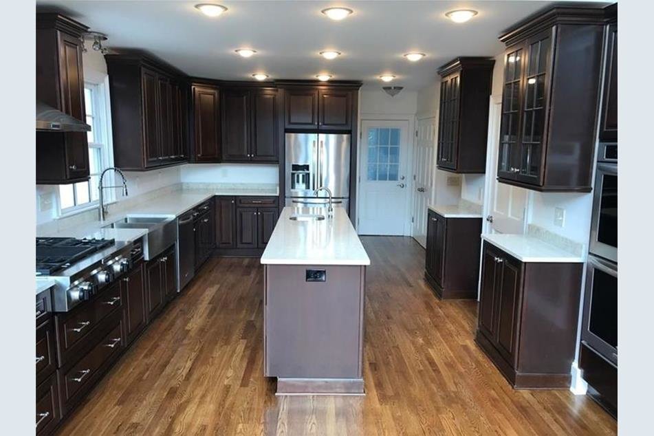

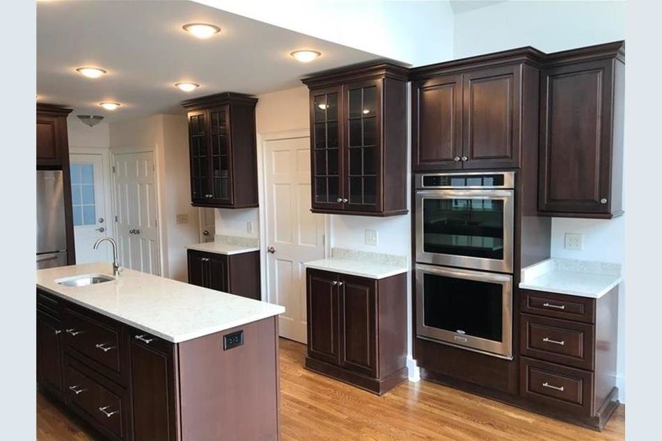

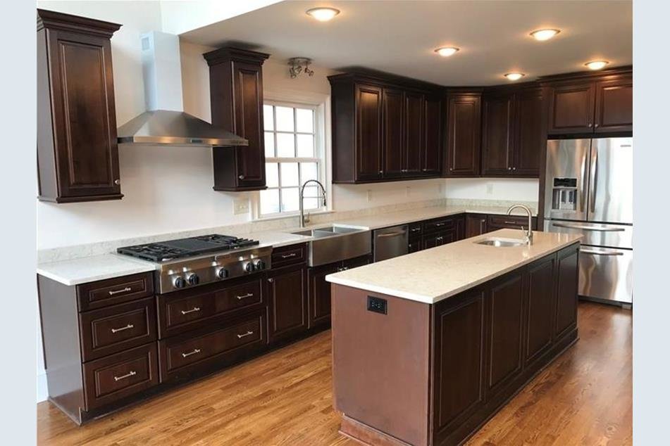

    I didn't finish the back splash and did a cheapo light over the sink to finish it before the sale.
    (Later, I added-replaced the end panel on center island to match other end panels)
    The appliances were all Kitchenaid and got most of that stuff on sale.
    Completely redesigned the kitchen and built a regular fridge into the wall (broom closet) to make it flush with counter tops.
    Took out electric cooktop and put in gas, 2 new HVAC units, new H2O heater, installed 4 skylights in attic .. (1 skylight with a door-hatch to the top roof :) for no climbing on a ladder to get to the top).

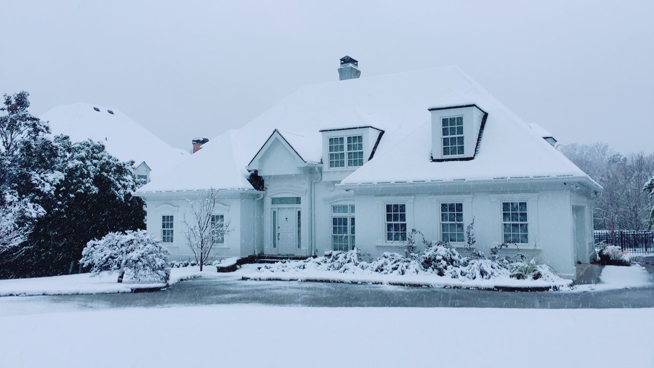

    Here is a pic of the front ... all the door and window trim was done in sculpted concrete over stainless steel mesh (not wood trim) ... had a Russian teach me how to do it using sculpting tools and making a whipped cream type concrete for 3rd and top coat.

    Wow!! Just Wow!! I am impressed. What part of the country?
