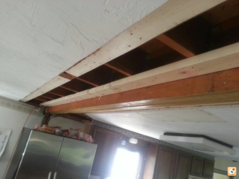

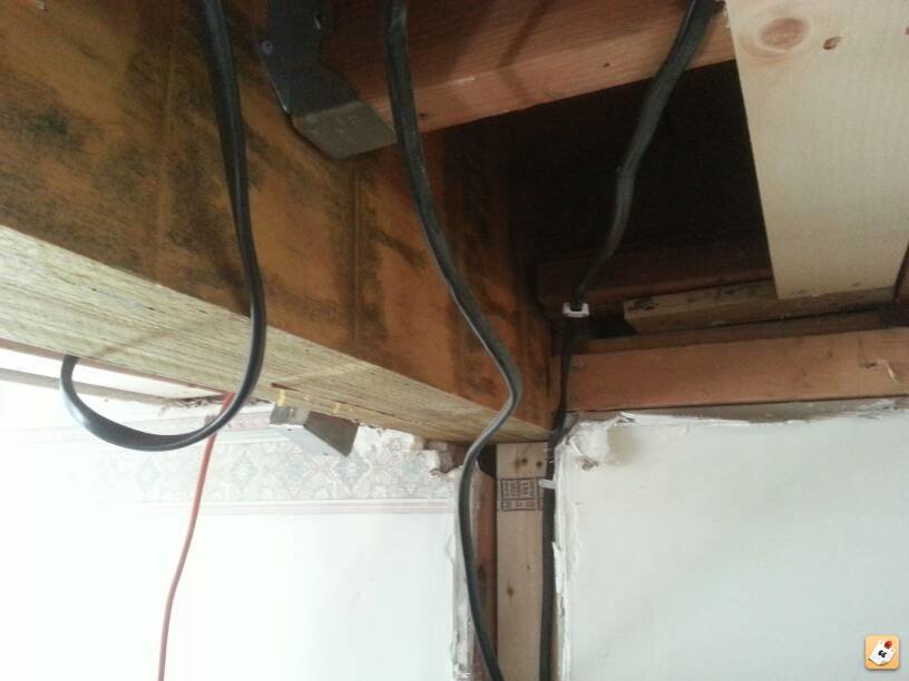

    looks good so far. question though in pic #5, one of those wasn't a load bearing wall was it? seems like a big area without any support.

    aruha4e6_63b16a23774f2eff7497a5ac271792c1d61b378c.jpg3y3yba6u_d473eb15e47545d5f928f044650af242316b0cfe.jpgThere are 3 lvl's lammed together up into the ceiling that is showing about 3 inches in the pic. One side is tied into the sill plate on the outside wall and on the other side is tied into a lolly in the basement. The pics don't really do the space justice, so much more open so much light. Just need to find time to work on it.

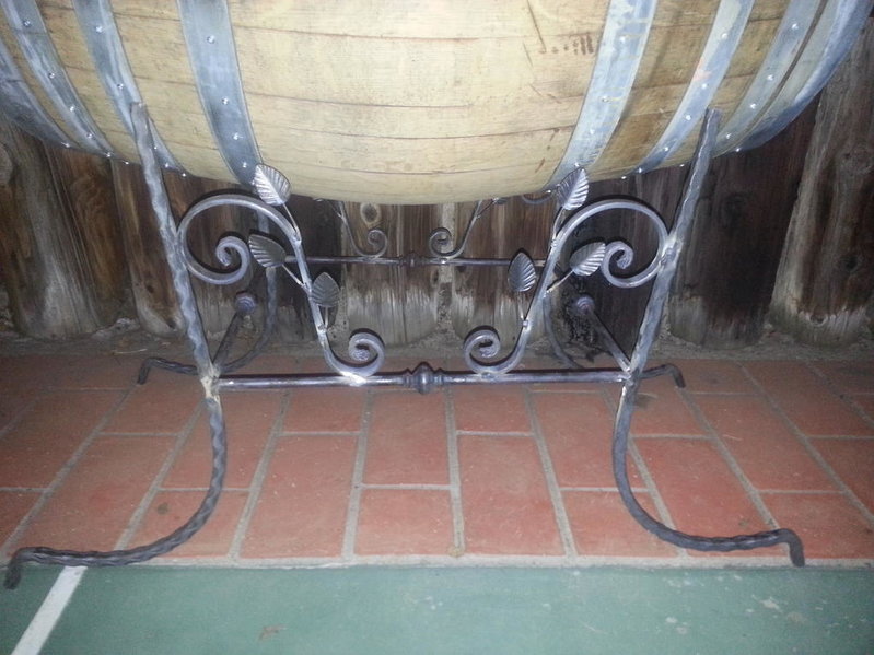

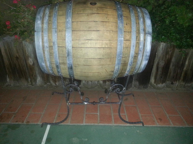

    My stepson welded together a stand for my wine barrel cooler.

    sweet :bowdown:

    Really nice
