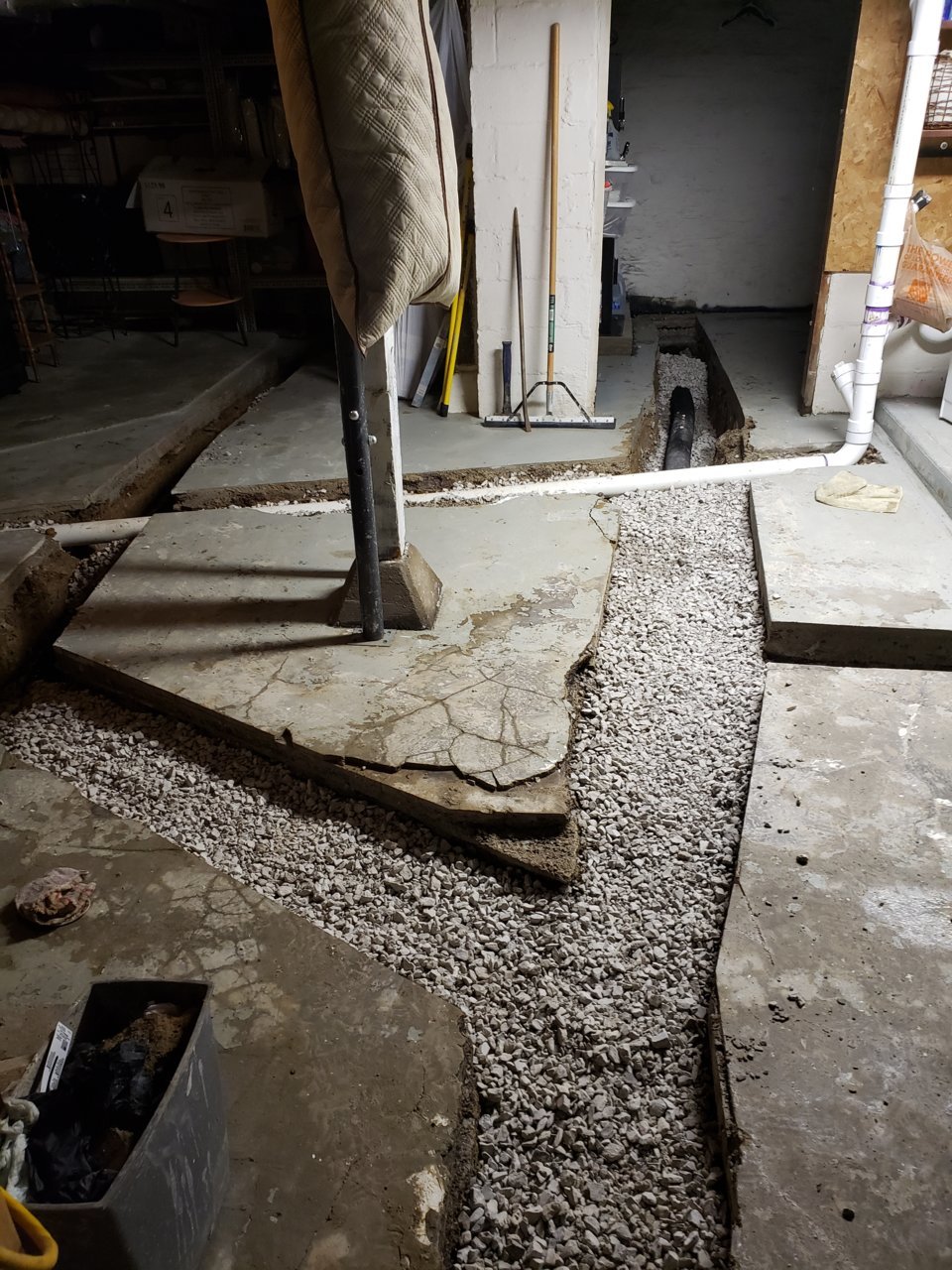

    Spent my entire weekend installing a french drain and repairing our rusted through sewer line that we found in the process. Approximately 60 cubic feet of dirt carried up the stairs and outside. 2 tons of gravel down through a make shift chute. Still need more and then concrete to follow.
    95 taco, robssol, Hawco636 and 2 others like this.

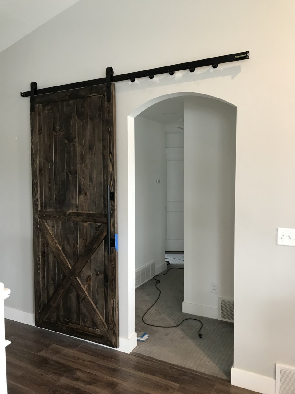

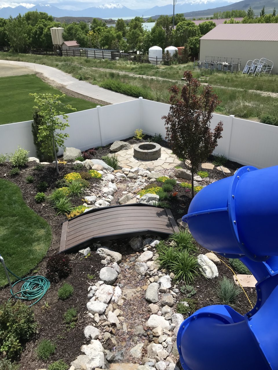

    Recent projects around my place included a big @$$ barn door from the living room to the hallway, and we finally put in block fire pit in our flagstone sitting area.

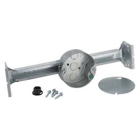

    So, I have this style of recessed light in the guest bathroom. I'd like to convert this to more of a traditional style with a glass bowl for the increased light output. How does one go about switching over to another style?

    Turn off power, verify with non contact tester
    Figure out what it’s attached to and unhook wiring and remove whole fixture
    Put a block between rafters to which you’ll mount a metal light box or use one of the light boxes that have built in bridging/ blocking
    116CDBBF-9ACF-4D2C-91F4-9A28BB112277.jpg Run wires into box with a romex connector and hang new light from box. Read up on making electrical connections.
    Hopefully you can access from the attic or else you’re gonna be doing sheetrock cutting/repair lol
