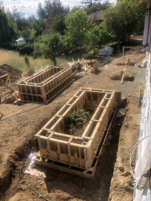

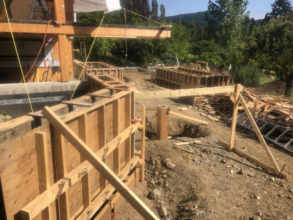

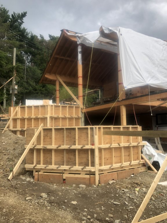

    Little update about where we are on my current build
    All the windows are installed , drywall complete and painters are currently inside priming and painting the walls and ceilings .
    While they're in the house we've been outside working on some concrete features
    We've formed 2 retaining walls on the covered deck end of the house , the upper one allows you to walk off the deck to the side , the lower will become a planter
    Out front we're casting the concrete columns that our deck posts will sit on . 8x8 concrete columns with 6x6 fir posts will carry the deck framing .
    The deck wraps around the front of the house extending about 55' almost to the other end of the house .
    You can see where we have one built up beam cantilevering out from the section of deck we've already framed . That will have a post directly under it and forms one corner of the deck
    We formed a planter that is the same length as the common spacing of the columns , so a fir post sits on the corners closest to the house and the clients added a feature pond that is a common dimension to the planter .
    The top of the pond and planter will be approx 18" above finished patio grade so you can sit on them and pond will be EPDM lined with approx 3' of depth inside

    As always, very impressive work. I can't help but think about the cost of all that wood to build the concrete forms. It all looked like new lumber, is that something that gets re used or just scraped after the concrete cures? I have seem a lot of concrete jobs with lumber that has obviously be re used many times over but that has all been foundation forms nothing this intricate

    The lumber gets re-used

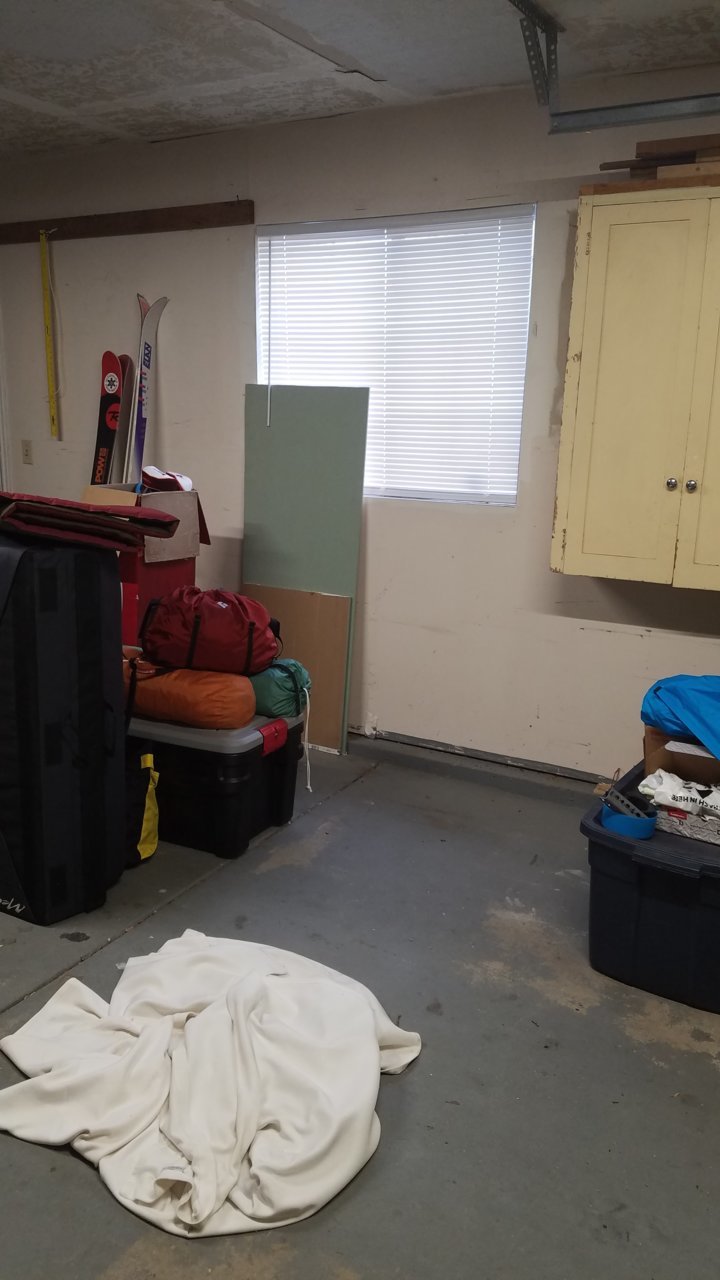

    So we just moved into our new house and we've got a window that needs a temporary cover. I was trying to get some paper to stay stuck to the window. Then I saw your post, and I have a crappy bedsheet that will do the job perfectly.
    Now if I could get my wife to settle on some curtains I wouldn't need the sheet. :rolleyes:

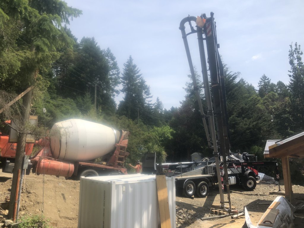

    Poured our concrete today .
    17 yards of 25 MPA / 10 mm over the house with a 40 metre boom pump

    What are the boxes for? Structural? It seems like an odd placement.
    Edit: I scrolled up and saw your other post.

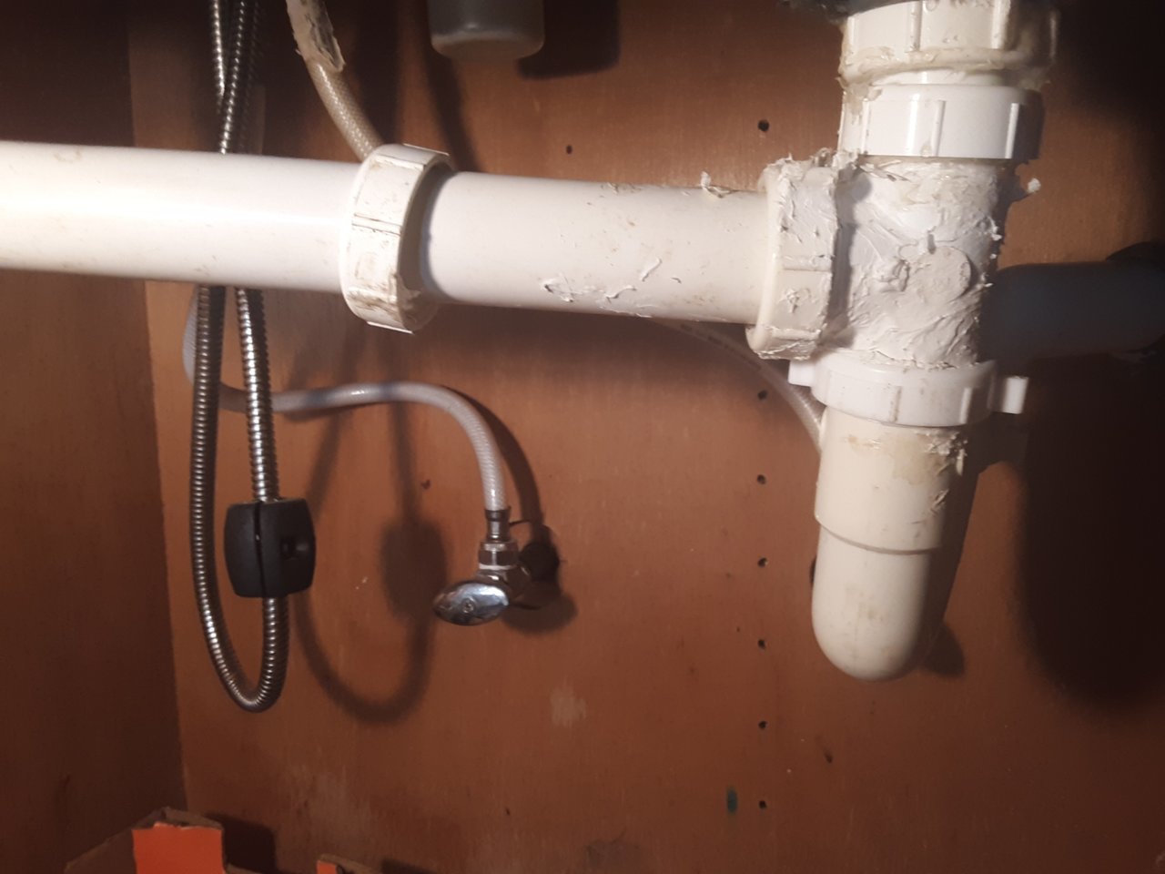

    I didnt get to take a pic in its initial stage but long story short, helped out an elderly couple (late 70-80's). The man tried to fix a clogged sink and leak. His fix was to put rtv and caulk on the outside ofthe joints. The exit to the P-trap going into the galvanized pipe was leaking severely (no seal). We had just been over there a couple days ago, asked if they needed help and they said no. So today after church I asked if they got it fixed yet, his wife says no. I said let me come over and try to fix it, since they had family/company over. I ended up putting 2 seals in and tightened the joints. Still was clogged but quit leaking and all they had was a plunger and I plunged it a couple times and cleared the clog. :bananadance: I hope I dont do crazy stuff like this when I get old. He wanted to pay me but I really wasnt looking to get paid, just wanted to help...

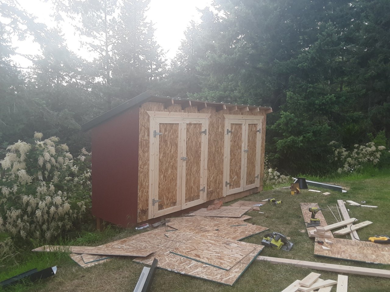

    Not really my best work but extended our wood shed, Needs some tin trimmed and paint. Disregard the mess ;) Looks good enough for a wood shed.:D

    I still have to trim some tin pieces on the corners but looks decent. I picked a different color and it was WAAAAAAAAAAAAY (they hand tinted the dye) too much red so my wife had to got to lowes or homedepot and get something to cover it. I dont plan on accenting the trim as of now.
