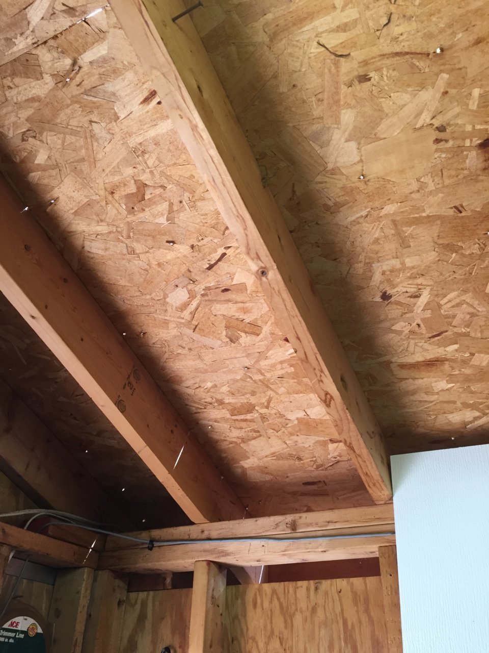

    Inside looks good except far right corner.

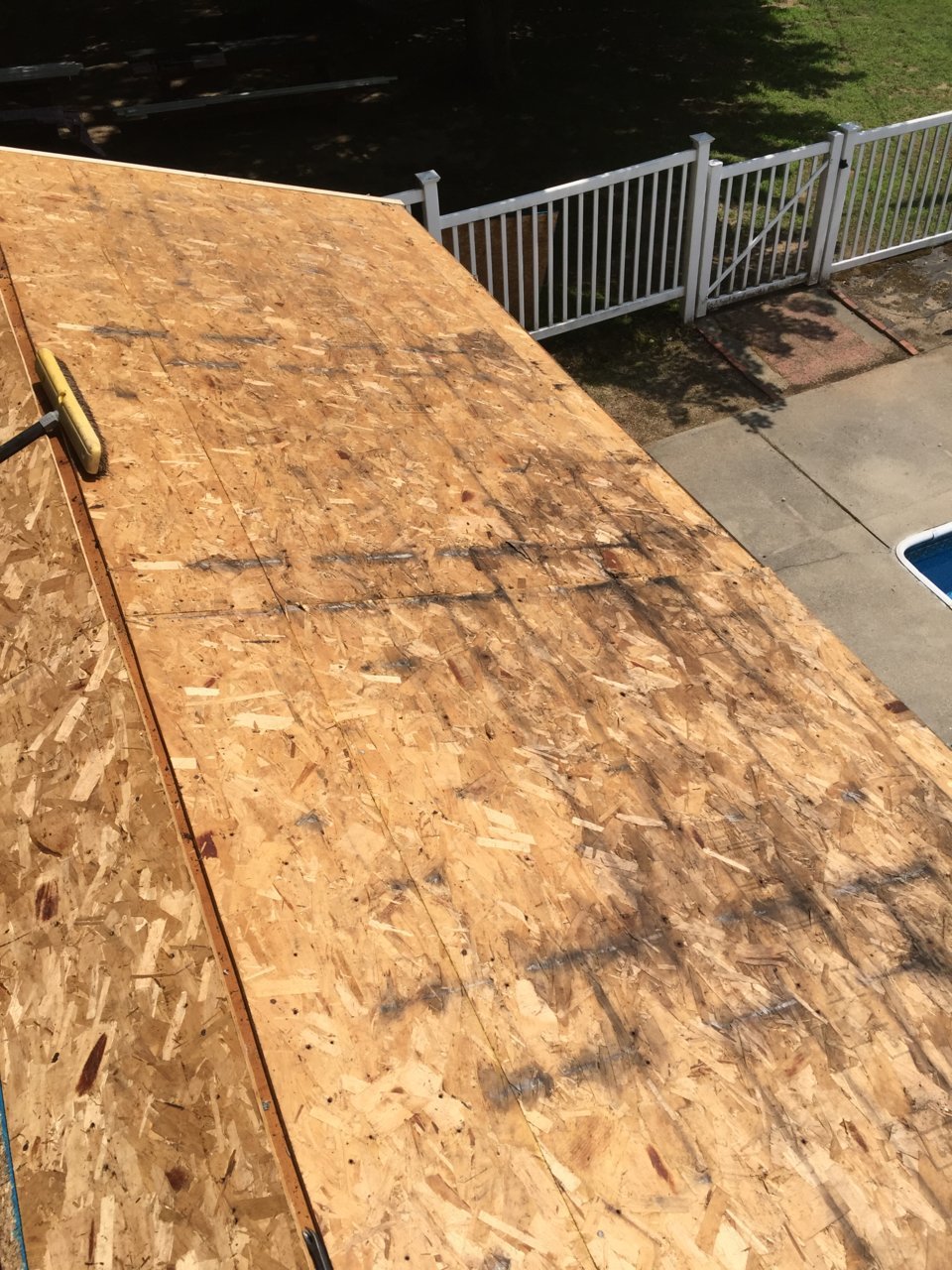

    Inside looks good but the top not so much. Ian has some soft spots on top and swelling. Most of the nails on the bottom section pulled out to easy. Going to replace the bottom sections. Both sides are full 4x8 sheets.

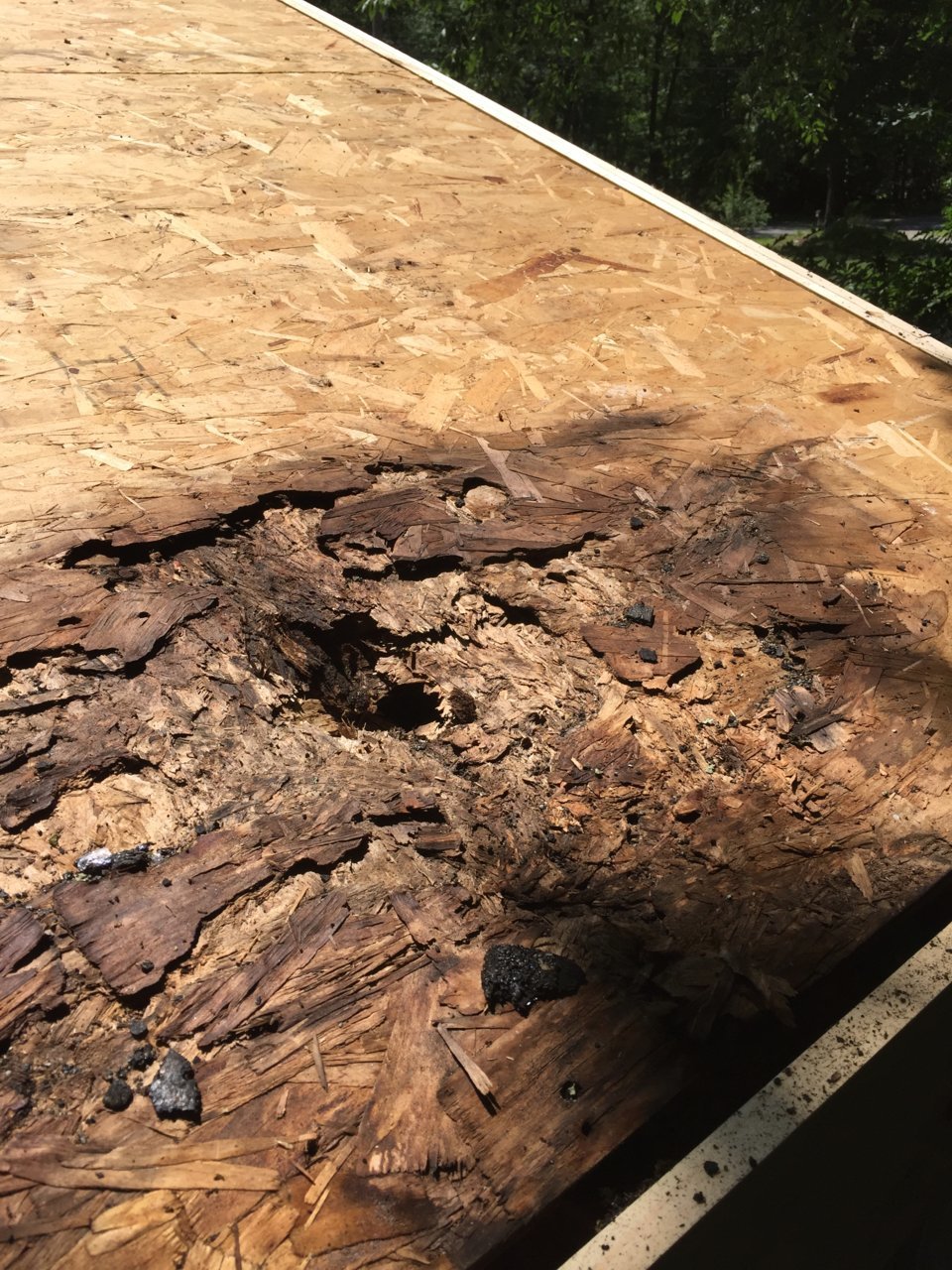

    This was the back corner I could see was bad from the inside.
