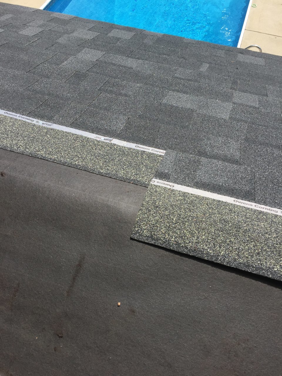

    Before I ask let me say hats off to all you roofers! What a pain. Ok now when I get to my last row at the top do I fold it over to the other side? Then do the same when I come up on that side and roof cap or woul you cut it even with the other side then cap it?

    Fold over, and don’t worry about cutting them off becuz you’re not venting. That is unless the top part (unfinished) of the shingle shows from underneath the ridge. Having an extra layer up there will help build a steeper pitch at the top to fit your ridge over
