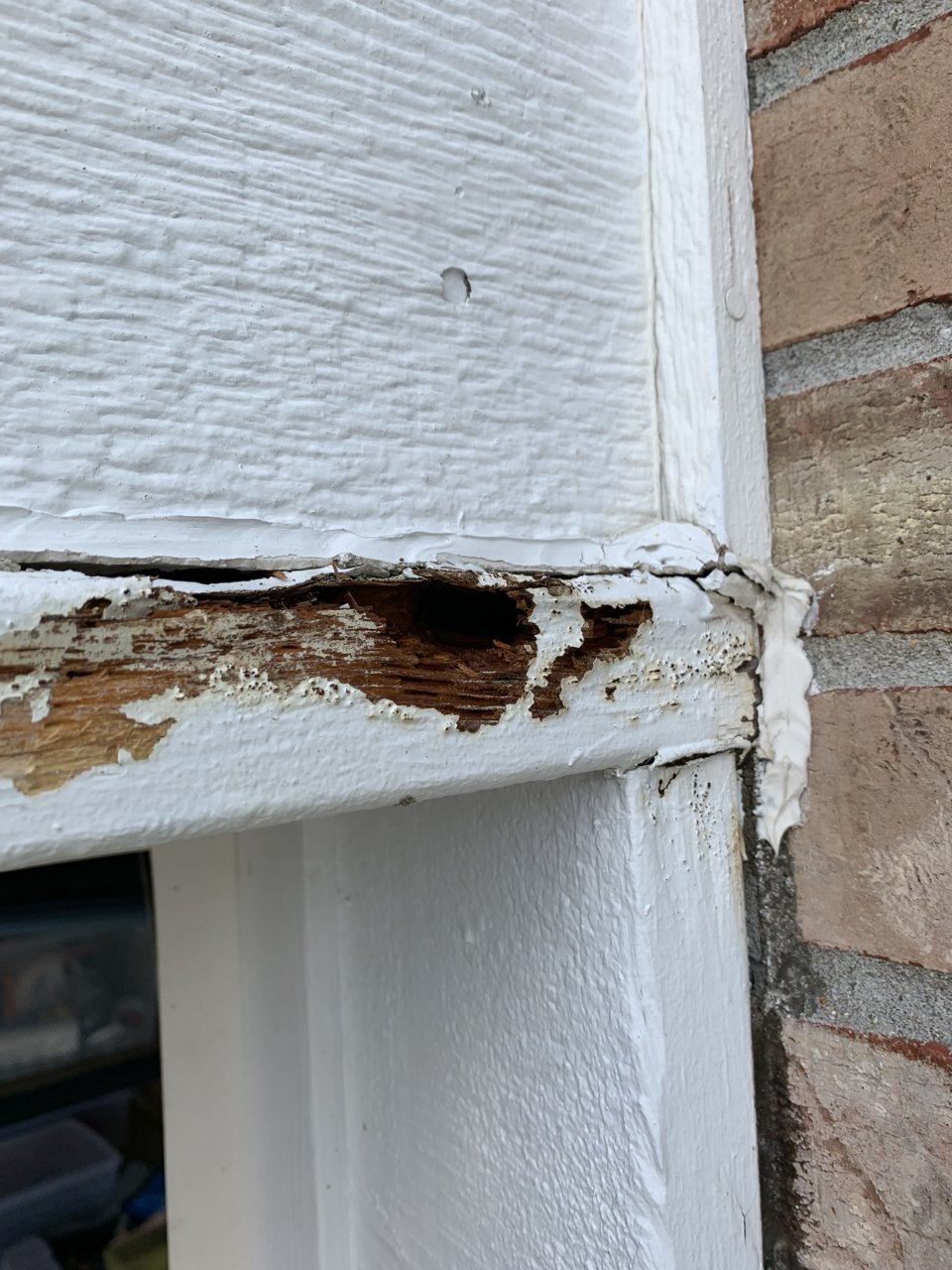

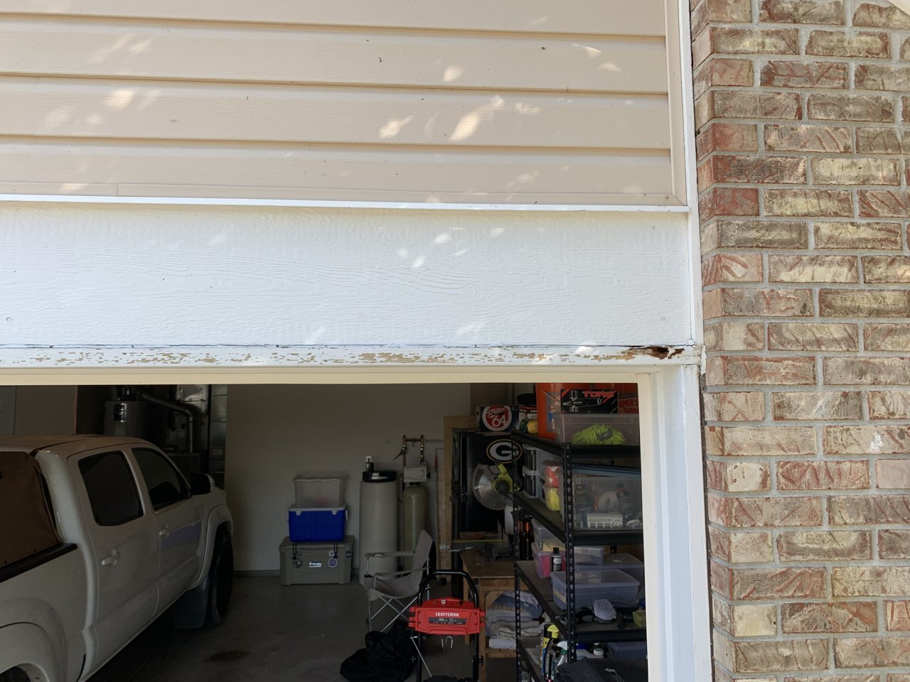

    Me too.
    I’m ignoring the issue for now but I know its a problem. My plan within the next year is to tear out the door and put in a sliding glass door. I will be prepared to deal with the extent of the problem when it comes to redoing the whole door opening.
    If I had to guess water is penetrating into the sides of the outer siding and funneling inward. I need to pull the outside trim off and caulk it yo try to bandaid it for now.

    I bet water running down your channel siding above gets behind that panel over your door

    This is turning into an attractive option.

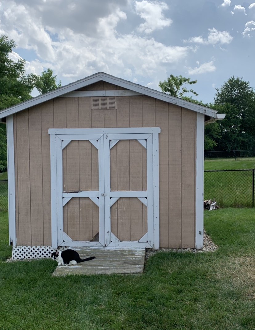

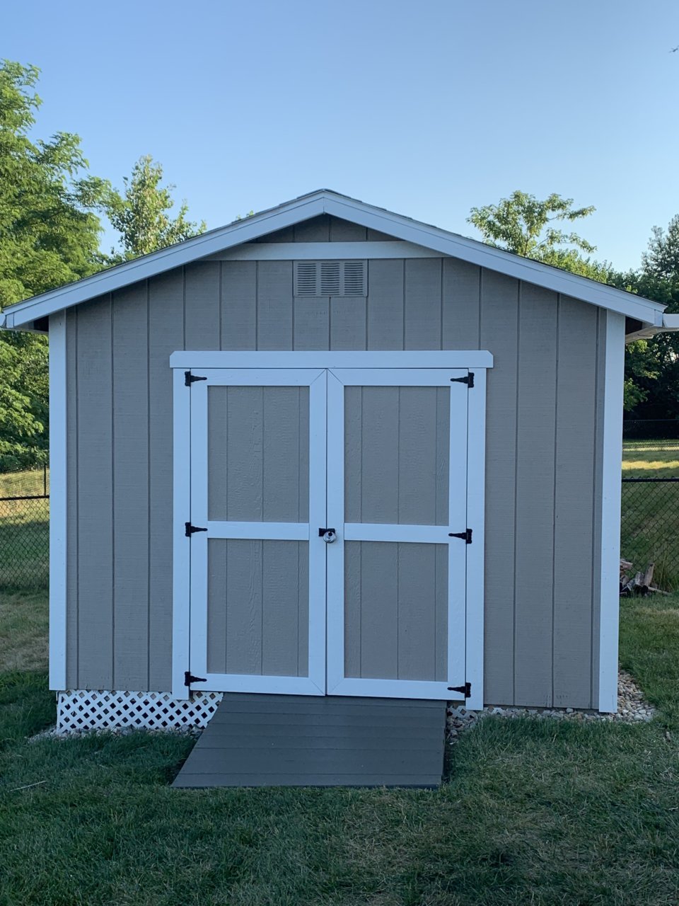

    I just fixed my rotting shed and rebuilt the doors.
    I’m bringing in my ex boss to quote me for a fix on the garage. I’ve had enough home improvement this year lol

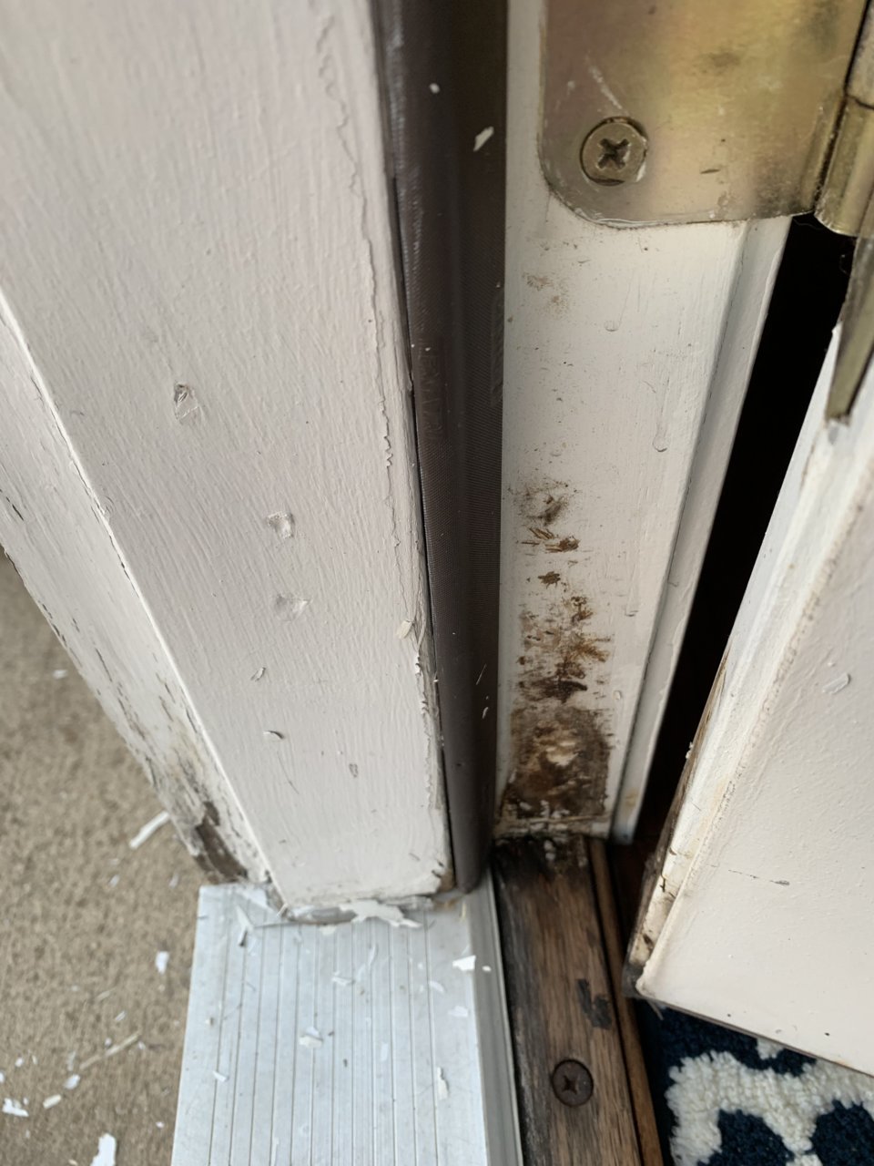

    The same thing happened to 2 of my exterior doors going onto the deck.
    It turns out, the manufacturer did not paint/seal the bottom of the jam, so over the years, they just soaked up water and rotted. :( The ones I put in to replace the originals are PVC for the bottom 6" - I won't have that type of failure again.

    shed looks great!

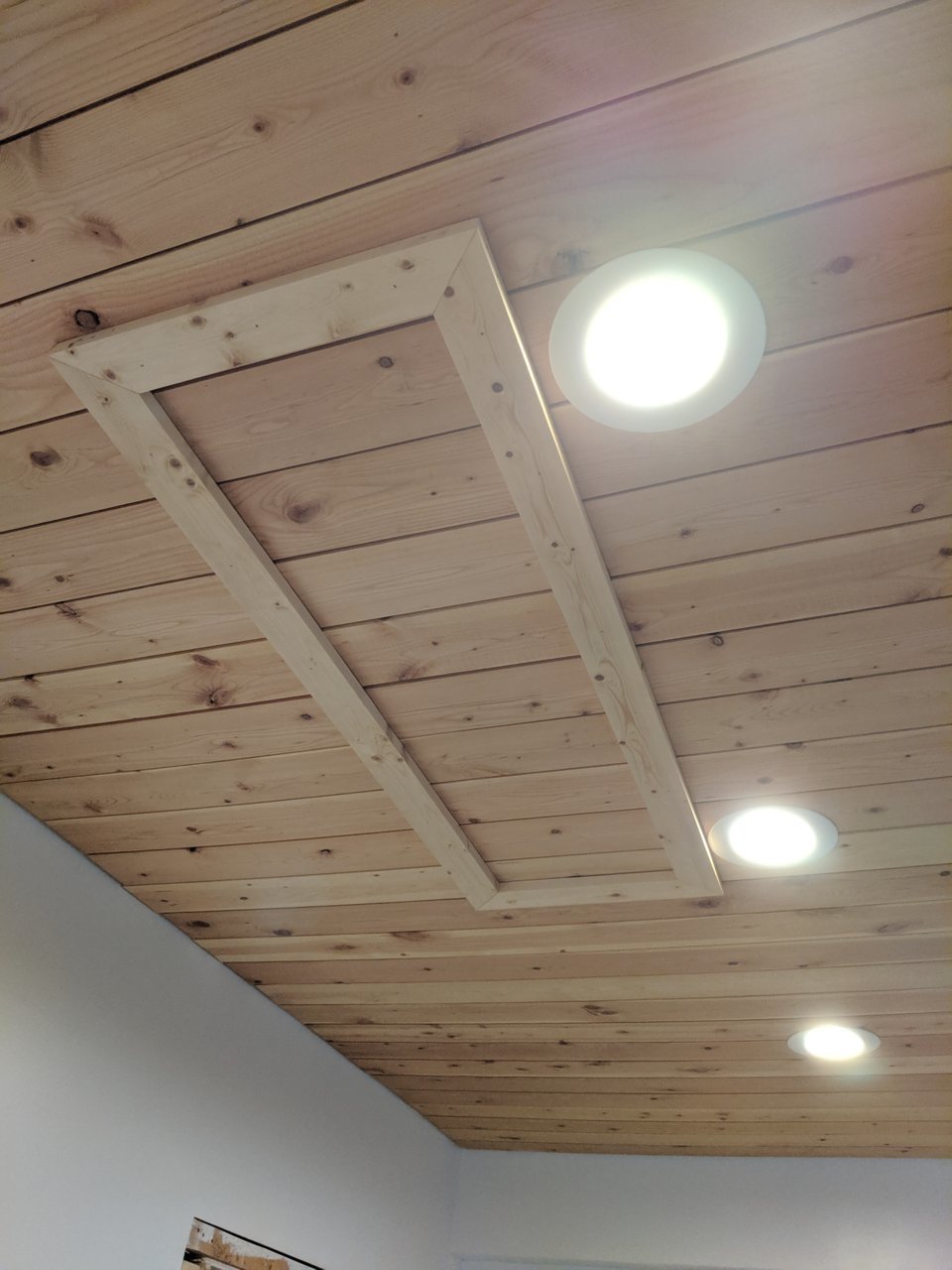

    Finally got the attic access panel in the kitchen finished. Still a bunch of other stuff to get done but it's nice knocking stuff off the list.

    Thanks! :D
    Blood, sweat, and tears went into that.

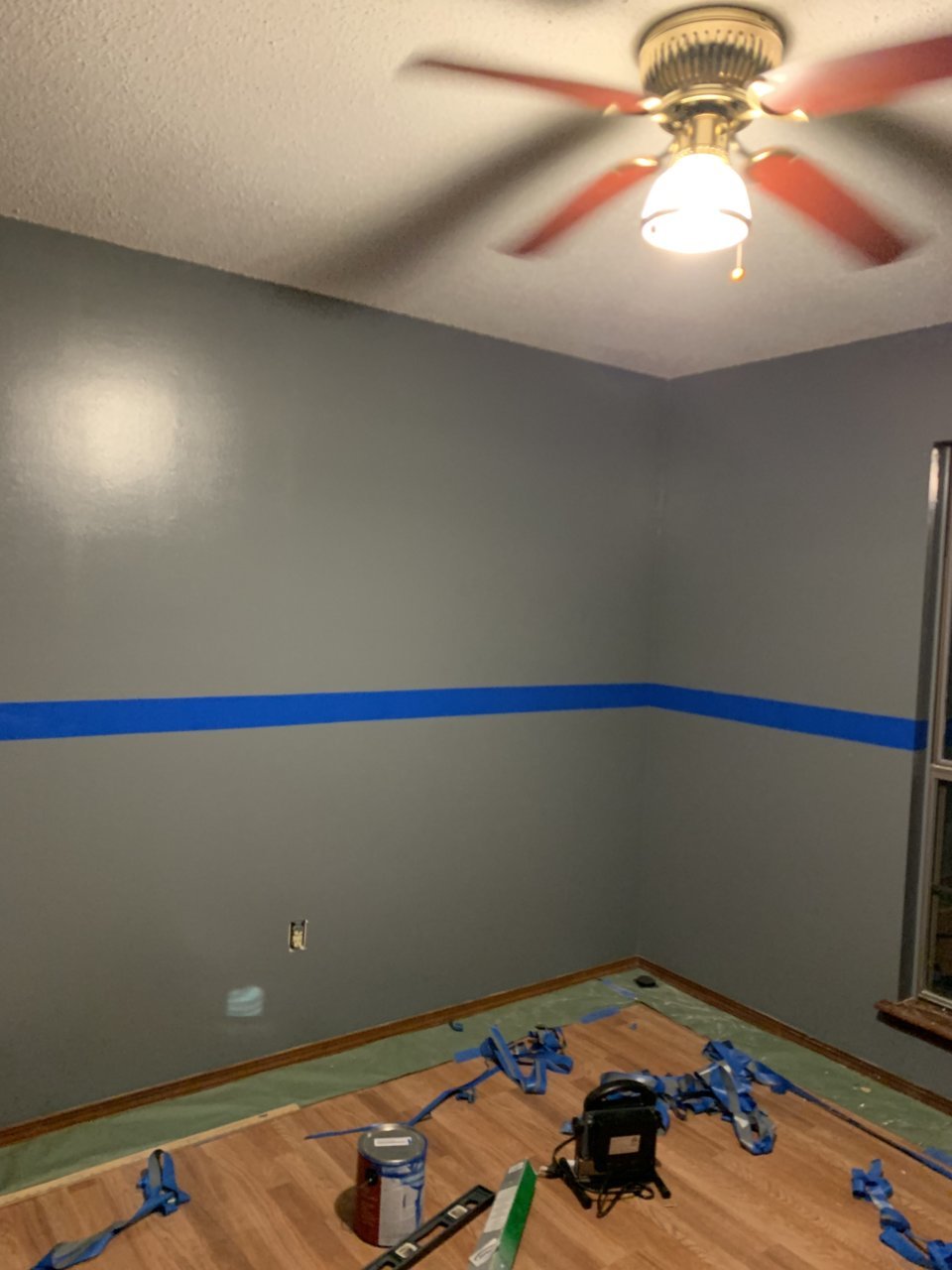

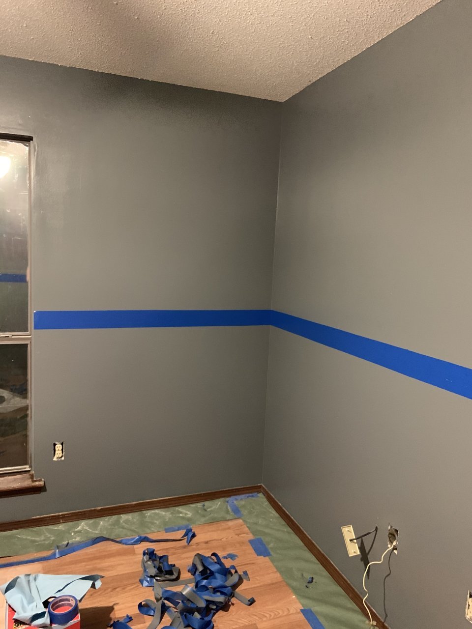

    Most of the painting is done, 3 closets, 1 room, 2 bathrooms to paint, 2 rooms to touch up, 3 fans to install.
    3 closet shelf/rack systems to build, 1 fence to repair (requires concrete work), epoxy the floor of the Florida/dog room, install doggy door, replace entry door between Florida room and kitchen, fill planter area with concrete, scrape up linoleum in the laundry room and epoxy that floor, install AC register in laundry room....
    The list keeps getting longer the more we do.

    Is that tape or a fresh painted thin blue line on your wall?

    Fresh blue line
