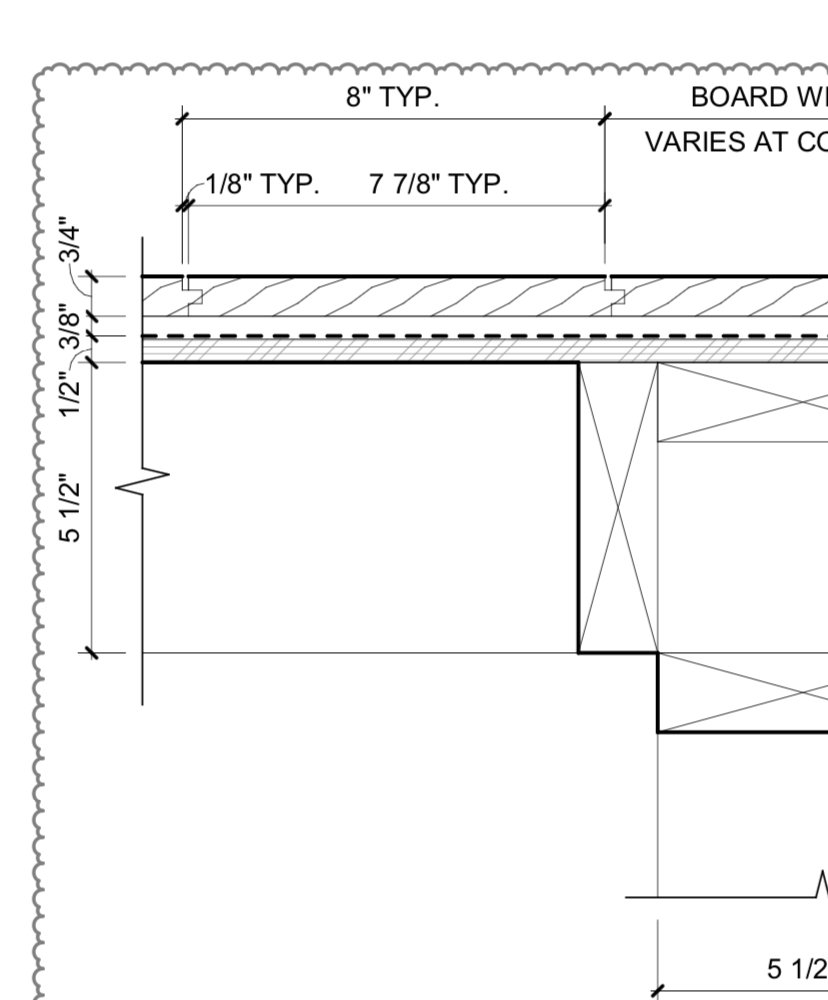

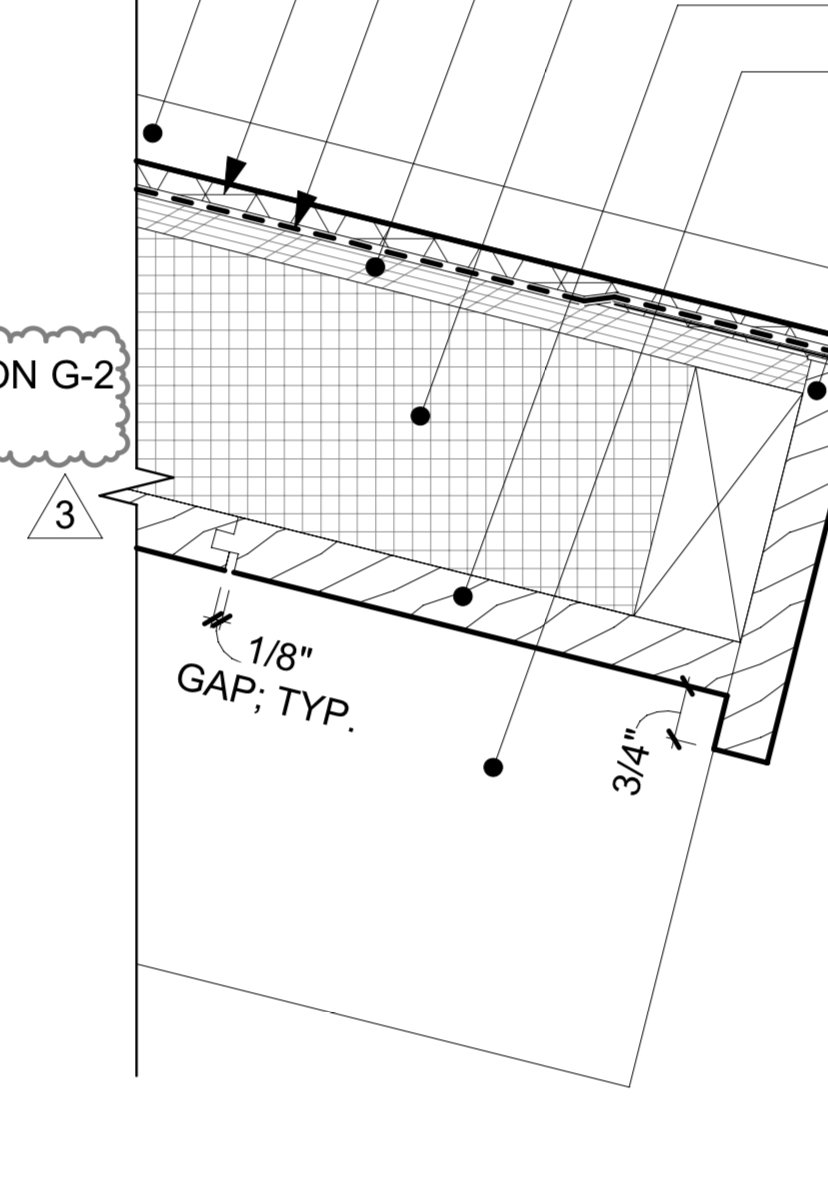

    It was intended to have a “nickel” gap of an 1/8”. I guess I didn’t describe it well.
    15FD043A-8149-4064-8008-34974FB67C78.jpg E72BDB95-1E6E-4B4F-BA75-CCD8FB82DB6F.jpg
    Having installed vertical 1x6 T&G v-groove Tight knot cedar on all four sides of a house before and had no issues, I’m surprised by the shrinkage. This is KD VG Clear Western Red Cedar. It is getting full exposure though, zero shade, and is facing perfectly east. It has stopped shrinking, but is close to failure IMO.

    The mill work was done to spec.

    Wonder what the moisture content was at install

    Wish I would’ve checked. I had it on site for 2 months before the install. It’s was kept dry, but outside. It was a wet beginning to the summer though. It dimensioned correctly at install, 7 7/8” reveal with 1/8” gap, 8” overall. This is a 20’ wall, the other 100’ of walls are fine. We are considering switching to a lap siding with a 1/2” rabbit creating a 3/8” overlap with an 1/8” “gap” for the barn. This will give us an extra 1/8” of forgiveness, but increase the potential for cupping at the lap. The barn will have a 60’ wall with eastern exposure. All the structures are oriented to maximize the effectiveness of the solar panels, so one wall will always face true east.

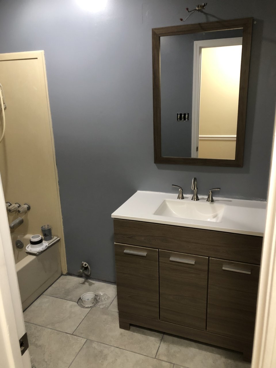

    Still waiting on the grout to dry before we seal it but I like how it turned out.

    Nice job but don’t let toilet flange be too low or you’ll need a spacer or extra thick wax or new style rubber wax ring

    The flange is about 1/16” above flush when it’s on the slab, we can shim it up slightly if we need to and our “better than wax” seal kits have a spacer in them as well.
    My cousin is a master plumber out of state and said he thinks it will be fine but to pay attention when we put the toilet on and we can shim the flange if needed because it’s a Twist N Set flange.

    Hard to tell in pic and I’m a plumber also:D

    I thought I had a better photo of the flange but I guess not.

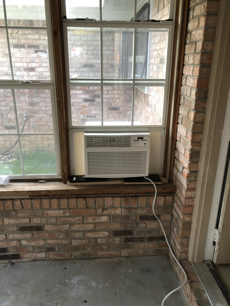

    Yesterday: installed window AC unit for the doggy porch, way oversized but is extremely effective for the almost all windows design of the porch.

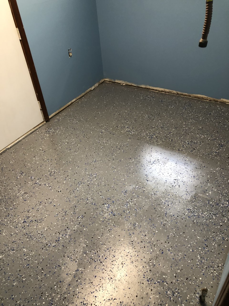

    Today: painted the doggy porch and laundry room floors with Rust-Oleum garage epoxy.

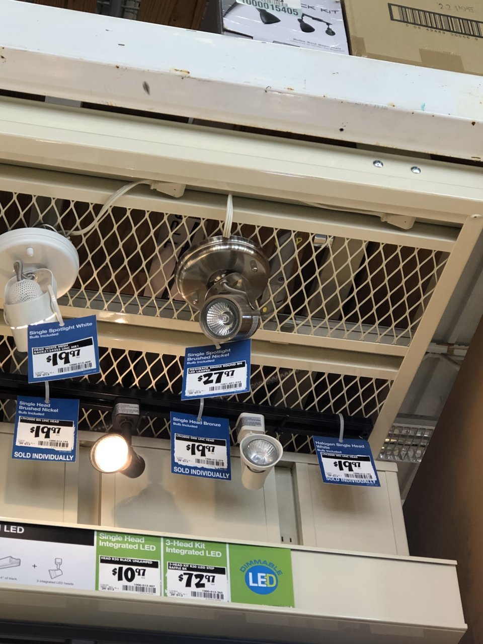

    Also, on an outing to the Home Depot today we found these lights that we will be picking up in the near future to illuminate our artwork. (Silver, ceiling mounted)

    Whatever you do dont get the white or siliver/chrome ones as the pin sockets for the MR16 lamp burn out both LED and Halogen....Spend the few extra bucks and get a good light fixture.
