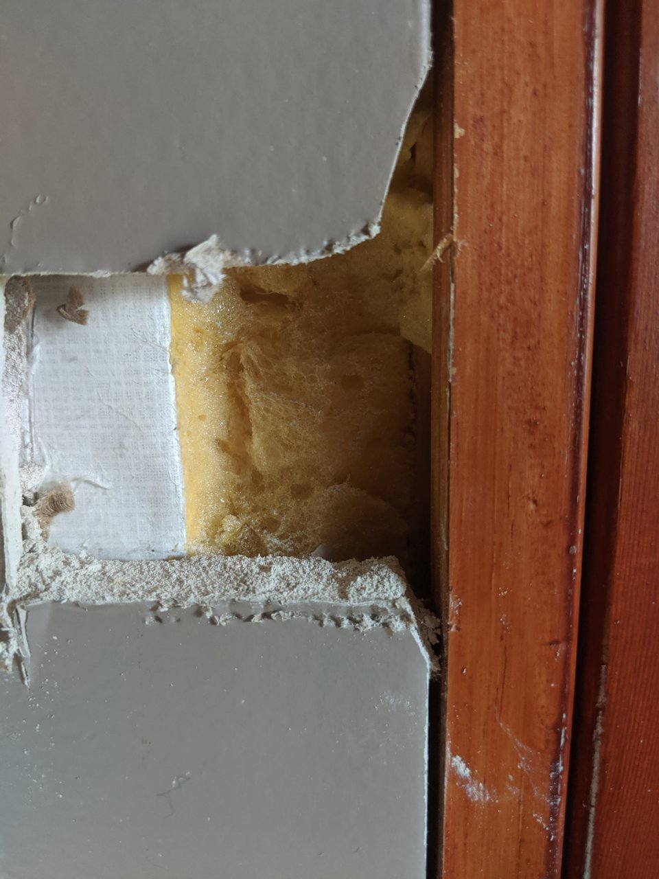

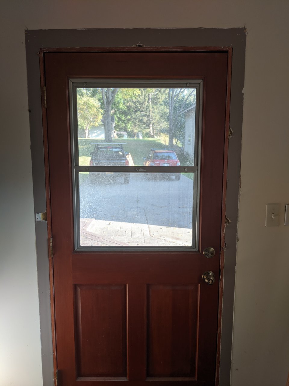

    So I'm looking for a little advice on replacing our rear entry door, which is what we primarily use. It's old, ugly, poorly installed and drafty.

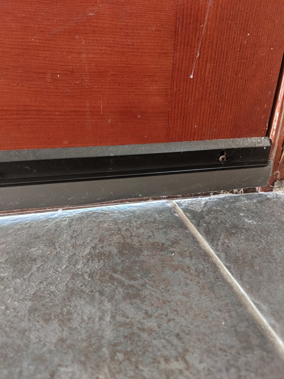

    The main issue is the sill is below the finish floor, so they cut the door to clear it but there is obviously a huge gap. I put a sweep on as a stop gap but it's falling apart and I want to get it squared away before winter. Here's some pics. IMG_20190921_170710.jpg Outside looking at sill
    IMG_20190921_170735.jpg Inside looking at bottom
    1 3/8" gap between framing and casing
    Top of casing tight to header
    Full interior showing drywall cut tight to casing.
    It appears to be a a standard 36"x80" door that they put in a 40"x 80.5" (from F.F. to header) rough opening. I could cut down a prehung solid wood door but they are expensive, as are custom size doors.
    My general idea is:
    Buy a 36"x80" prehung fiberglass door
    Build up the sill framing to the correct height for the current floor
    Fir out the studs to the correct 38" RO width
    Notch/reframe header depending on what it is
    Either custom cut the brick moulding to match current vinyl trim/siding or rework the vinyl itself.
    Thoughts/comments/concerns?

    Switch it to an outswing door
    Slashaar, wilcam47, 23Skidoo and 2 others like this.

    It's funny because I had almost written that off as too obvious of a solution.
    It would certainly work, the main concern I have with that style of door is snow drifting and being unable to open. But it is a covered area and there are alternative doors to get out if that happens.

    https://www.finehomebuilding.com/2013/05/06/z-articulating-cap-sill
    or this, they also have seals that you can put in on the bottom of the door, depends how big the gap is.

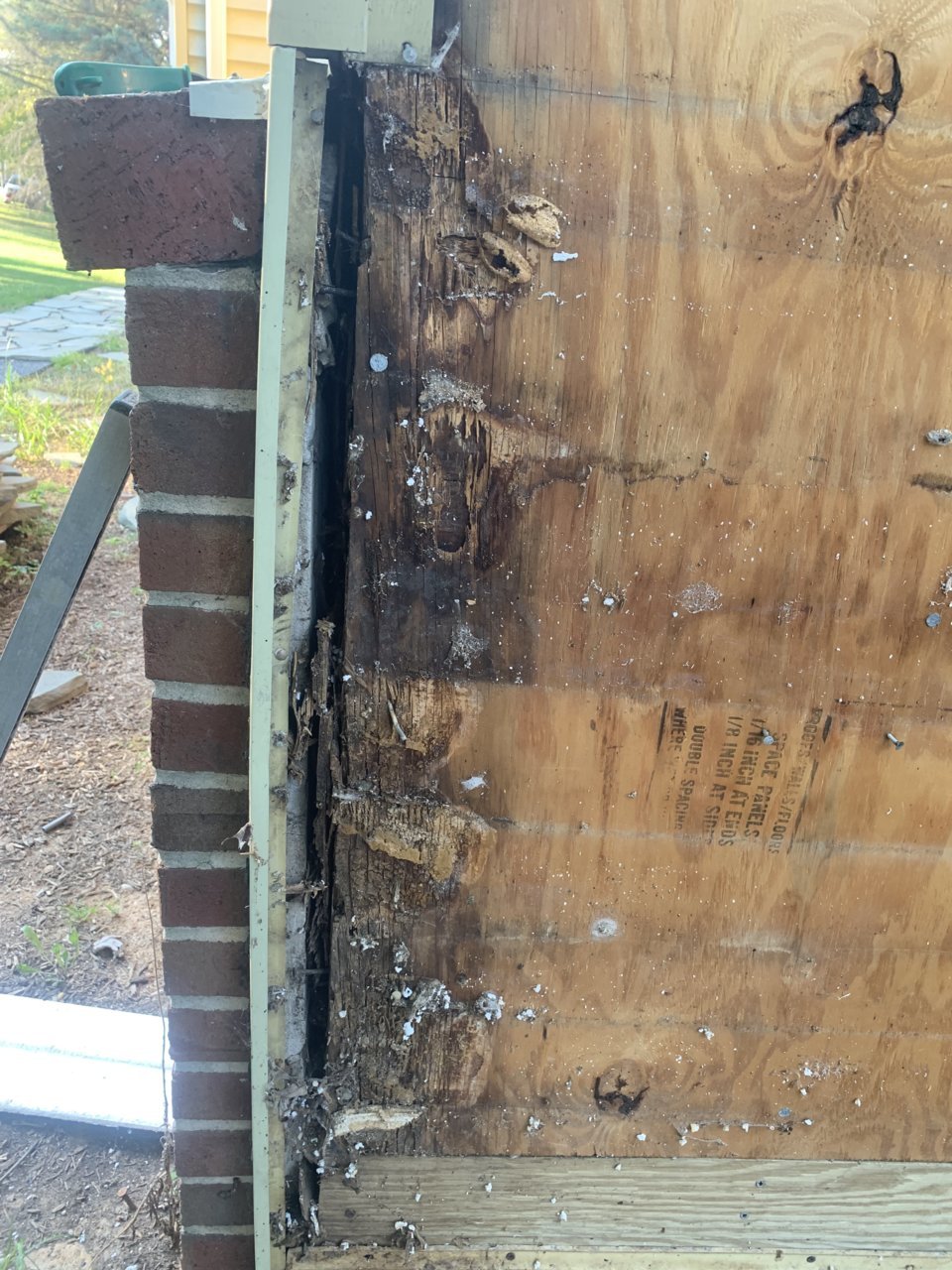

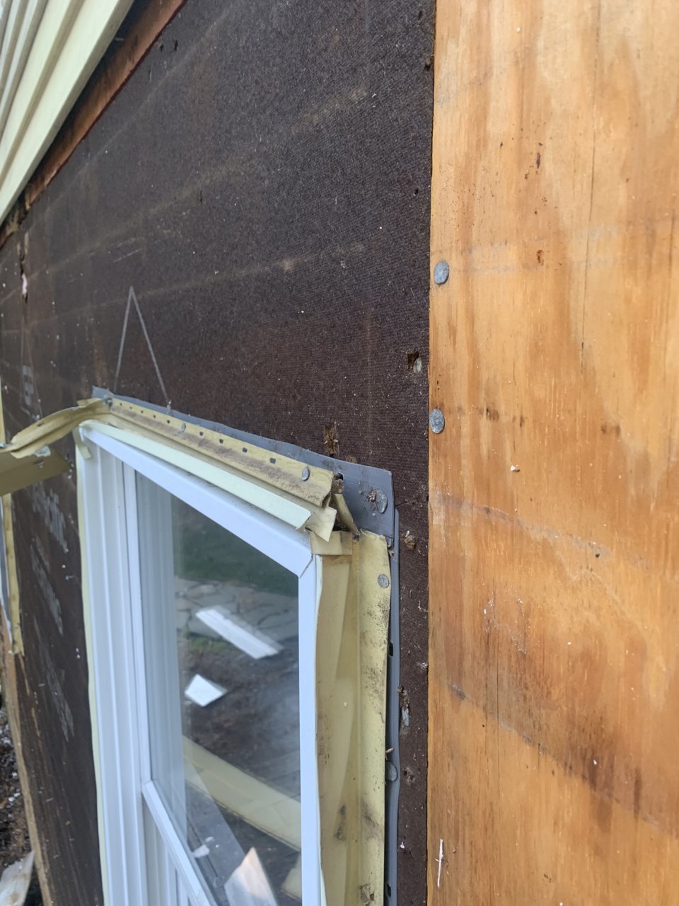

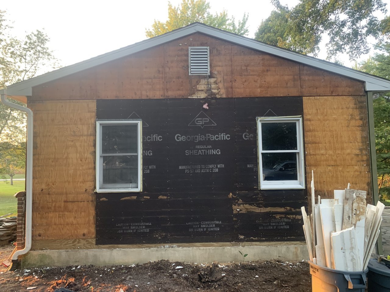

    Starting the residing and new window project on the house. I knew I was in for some work, but holy hell this is shitty. Windows have no caulk around the flanges, or flashing of any kind. No tyvek or tar paper at least. The brick wainscoting wasn’t flashed and is has about a inch gap between the house. Any recommendation on fixing it? Figured I’d have to dump some mortar down in the crack or use expanding foam on it and properly flash it. Gunna be a busy week.

    I don’t think I’d foam behind the brick lol it might wind up on the ground after the foam expands plus some air moving around in there might help keep everything dried out
    I’d leave it an open cavity and make sure there are some weep holes at the bottom then flash it in at the top with a combination of metal, housewrap, some kind of peel stick membrane, siding and some silicone

    I'd check the studs down low behind the bricks and sheathing(from inside) for dry rot. That corner doesn't look good but I've seen worse. Need some flashing on top. If wind is hard on that side I'd cut a kirf in the brick and caulk a 3/8" drop lip in the flashing, it's difficult to get a good lasting seal on such a short overlap. Overlap the flashing starting at the prevailing downwind end with upwind pieces in succession.

    This part of the house is a converted carport from the previous owner. We gutted the inside when we bought it 3 years ago and the studs and sheathing were ok from what I remember. New drywall shows no sign of water damage from the windows or the from the brick. Thanks for the tip.

    how attached are you to the brick? Personally based on how shitty everything else was done I'd just tear it down and side to the ground to ensure the house is properly sealed.

    There is supposed to be a gap , your bigger problem is the rotting plywood sheeting

    Been busy the past two days. Wound up replacing what I could of the plywood, mortared and metal flashed that rotting section. Turns out the siding supplier sent me all 3/4” j channel and no 1/2”. Need the smaller stuff for the board and Batton that’s going on the front of the house. Nice unexpected 2 hour trip to exchange 20 pieces tomorrow. :annoyed:
