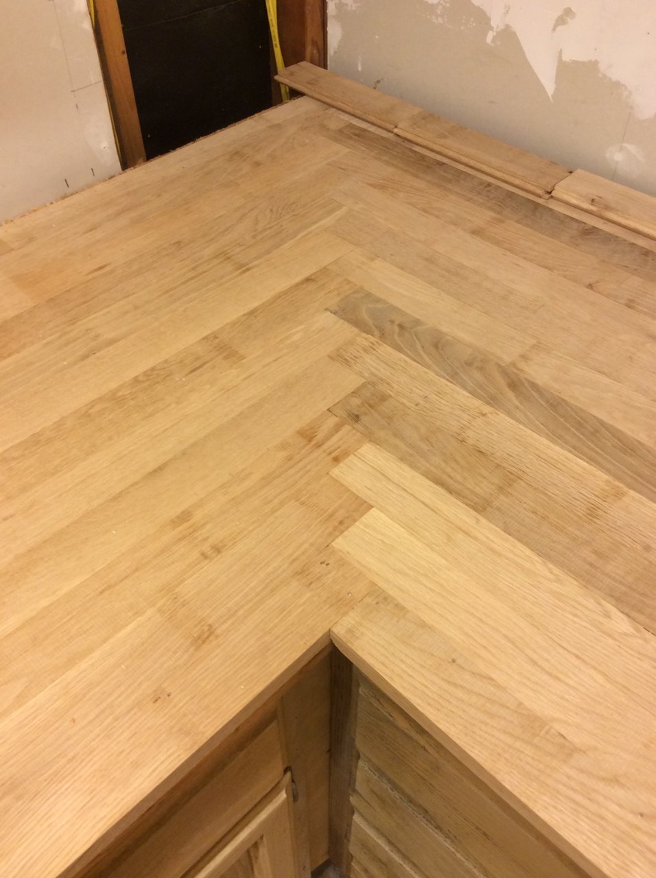

    i like the herringbone corner

    Different strokes. My first thought after damn that's a great idea was I would have mitered the corner. lol

    herringbone is way more stable

    Stable in what way? Your shooting the tongue into the sub-top. I don't see one being more stable then the other. I'd biscuit join them on the miter but I just like overkill. lol

    the boards don't expand and contract in length like they do across the grain so the butt joint will remain tight in a herringbone where a mitre is more prone to opening up

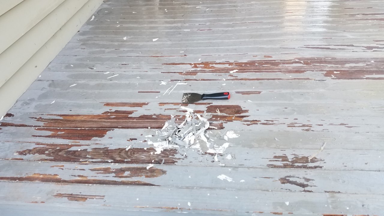

    Yeah I have figured that out the hard way on the front porch. Stripper won't touch it. We wanted a stained front porch...painted it is!

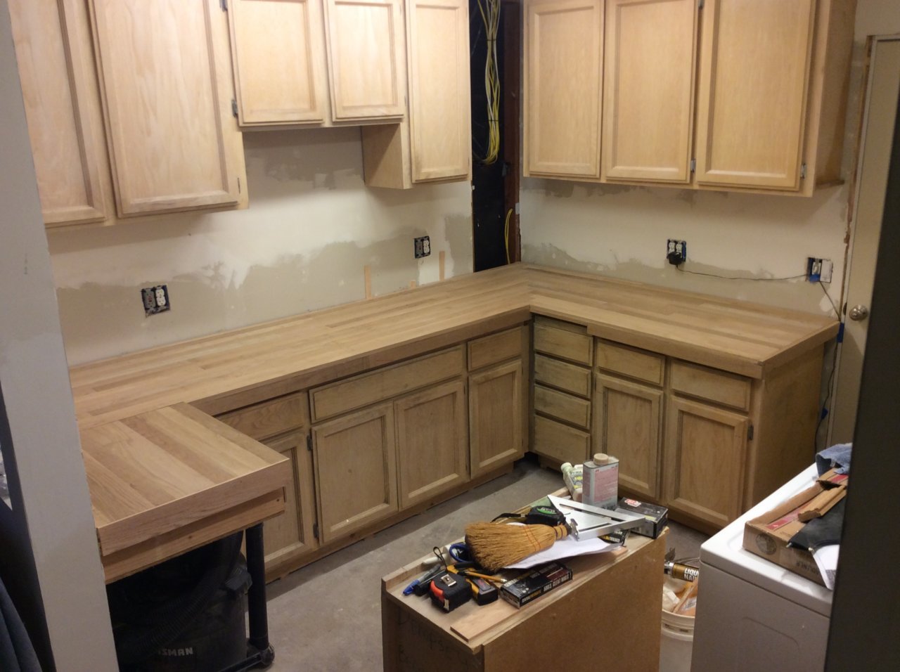

    It's a combo laundry/work room, open to the single car garage. I had some leftover boards from the kitchen/living room install so I figured "why not?". I had to buy some additional boards but it wasn't much.

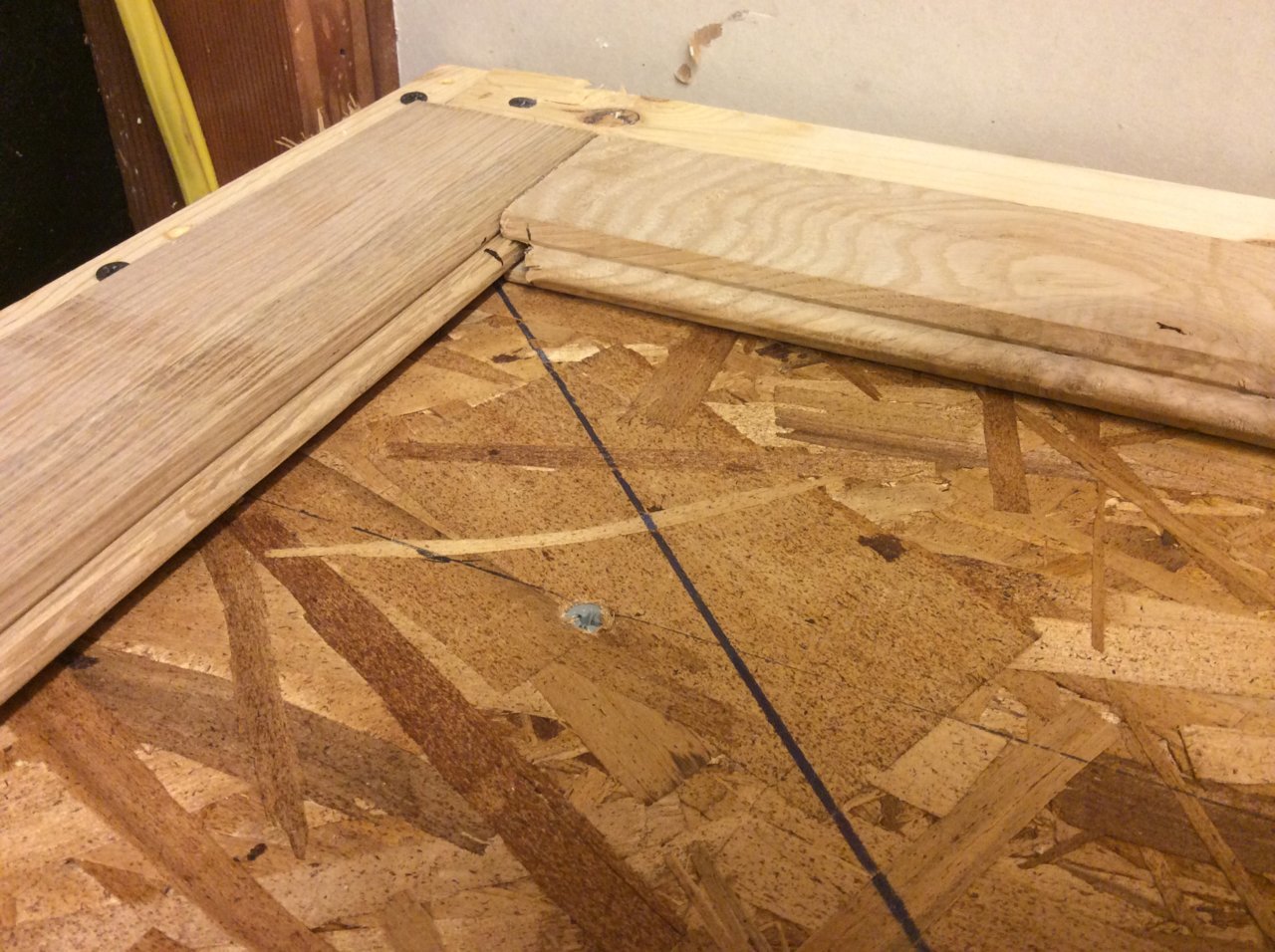

    Thanks. It was a bit of work to cut grooves in the end of the boards to accept the tongue of the other board but once I got the saw set correcty it went quick. It's been a few years and it hasn't moved a hair - still tight joints. Unfortunately other projects took precedent so I have yet to sand and finish the top. Not sure what I'm going to use...
    A few other pics for those who might be interested:
    The groove I cut in the end of the boards.

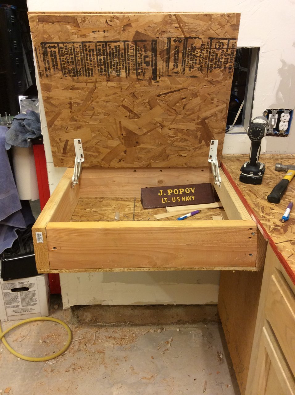

    This is some storage under a hinged lid. If I were to do this over I wouldn't have done this. The weight is substantial and the chance of crushing fingers is high. Anyway, I bought the house from the son of the original owners (his Mom had just passed). They were the only ones to ever live there. I found this name plate - he was a Lieutenant in the Navy back in the day. I put it in the wall with some other things as a time capsule.
    I made a space for a beer fridge and put an outlet in there. Sadly, it's filled with things other than a refer and beer at the moment.

    herringbone is my preferred method to turn corners with flat soffits , to cut the ends I use a laminate trimmer with a slot cutting bit and a speed square clamped to board as a fence
