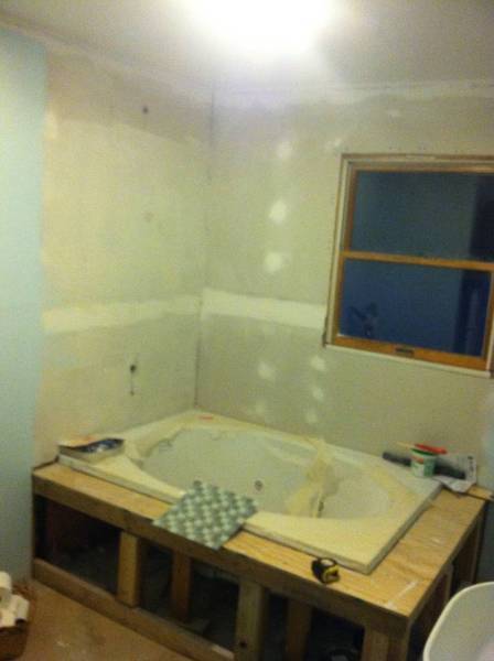

    Need some input here. Remodeling second floor bathroom of newly purchased house. Ripped the POS down to studs, replaced the entire subfloor with 3/4" T&G, placed 1/4" hardibacker for tiles, leveled with Henry 549 self leveling cement, and now putting up the new ceiling and walls. Everything came together fine but now I am questioning what to do for around the tub. We are going to tile so I have 1/2" hardibacker and a 4-mil plastic vapor barrier to staple to the studs.
    I am only planning to tile the top of the window (most likely just under it to match the downstairs). Does the hardibacker go all the way to the ceiling, or do I stop it where I am planning on ending the tile then use the mold resistant drywall to finish it off? The only reason I ask is because I could see issues with getting a smooth wall if I don't tile all the way to the ceiling, but use the hardibacker all over. I would have to skim coat it which I am not the best at and really don't want to see any areas that are not flush/level.
    Also, does the hardibacker sit flush on the tub flange, or do I leave a 1/4" gap and let the thinset fill it in, followed with a bead of caulk to keep it from going anywhere?

    The hardiback should lap over the flange. Then you have an issue with a bend in the hardibacker. Some guys just leave it, which kinda fucks you for tile, some will fur out framing flush with the lip so the hardibacker can lap over the flange and sit nice and flat

    We never go over the flange

    You could use the kerdi paper as well. That's what I'm using. I have almost the same exact bathroom/tub layout and doing all tile as well. I put drywall on and I'm going over it with Kerdi.

    What we do is use dense shield tile backer in the apartment buildings I build.
    Go to this PDF:
    DensShield® Tile Backer Installation Instructions
    its will show you how to install it.
    Basically you run this all the way up once your plumbing is done, set your tub up to it and run your tile to the flange. You can then forget about the hardi board which is a pain in the ass to work with.

    What ever substrate you use , it's isn't supposed to go over the flange
    And use the Schluter System over the substrate and never worry about it again

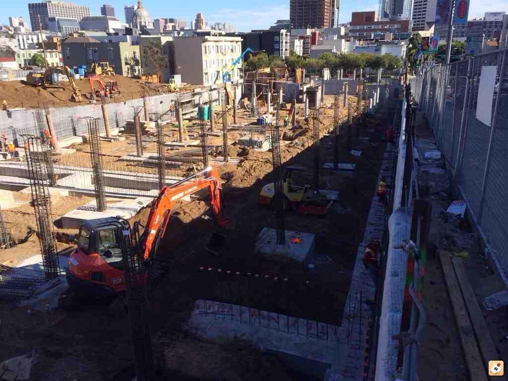

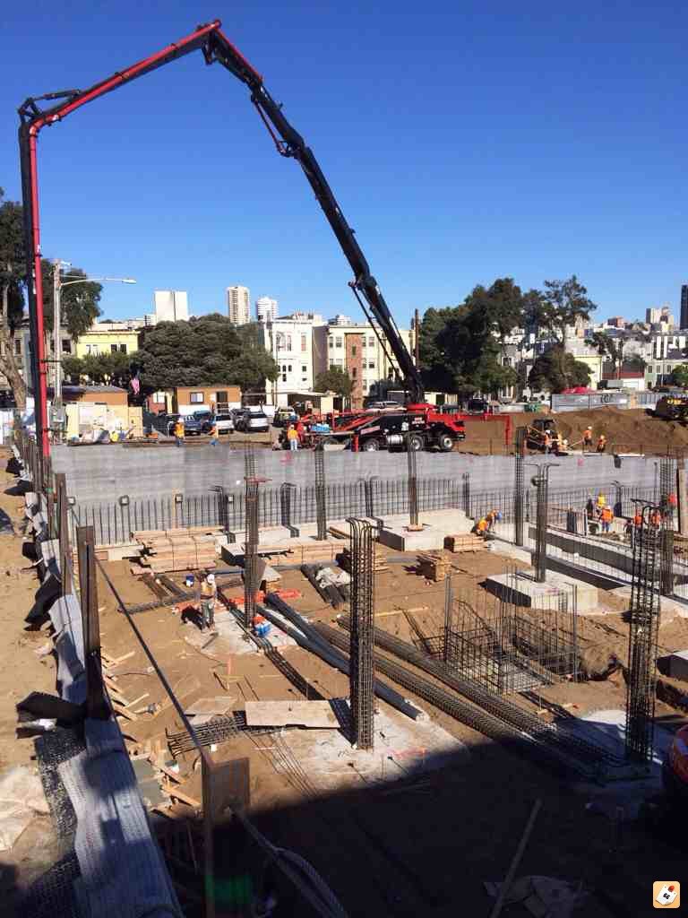

    Couple from my job, 182 unit apartment building in San Francisco. Pouring columns in these. Slab will be poured out in 2 pours. Just started finish grading for it today, should be poured in 2 weeks. 49,000 sqf.
    Can't let OZ steal the show :D

    SECOND COLUMN FROM LEFT THIRD ROW LOOKS CROOKED AND ABOUT TO FALL OVER

    Not plumbed at that point...lmao...de ja vus

    the bottom of the hardibacker should rest atop the flange around the tub, do not overlap the flange... when you install the tile, you have the tile overlap the flange (it can overlap since the hardibacker should stand "proud" of the flange), but leave a 1/8" gap between the tile and tub deck surface (this is where those plastic wedges/spacers help)... then after the tile is installed/grouted/sealed, just run a bead of caulk around the perimeter of the tub where you left that 1/8" gap ;)

    You should run your substrate all the way to the floor IMO, and hold slide the tub to it.

    Sounded like he was saying hold the hardi board at the flange elevation. Which seems to me that he would not have substrate below the flange of the tub:not sure:

    Which is exactly how it should be done , a flanged tub installs against the framing , the tile substrate comes down to the top of the flange
