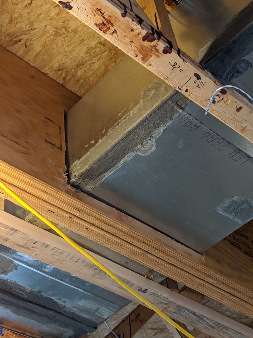

    So what's the load above?
    Helping a buddy remodel a house in NY I got my first look at a load bearing window. I shit you not. There was a large 6'0" x 4'0" window that was on the first floor. It was centered under the roof peak on a gable end. The original home was built in the late 1800's and had about 5 additions as far as I could tell. When you looked at the glass it had this wavy look like old windows sometimes do.
    Anyway, he wanted to remodel his living room so I stripped it down to the studs. When I got to that window it had a single top plate over it with 24 OC framing. There was no header in sight. On the next floor there was a 6x6 that went up to carry the whole roof load. When the second floor addition went on nobody caught it. I'm still impressed that it held for that long. lol

    Sounds a lot like my house lol.
    As far as load above this treasure, best I can tell it's not too terrible. There's a hallway wall directly above, but there's a massive fireplace right next to this so there's gotta be some meat in there.
    It's a lot of structural steel, big LVLs, PSL posts and LSL studs. There is a lot going on to say the least.

    Replacing those LVL's isn't going to be fun , especially if they used subfloor adhesive

    Must be one of those structural ducts. ;)

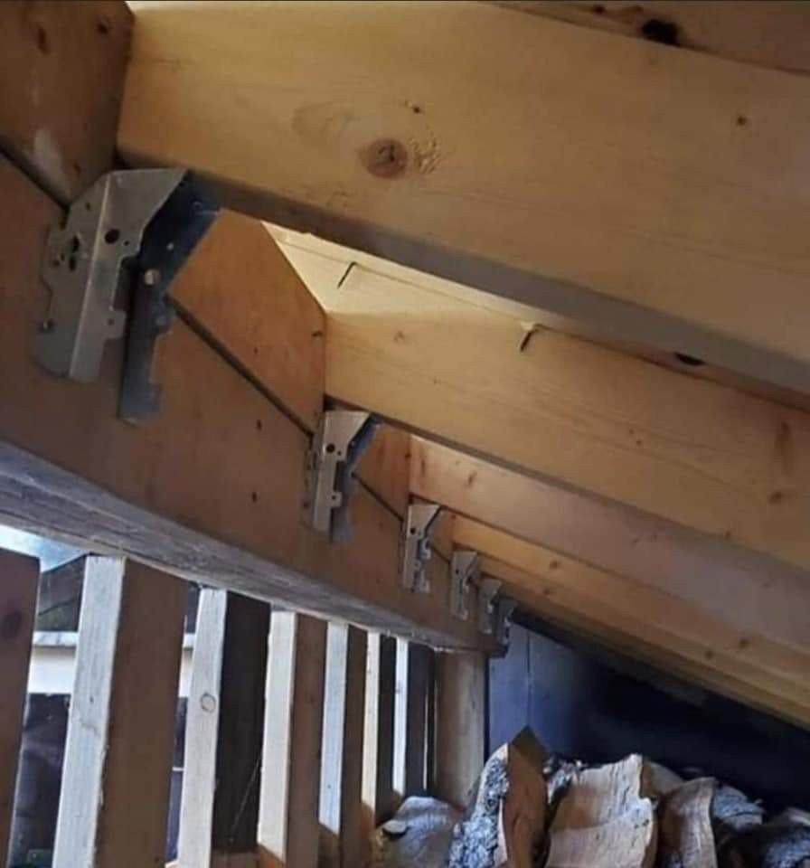

    Saw this on Facebook. @OZ-T this your handiwork?

    Will
    Bourbon state
    if its stupid but it works...nevermind its stupid....;)

    is there a problem here ?

    Thanks for the afternoon laugh. I'd love to blow out one of those rafter blocks and see why the 2x6 is higher then that beam and has no seat cut in it. That shouldn't be possible. lol

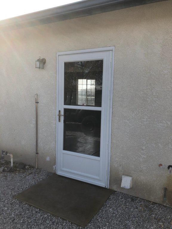

    Installed a storm door yesterday.
