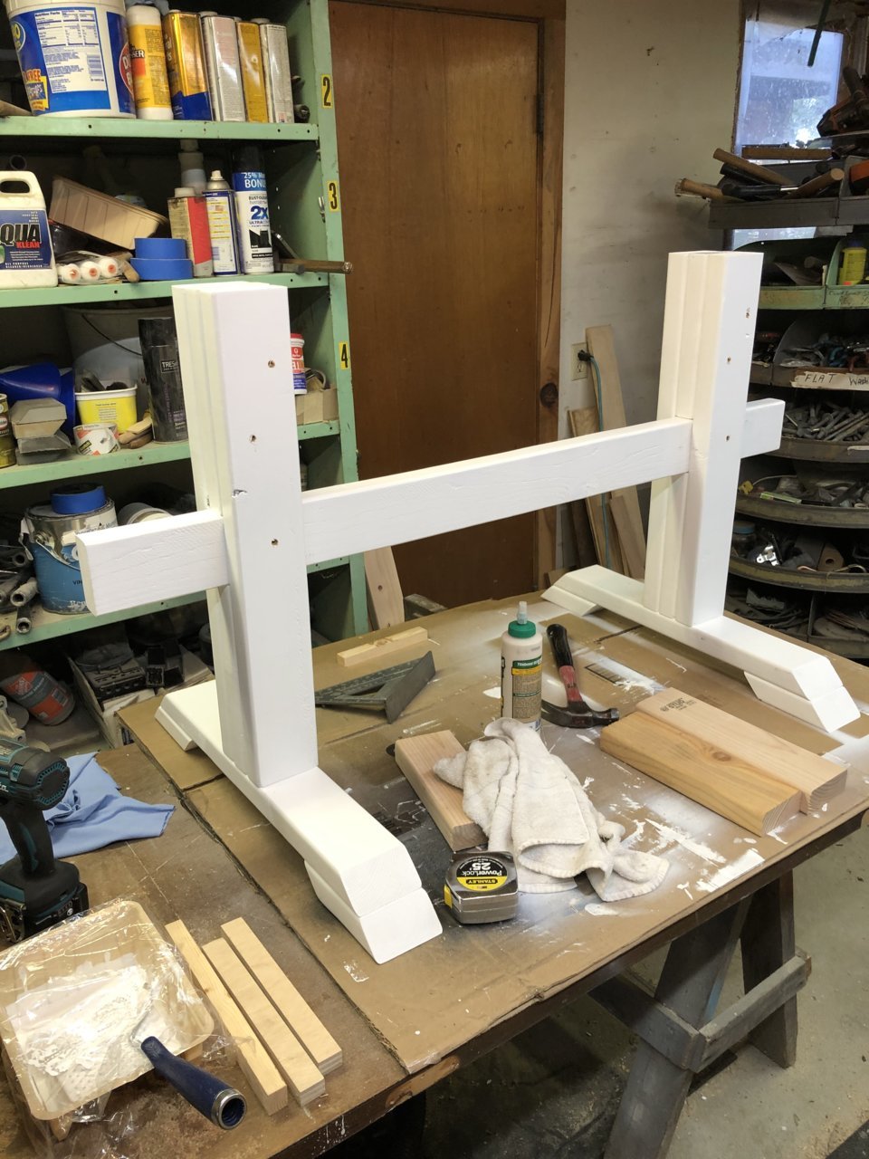

    Building the base to a small/cheap kitchen table today.

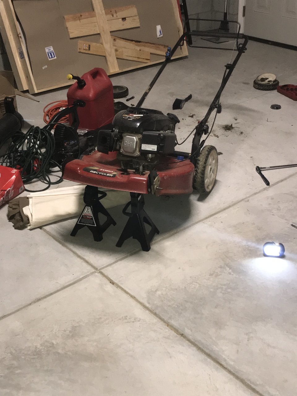

    Found a pebble stuck in the self propelled belt. Had this mower almost 8yr now and hasn’t had any major issues so time for some in-depth TLC (replacing belt and wheel bearing since I have it apart). One of the bearings is shot and the hat part of it came off the rest of it.
    Oh and don’t have much use for the smaller jack stands anymore so put them to use

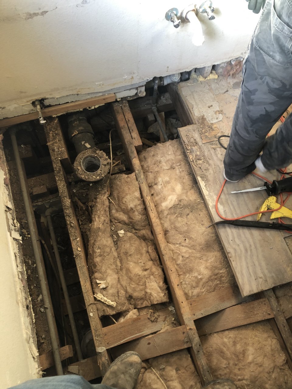

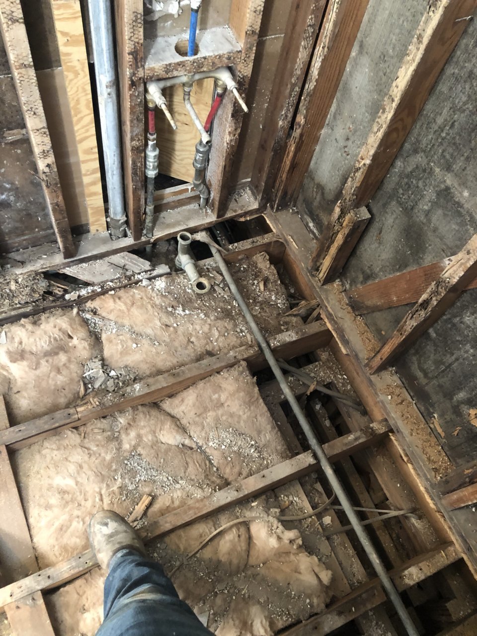

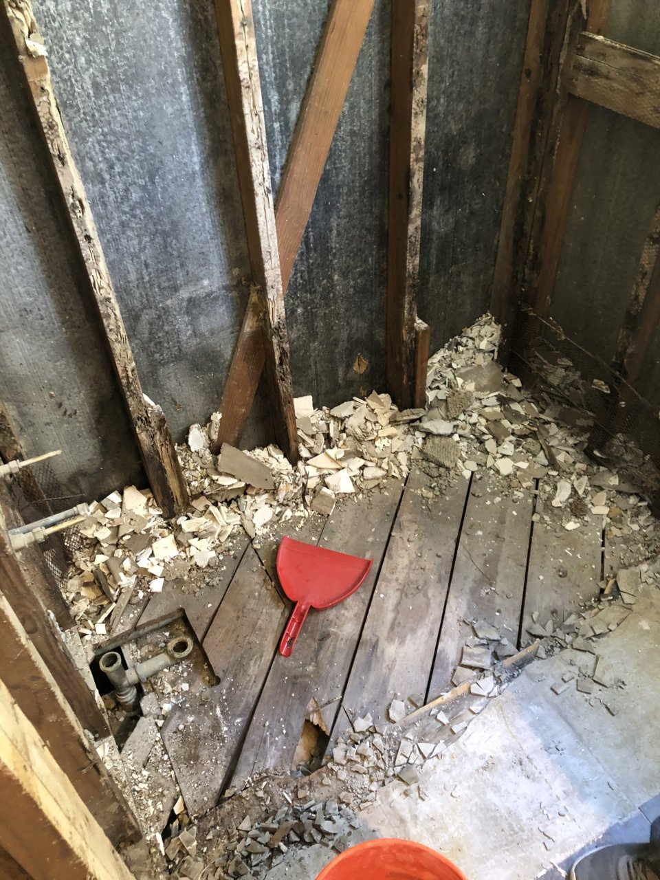

    Got the old cast iron tub out, removed the vanity and toilet, and removed the old decking material.
    Luckily the unit next door is vacant so the tenant and his sons can use it’s bathroom for now.

    Man that there is a cornucopia of plumbing...

    Yeah, apparently the old landlord liked to “fix” things himself and then after he “fixed” it and it didn’t work he would call a professional. I would hate to hear the stories the walls could tell, this was the second time in just a few years that the flooring has been pulled up, there was a mis match of materials in the 5x8 space that we’re redoing now, and as you can see they didn’t use blue pex for the cold water supply on the cold tub faucet :annoyed:

    holy shit , enough mould on the back of that drywall ?

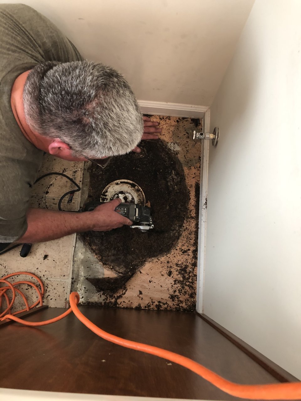

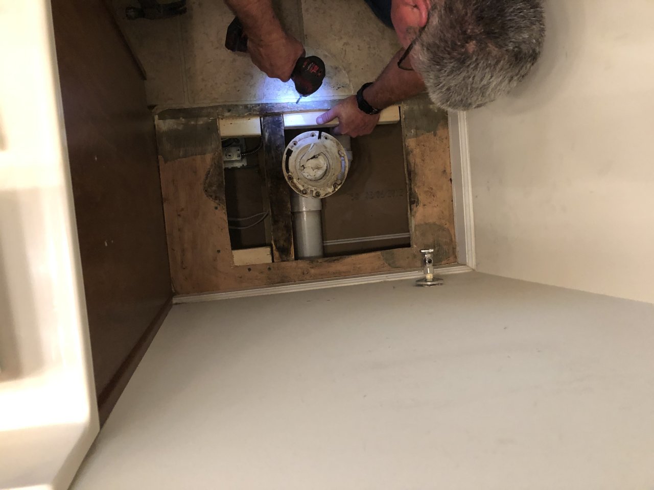

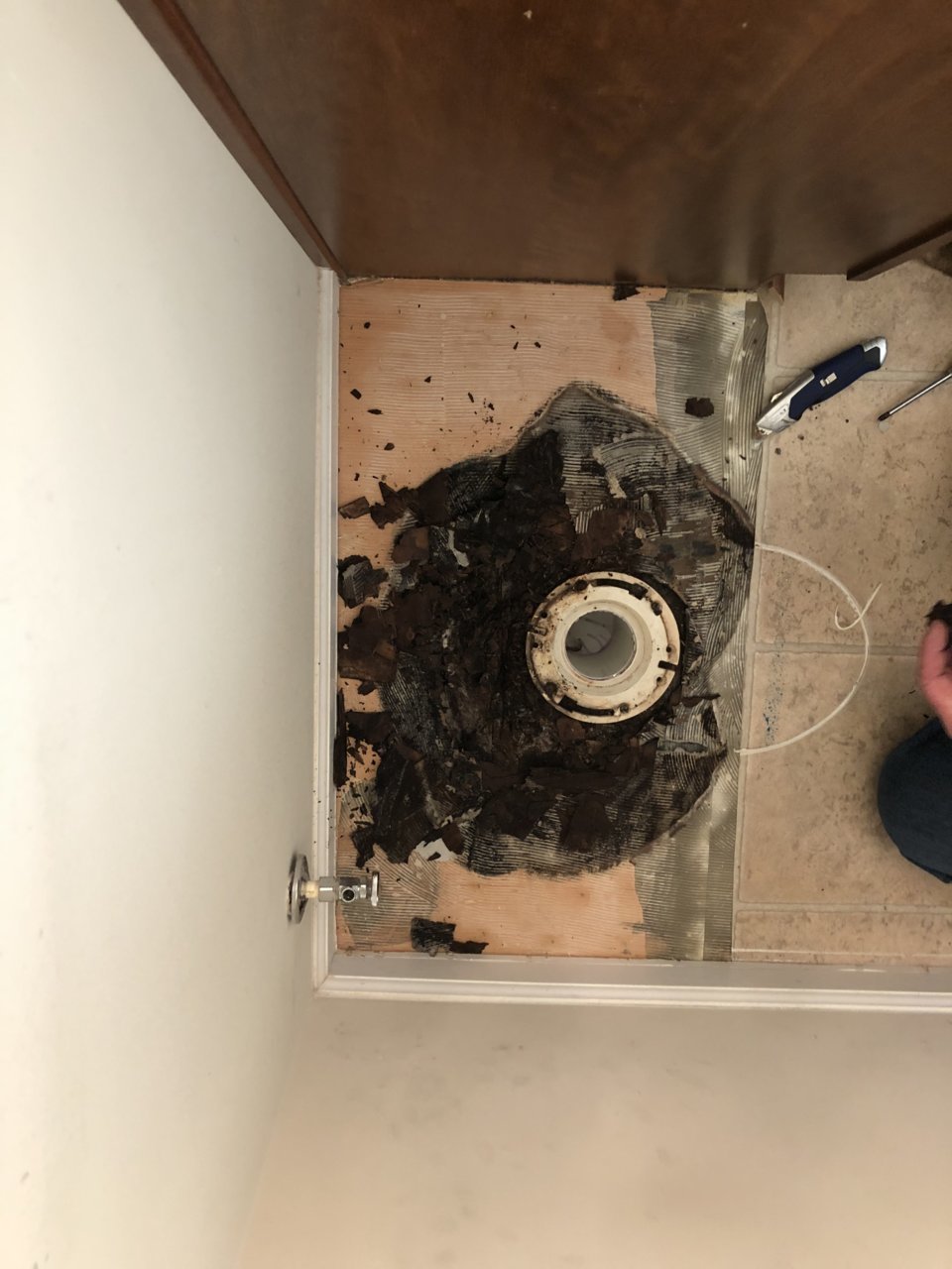

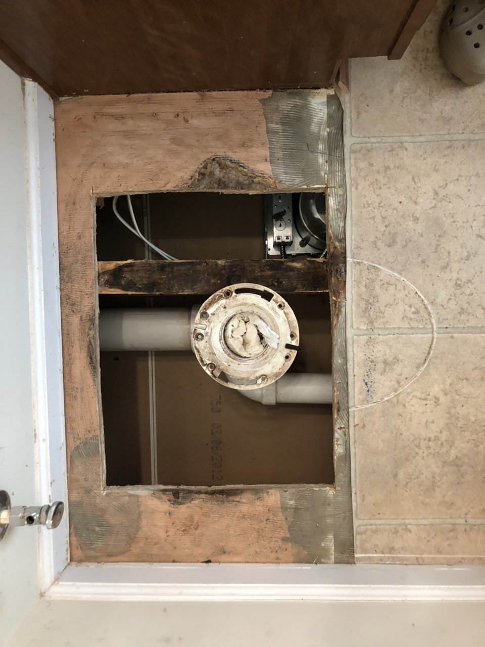

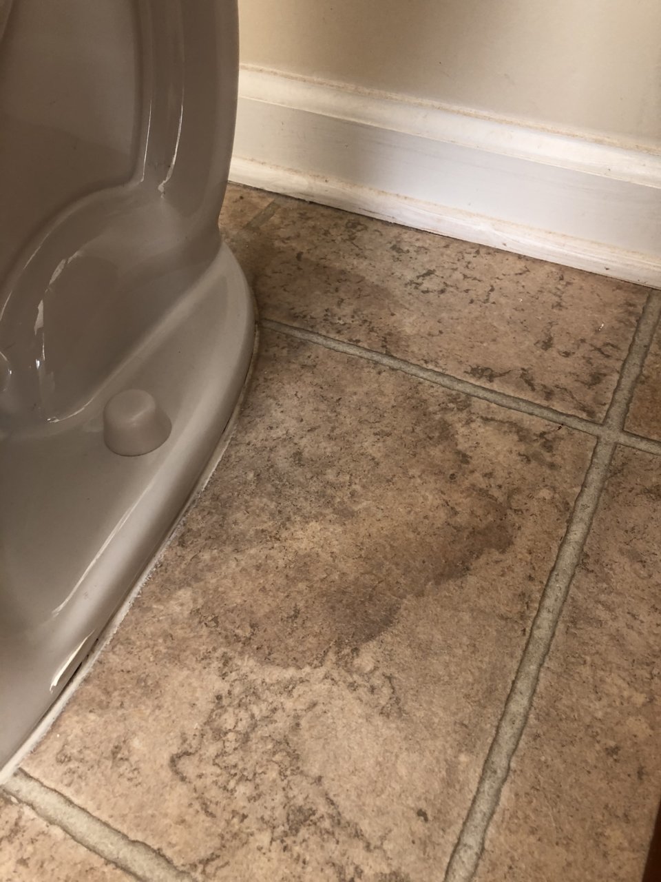

    Found some discoloration of the vinyl flooring the other day, which ended up leading to a much bigger problem. Luckily the issue was contained to just this area and never leaked through to the kitchen ceiling downstairs.

    Nice repair
    Seen that a lot over the years

    thankfully it wasn’t worse and not nearly as the bathroom gut job a few posts up but all because the builder didn’t use a $2 flang!

    Did you replace the flange?
    I can’t tell on my phone

    Yes and that was part of the problem. The builder didn’t install one, just put in a wax ring, and sitting it crooked probably didn’t help either.
