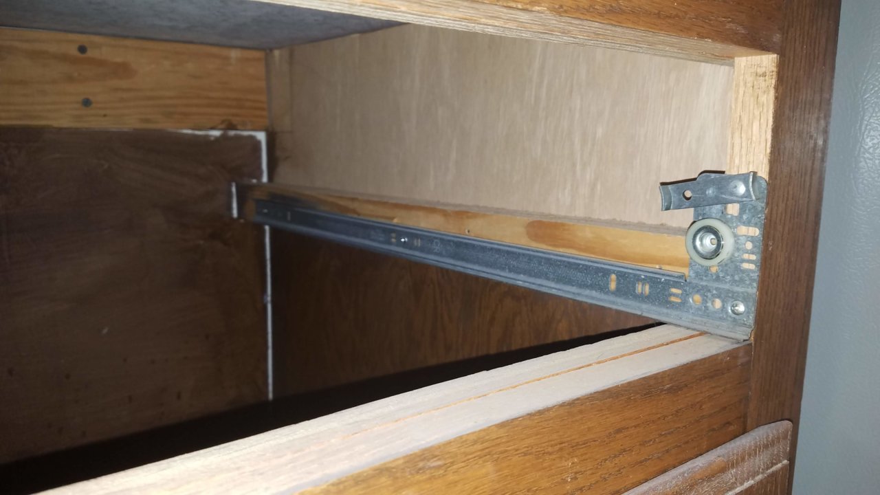

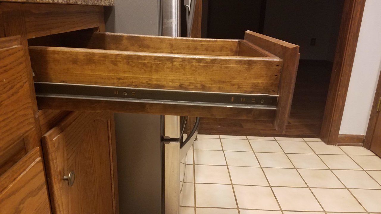

    I think I've found the first thing that I want to upgrade in the new house. The draw slides in the kitchen are annoying me because the draws can shift a bit side-to-side and bind/drag until you wiggle it around to recenter it. Is it just a matter of finding new slides and replacing the old slides? Or am I missing something, and it's more involved?
    Would I just need to measure the difference in drawer opening vs the drawer to get the needed slider thickness, and the length of the drawer for the slider length?
    Here are a couple of pictures of the current drawer slides.

    If you have 1/2" on either side of the drawer you can install standard drawer glides. Most likely you'll need 21"
