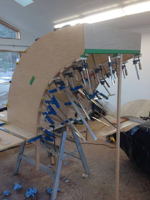

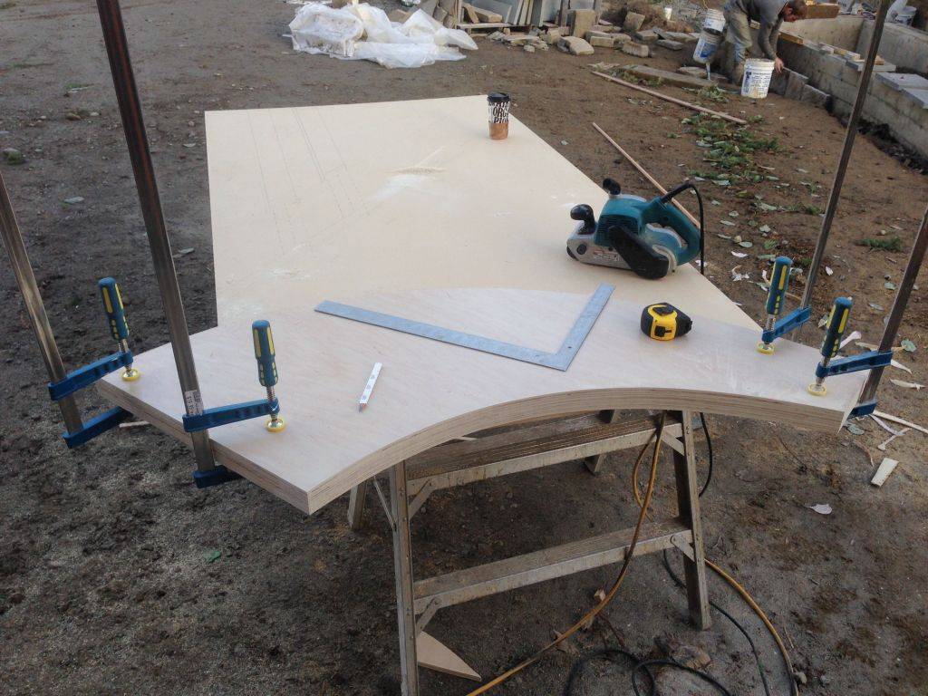

    Project Next
    A set of shelves for a curved wall in a pantry / utility closet
    The rear radius follows the curve of the wall it will be mounted to , the front radius is different with the shelves going from 8" deep at the narrow end to 24" deep at the wide end
    Material is 3/4" laquered maple plywood
    I first fitted a hardboard template and then used that to trace and cut out my shelves , I gang stacked all three together to do a final flush sand so that they would all be identical
    I biscuited and screwed on the 24 wide gable that will go against the adjoining wall ( screws will be hidden ) and biscuited only the narrow gable that will show
    The front will be face framed with applied 3/4" x 1 1/2" clear Fir rails , I had to make the curved ones up out of 3 / 1/4" x 1 1/2" strips each in order to be able to bend thd curve
    Shelf unit on it's side clamped to the table so I can bend all three curved rails at once
    In the clamps
    The jillpoke is there cause I was getting worried the weight of the clamps was going to flip the table over , haha
    Hopefully finish it tomorrow , I'll add pics after I install it if it fits , or the bonfire if it doesn't

    That looks awesome. When are you going to build a steam box? :) i think thats the second or third project you have posted that you could have used one.

    Damn sir clamps a lot

    That doesnt look like a 35' tape in the top picture there OZ :notsure:

    Yep , Fat Max 35'

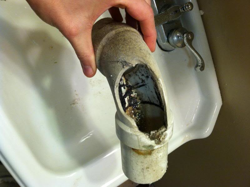

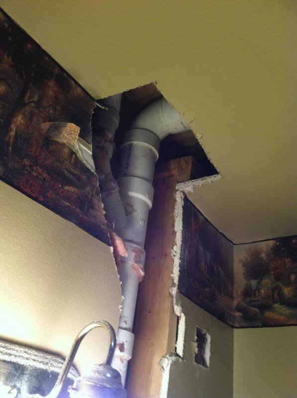

    merry christmas to me...

    Wtf!!! ^^^

    I called a the home warranty company so it would hopefully be under warranty, plumber showed up and we ripped open the wall. Its been broke like this for years and i don tthink the previous homeowner ever noticed. he said it looks like someone broke the pipe during renovations and since it broke on the back side no one ever noticed.
    how the hell can you not notice the drain line to your clothes washer is gushing water through the freakin wall????
    warranty did not cover it as it was pre-existing condition per the plumber's diagnosis to the warranty company.

    well, the broken pipe may have been a blessing in disguise. the fiance called and said the house reeks of gas. got home last night and sure enough it did. gas company came out and determined the gas line next to the clothes washer drain was leaking. we never noticed it before because that cavity was full of insulation, drywall etc...
    so i'm glad we opened that up and found that, really didnt feel like exploding. my wallet doesnt like it but eh, better than starting a fire.
