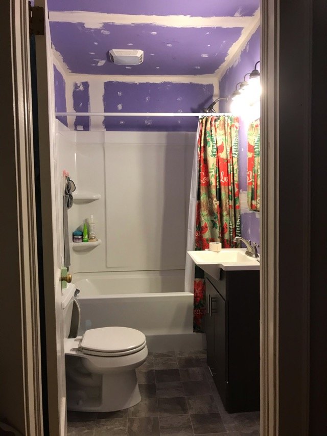

    Got the first coat of mud on the jingle bell rock project today.

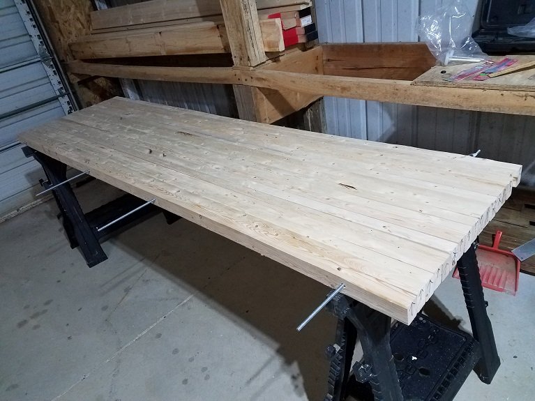

    In the process of building a Bench Top for the garage, bought 2x3's, drilled holes for threaded rods, cut about 1/4" off so the tops are flat. It is just a dry fit at this point, next up is to glue it all together and sand it smooth after.

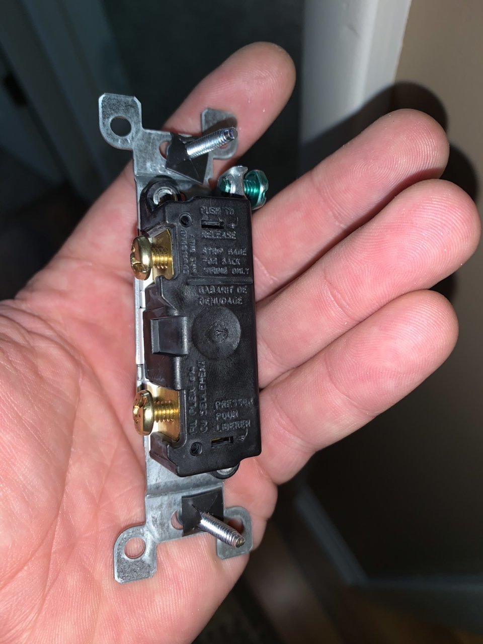

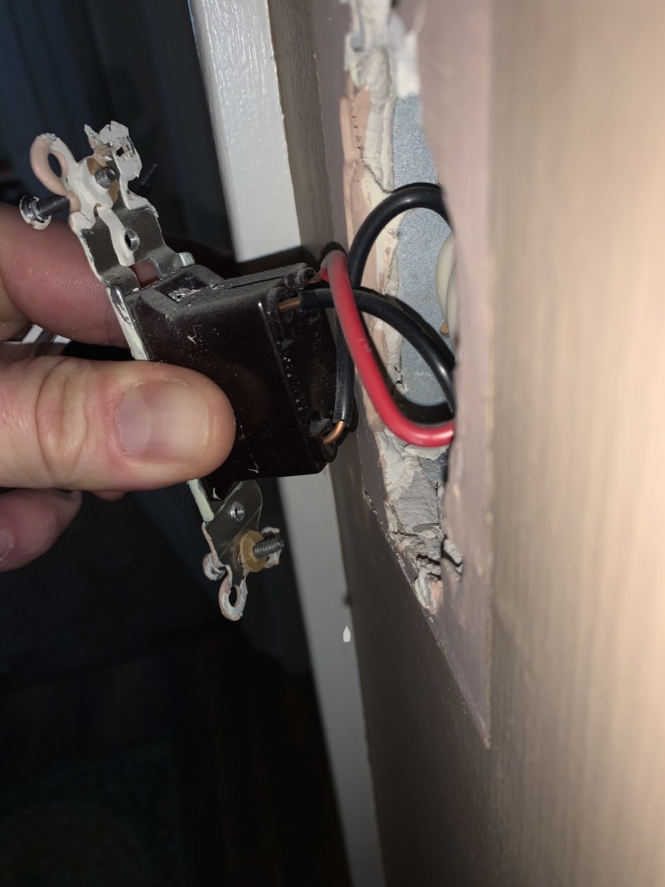

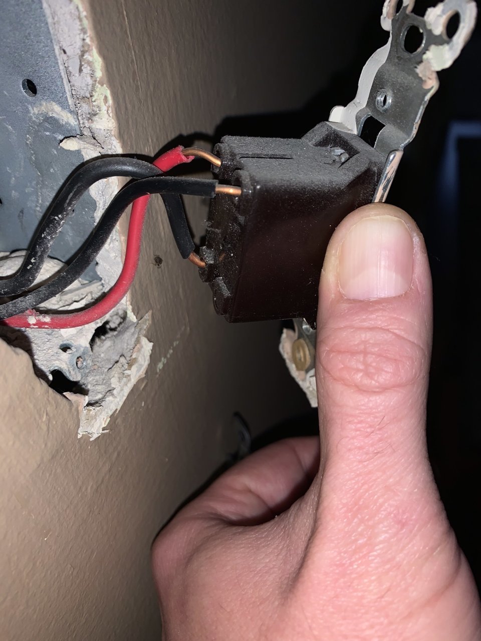

    Can this switch be replaced with this one or do I need a three way switch? I’m thinking I need a three way. These two switches operate the same hallway light.

    3-Way
