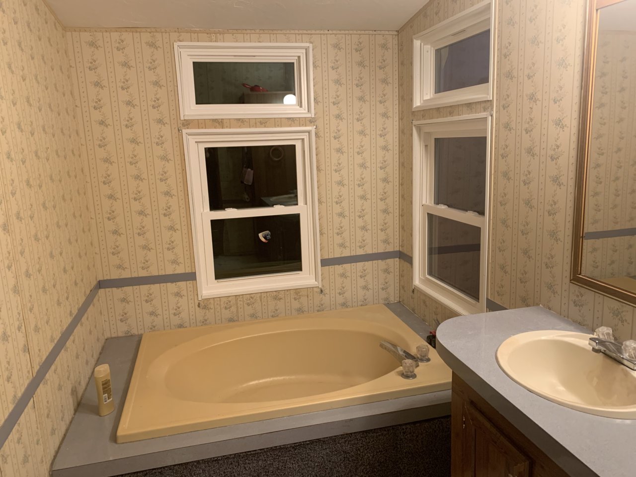

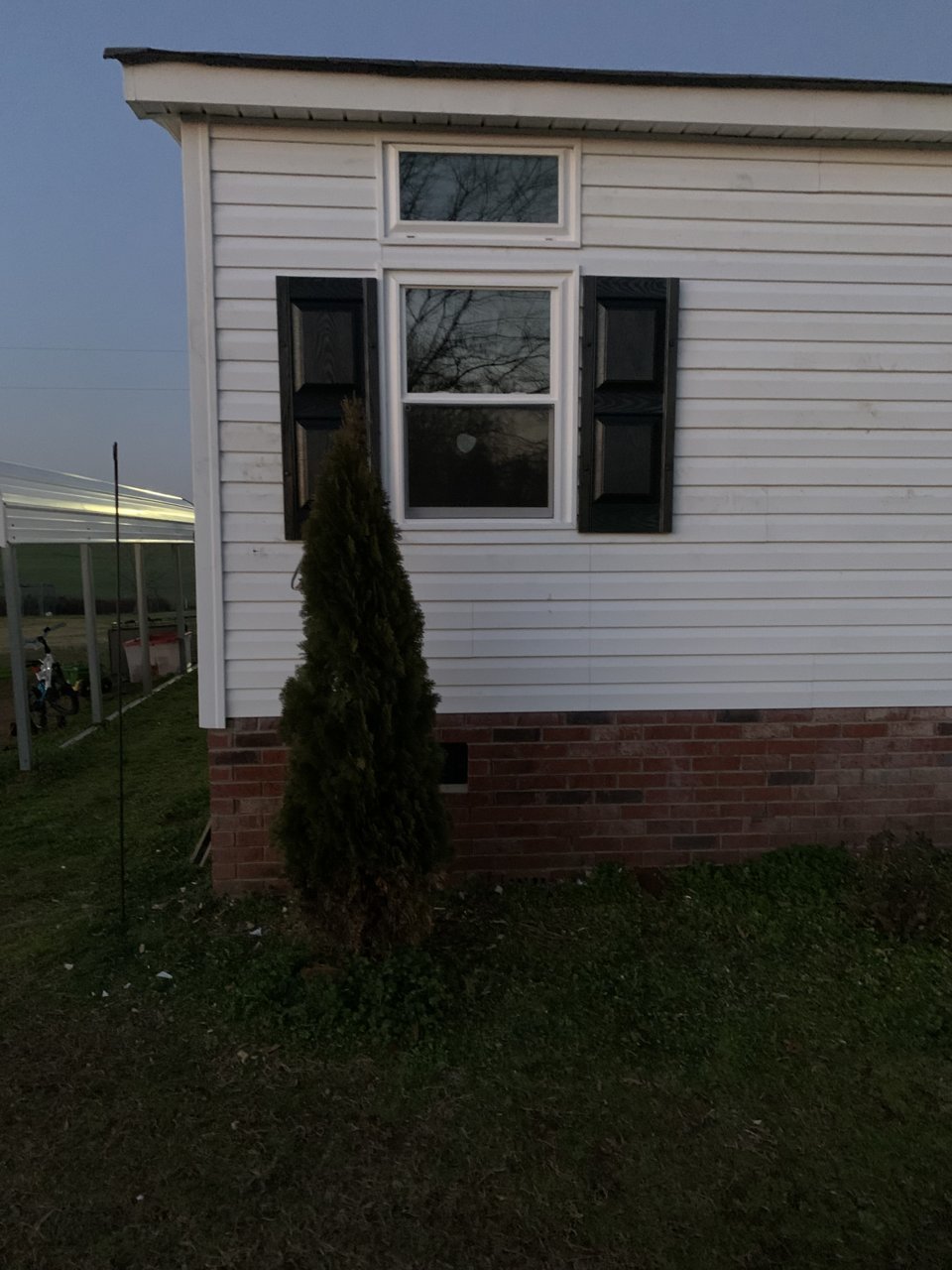

    New windows in a double wide I’m remodeling that was given to my wife

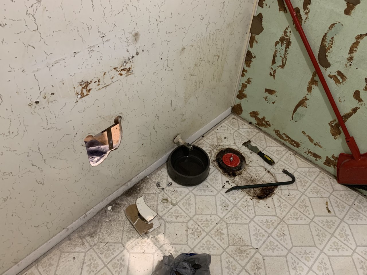

    Basement Reno starting finally. Removing all of the paneling to do drywall and putting vinyl plank flooring down. The room on the other side of the torn out wall is a half bath/laundry room we are completely gutting. Got the sink and toilet out and capped off the pipes because the sink is getting relocated to the other side beside a stackable washer and dryer.

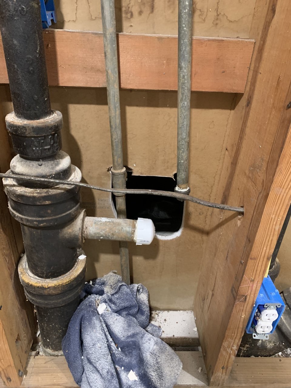

    For this wall that I've opened up, that is between the basement and the laundry/half bath. What would you all recommend using for insulation? I'd like it to be as sound proof as I can just to help with privacy and noises of the washing machine/dryer...but I don't want to spend an arm and a leg on insulation and sound is still going to come out of the door to the space. I've never done insulation or drywall so this is all a learning experience for me.

    How tall is the ceiling in the room?
    Why is it sagging on the right side?
    Is that black mold on the left side top?
    Is the white board coming out too?
    I'd probably run the drywall sideways considering whoever laid out the plumbing screwed the 16 on centers of that wall. That is also going to make the insulation more "fun". Your standard 2x4 R13 insulation would be fine.

    The ceiling is 8ft tall.
    The sagging, I think you are meaning the white section above the torn out wall, is a portion of drywall that was behind the paneling so whoever installed it did not care if it was straight.
    It is not black mold it is some sort of dirt/water concoction from behind the paneling where some water dripped from the bathroom above when we remodeled it. It's like "paneling residue" if that makes sense haha.
    Yes I plan to take that white section out as well and re-drywall it.
    I like the suggestion of sideways drywall, that sounds like a better plan because as you noticed I won't get as many spots to screw in if I run it vertical.

    Start the drywall at the top. Any gap at the bottom could then be covered by trim or molding.

    yeah at that section specifically that's a good idea, thank you. The rest of the room will have crown molding, but this section sort of under that "overhang" will not have molding at the top.

    What I generally see on commercial projects for sound mitigation is a sound attenuation insulation with doubled up gyp board on each side.

    Roxul Safe'n'Sound
    PS you should leave an access panel to the clean out on your main stack

    that sounds like more work than I want, doubling up, lol.
    thanks for the recommendation, I'll look into that!

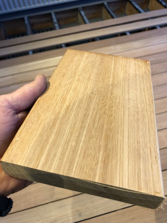

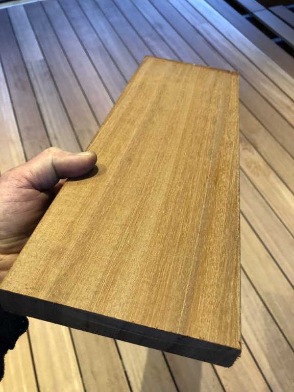

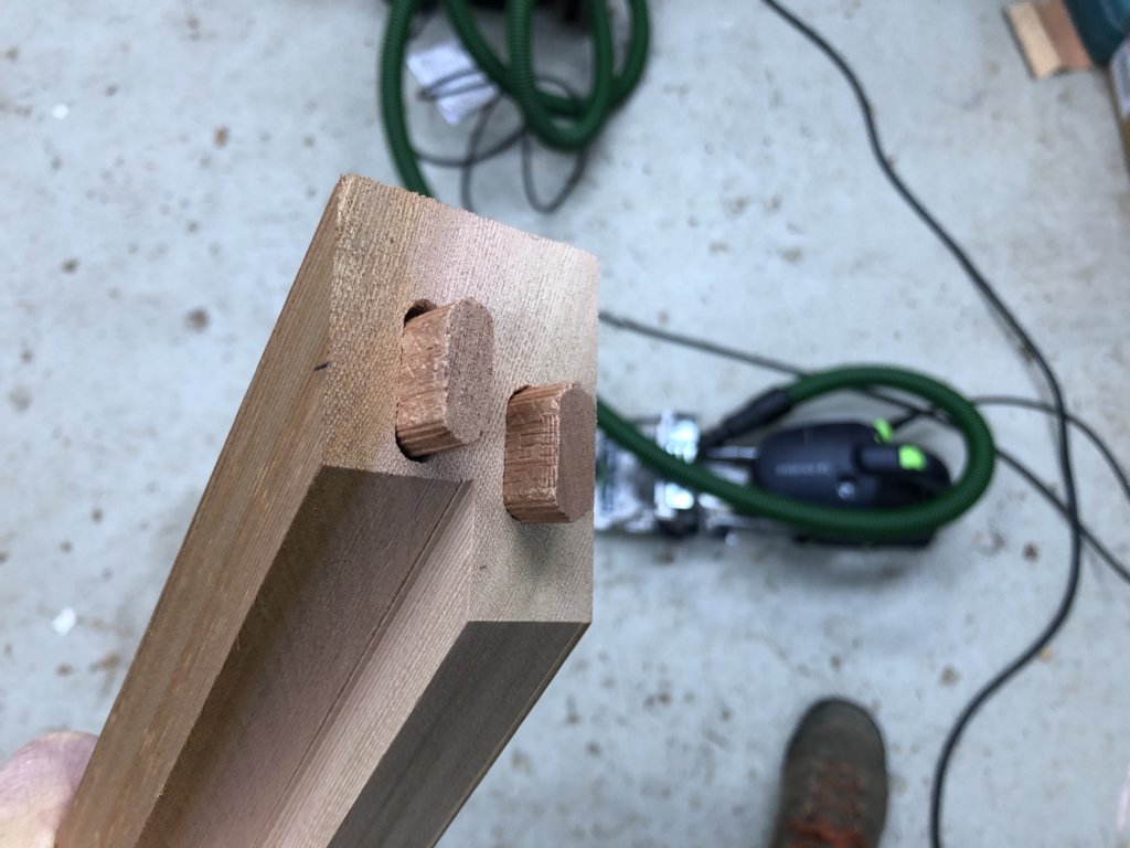

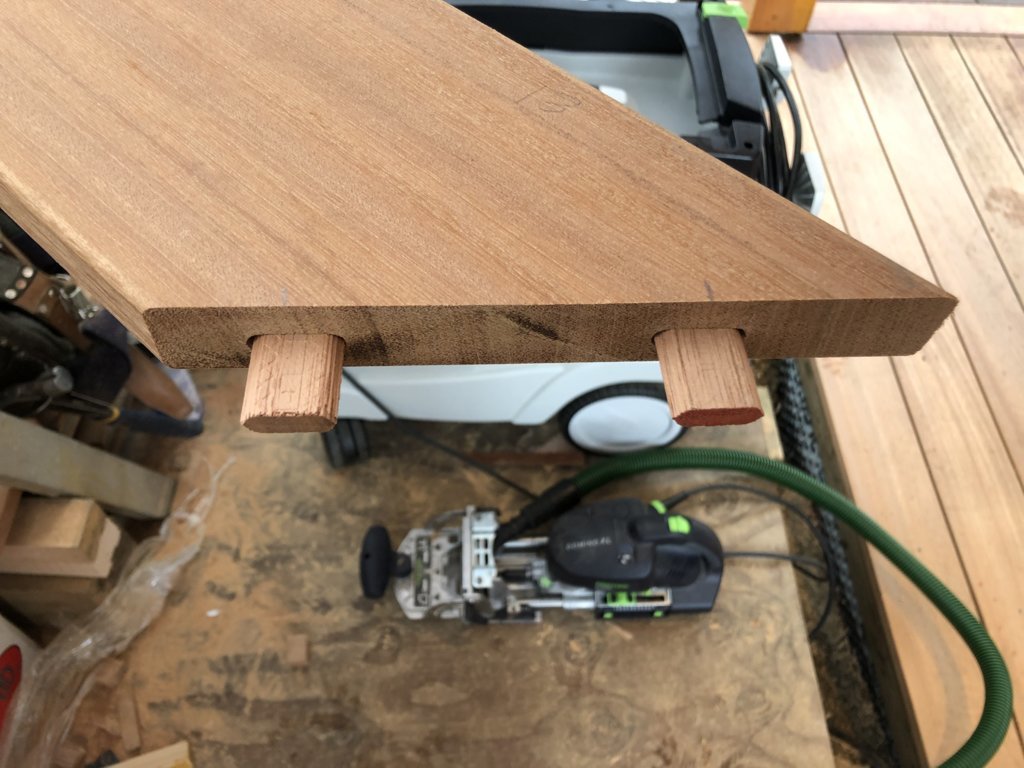

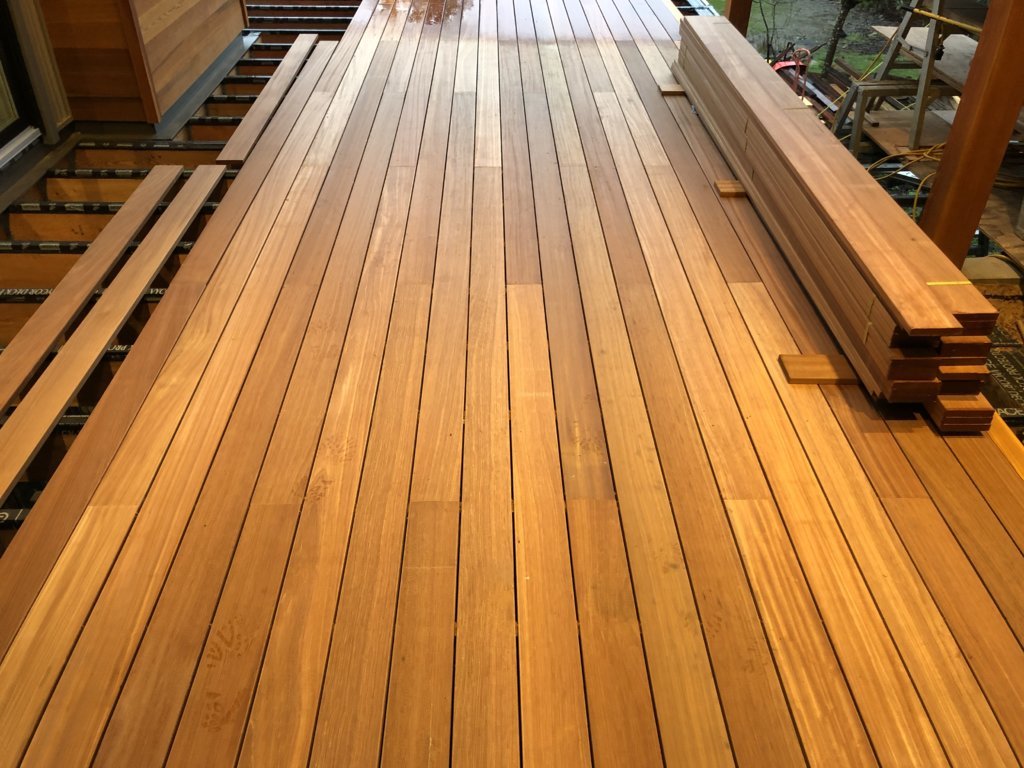

    Got to use my new Festool Domino 700 for the first time on this decking install
    I like
    8mm Sipo Dominos

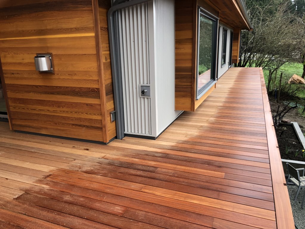

    Decking is all down and picture frame notched for the 2"x2" stainless cable rail posts that we will install next week

    What glue did you use?
    I have the 500, wishing I had bought the 700. Great tool.

    I was planning on Titebond Polyurethane but I couldn't get it locally when I needed it so I used Gorilla Glue

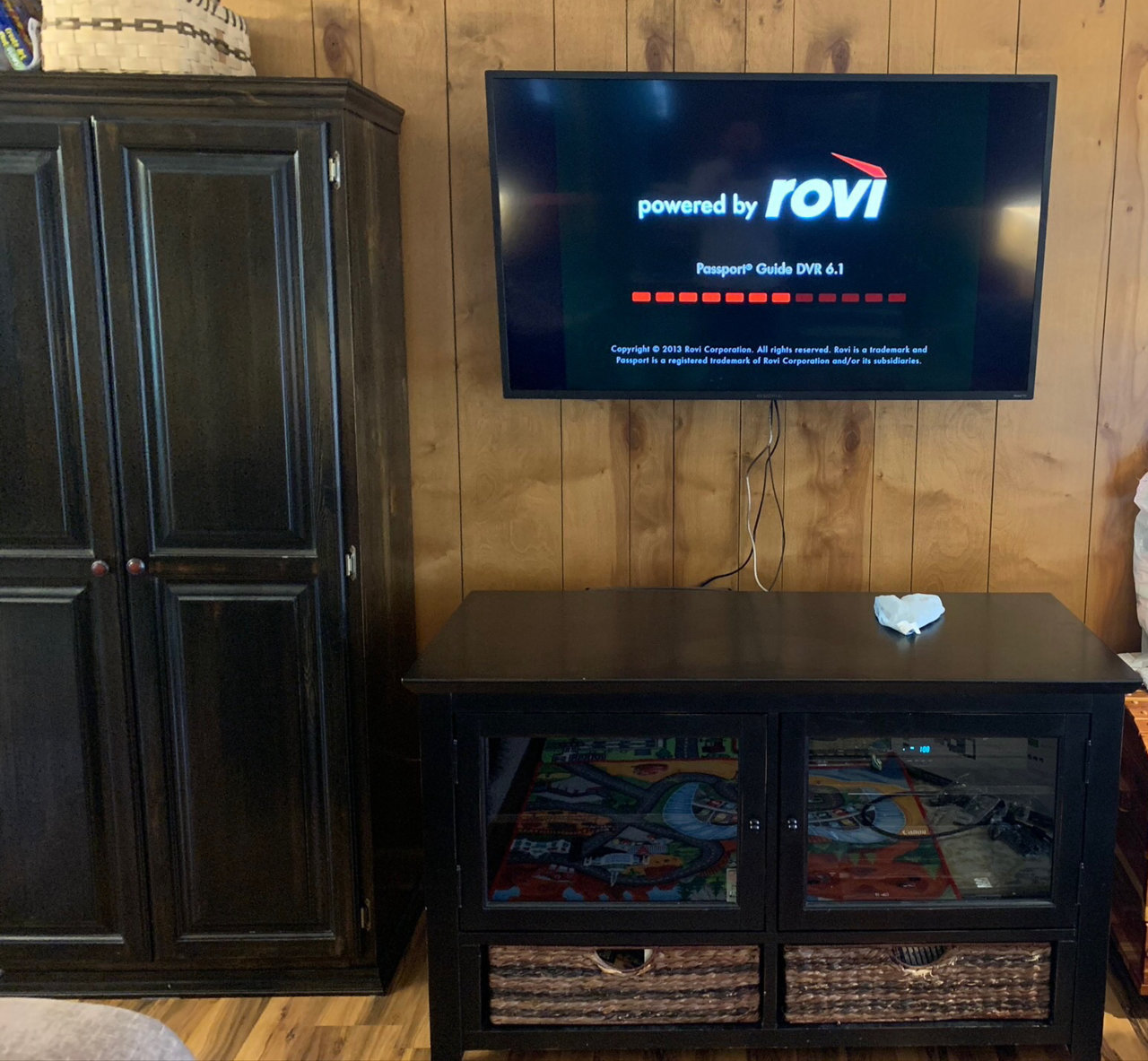

    Finally mounted the TV to the wall, and just ordered the cable cover from Amazon. Also replaced the HDMI cable from the cable box to the TV, huge improvement in color.

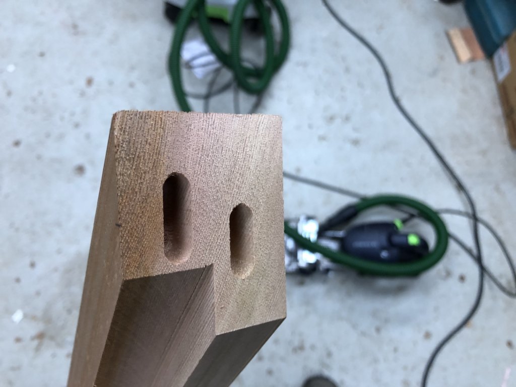

    I had a chuckle thinking about this post today . I was laying out some joinery for some frames I'm building at home and wished I had the 500 to use haha
    Due to the size of the 8mm dominos and the fact that the 700 cuts a minimum of a 15mm depth , I ended up with zero room for error with the domino lay out for the narrower part of the rail .
    I had cut the mortises on the wider side first with the machine set to the tight mortise setting and planned to cut the second mortise on the loose setting
    Literally could only fit in one spot to not blow through the side or have the bit blow out through the bottom
    Enter the Incra lay out rule , no parallax error
    Whats the depth range on the 500?

    The depth stops are, 12 / 15 / 20 / 25 / 28 mm.
    My friend that has the 700 uses one of these to simulate the 500, and a spacer(makes his own) to limit the depth.
    https://www.festoolproducts.com/acc...mortise-kit-for-festool-domino-xl-df-700.html
    He also said he’s going to end up owning both, but this is a work around for now.
