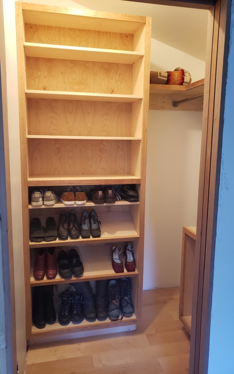

    Got the shoe rack/shelf installed in the "master" closet... ok, this was a few days ago, but I just found this forum! I've since added the toe kicks and baseboards... and drawers to the right. Picked up some wood today to make the drawer fronts...

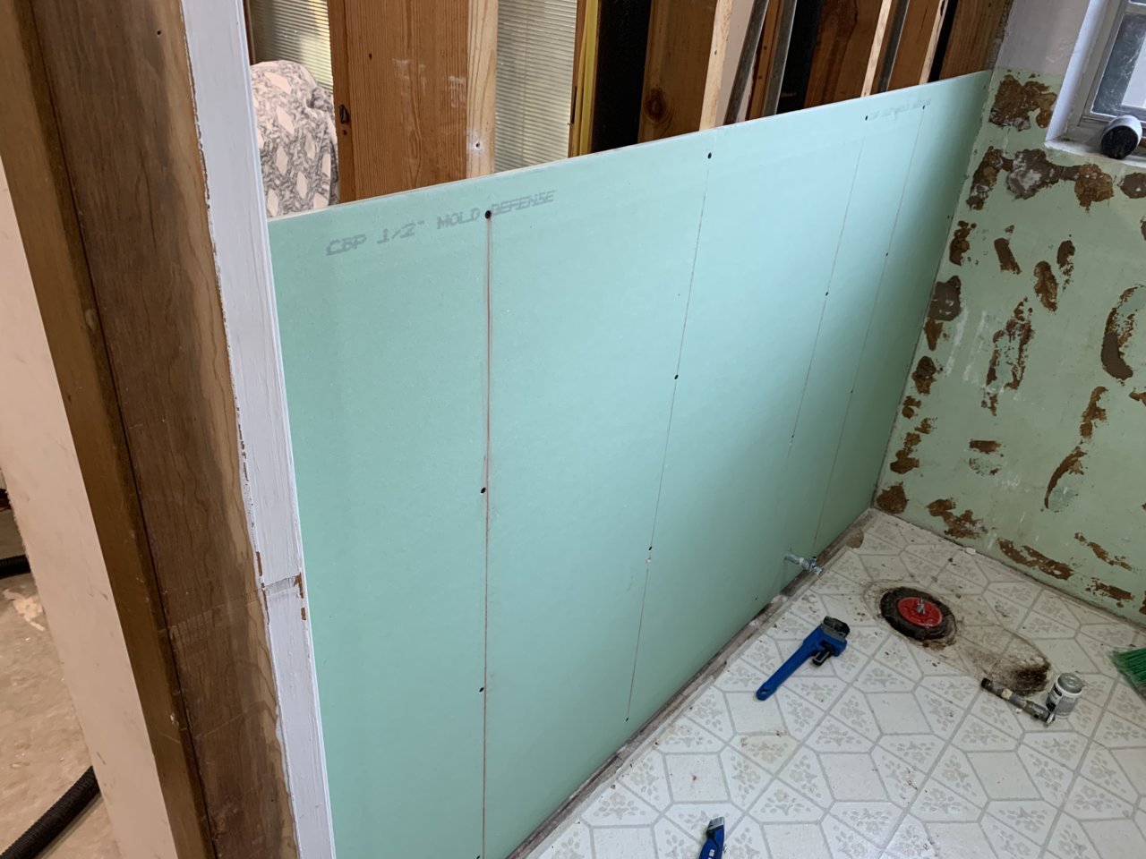

    Got the first piece hung inside the laundry/bath. Needed it hung so that I could put the valve back on for the toilet so I could turn the water back on. The other valve needed replaced.
    Please all critiques welcome. Is there a pattern or method to doing the screws? My dad told me I should have paid attention for a beveled edge on the drywall but this stuff is just flat on both sides as far as I can tell. Anything else I should’ve known or done?
    also ignore the doo doo looking stuff on the other wall lol. That’s like glue and leftover cardboard type backing from the plastic board stuff that was hung on the walls. It’s a pain in the ass to scrape off that block wall...

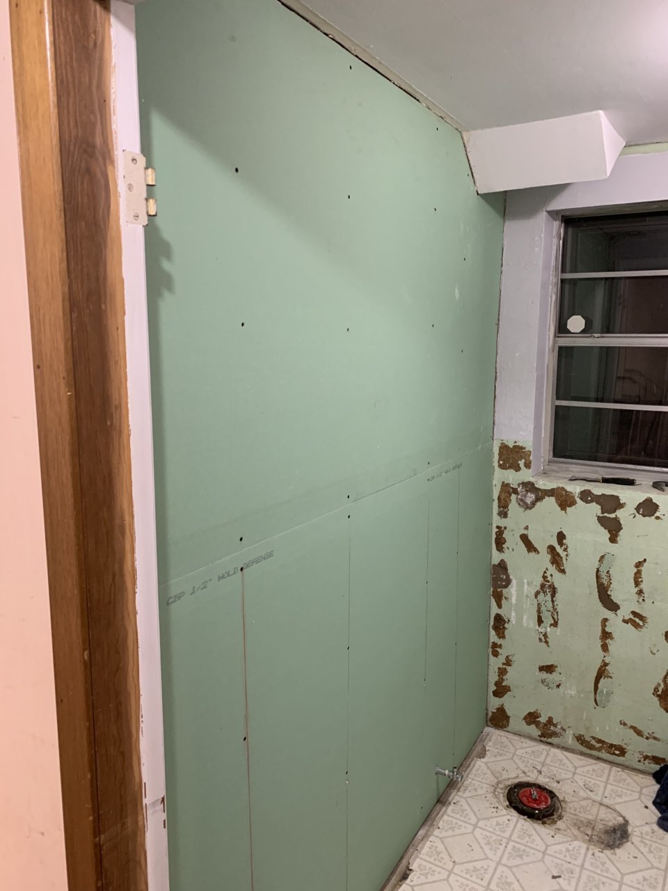

    And the top piece with stupid ass cutout!

    The beveled edge runs along the long side. You're hanging horizontally. Where the "CP blah blah" text is the bevel. It will make more sense when you tape the seams and then mud. Ideally, you want to tape where two bevels meet.
    There is a screw pattern. It can vary product to product and by building code... Out here it's 12" for the ceiling... and I forget the walls... 15"? 18"?

    I figured out the beveled edge once I grabbed the second piece. It’s on both long sides. You can sort of see it in that last pic I posted.

    What is that, what you cut around?

    Whoever built the home is an idiot. That’s where the toilet for the hall bathroom upstairs drains. So it comes down then turns to the drain in the wall. So if you see the toilet I have removed now, imagine a toilet directly above it lol

    *Whoever remodeled the home?
    I have a hard time seeing an architect design that.

    Maybe but idk. The house was built in 1962 and only one family ever lived here. Not a single thing in the house was updated or renovated when I bought it so I have a hard time seeing this being something that was. Split level home, lowest level is on a slab, which is the level I’m working on now. And the toilet drains are cast iron original. No way they moved them lol

    Probably poor planning from the start.
