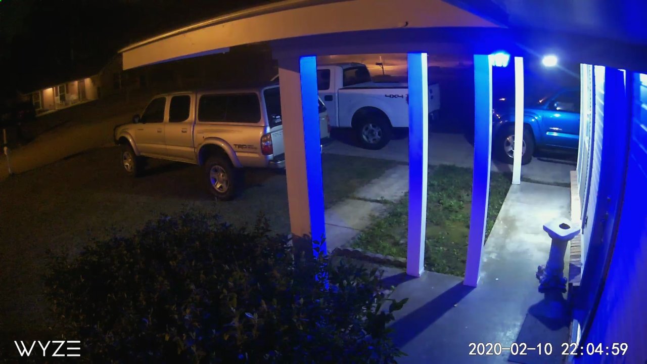

    Installed this Wyze cam in about 20 minutes after work today, neighbors are getting sketchy again (back doing drug deals out front, odd activity) so I wanted to put this up to keep an eye on parcels that get delivered.
    I still need to seal the hole for the cord but I didn’t feel like going out and getting material so it might get done tomorrow weather permitting.
    1CCD95EE-A80B-4555-8A9A-2EE8BF9038F5.jpg 4B2256E8-B923-42EB-B5B7-2C6EA7C55DCC.jpg
    And of course on top of the 3 total cameras (1 inside and one on the back porch) we have a monitored alarm system as well as 2 German shepherds so with a few more perimeter cameras and re-wiring the perimeter lights our security system should be “good enough”.

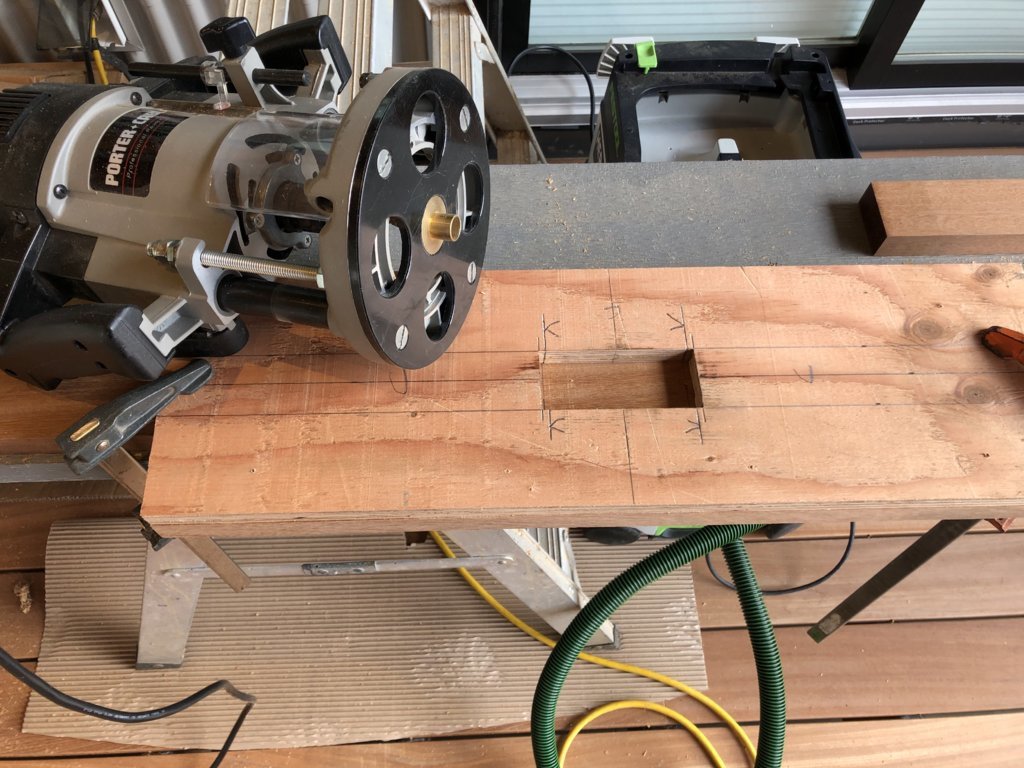

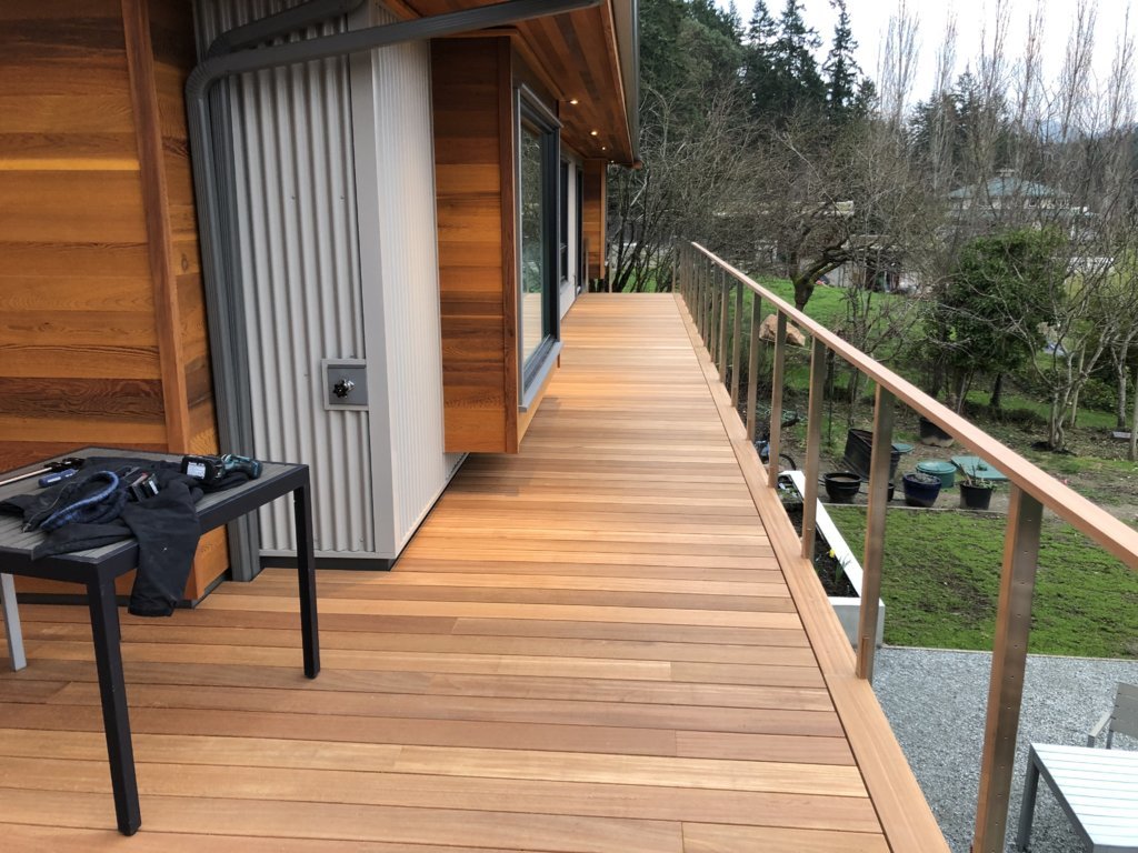

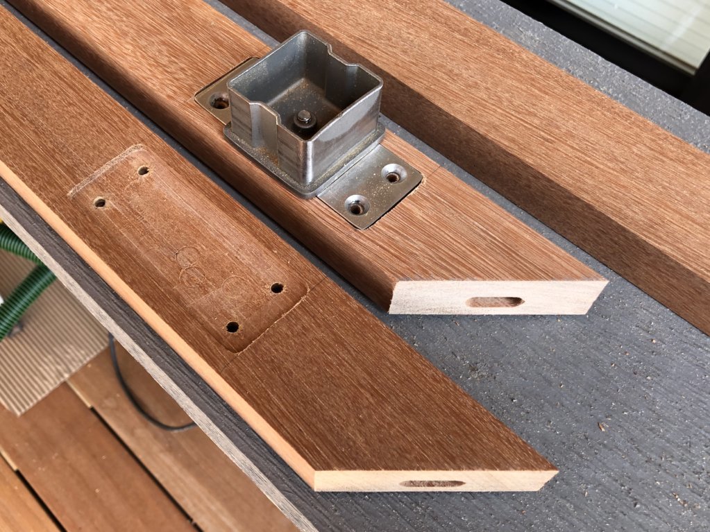

    Started installing our railing system yesterday
    The posts are 2"x2" stainless , fascia mounted
    I'm making the handrail from some of the Bangkarai yellow Balua decking material , there is a 2"x1" sub rail that will then have a 4"x1" cap on it
    The handrail mounts to the posts by way of post caps that have an integral fixing flange for screwing into the handrail from below
    These fixtures need to be routed into the sub rail for a flush fit
    To rout the rails I made a routing template from some plywood and used a templating collar in the router with a 3/8" upspiral cutter
    The rail section joints are reinforced with 8mm x 50mm sipo dominos
    I got all the posts mounted and most of the sub rails installed over the last 2 days
    Tomorrow I will finish the sub rail install and we will start installing all the cable
