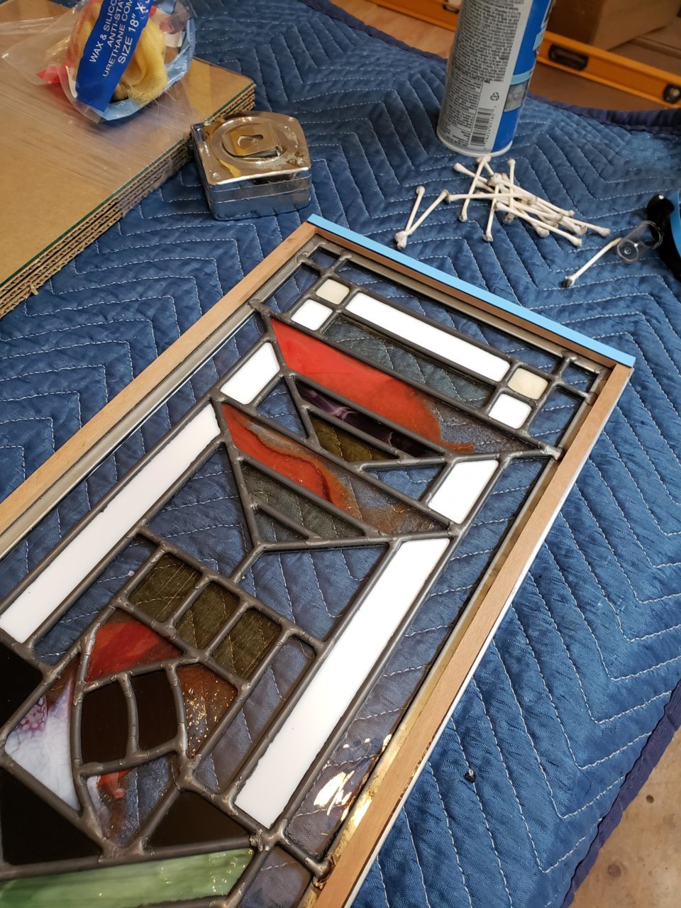

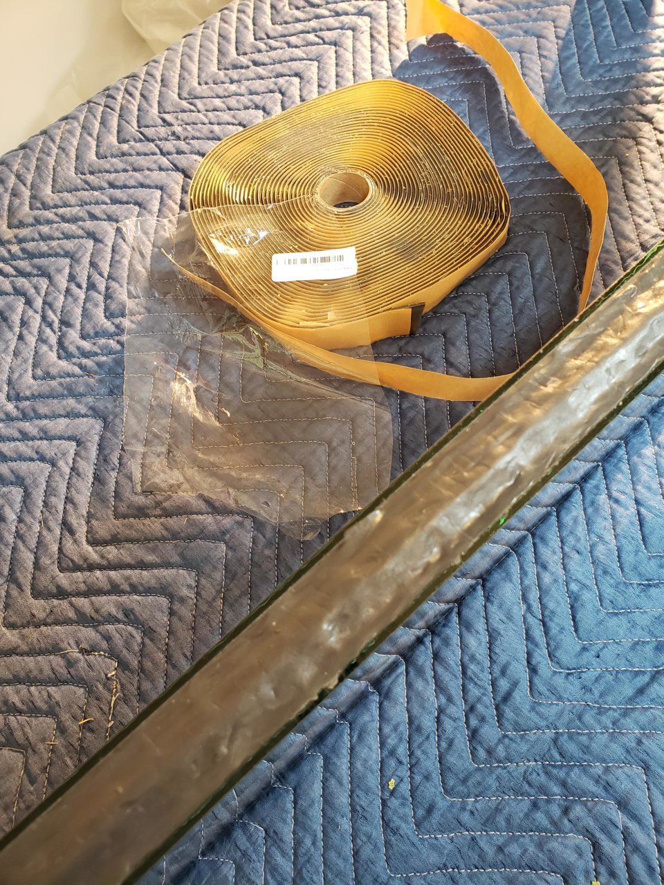

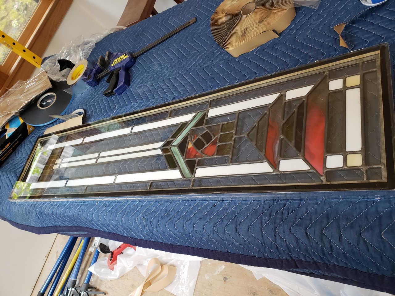

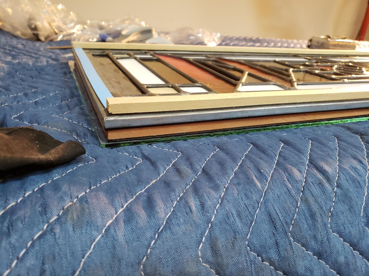

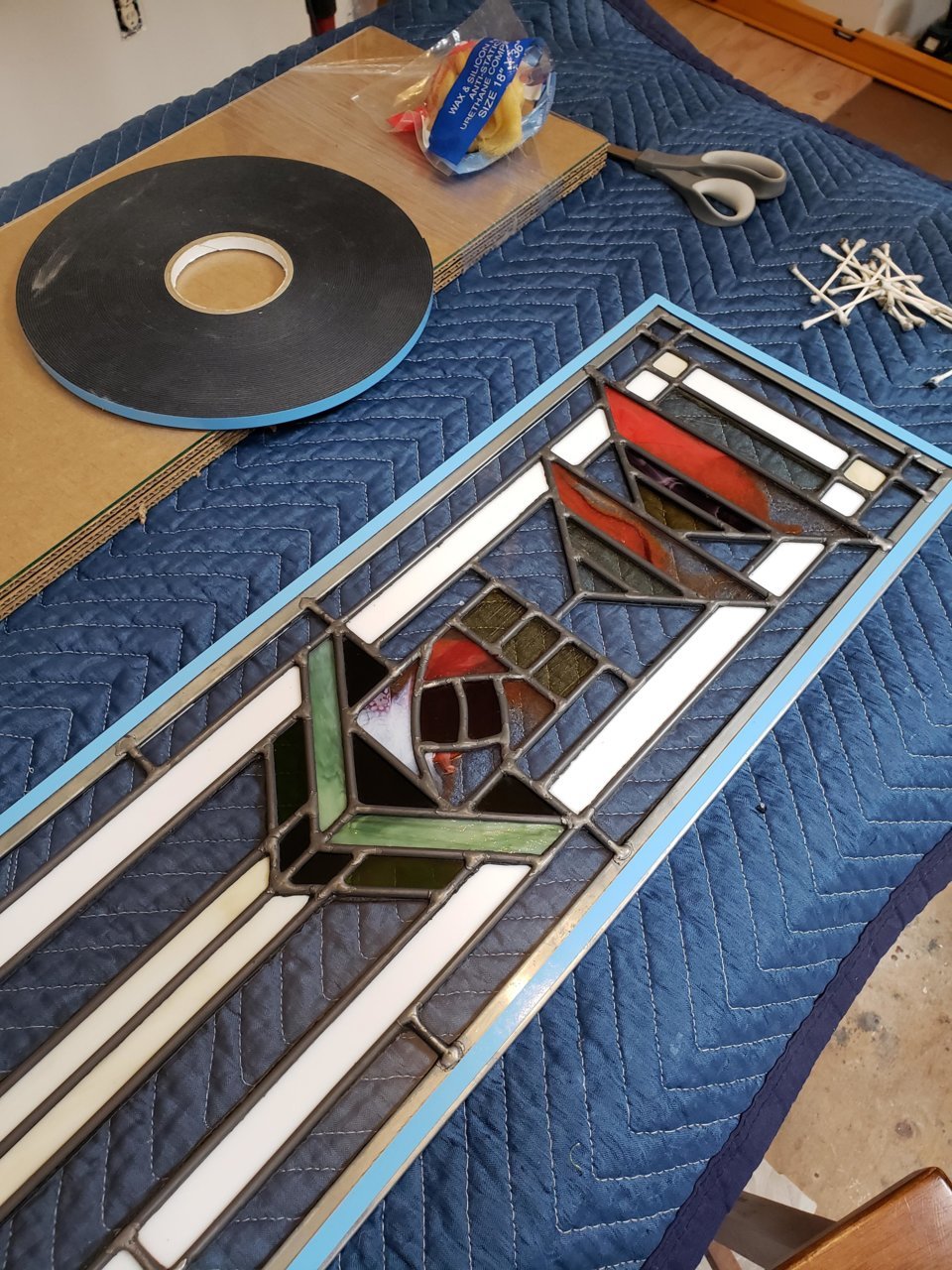

    My DIY Approach to Double Paned Stained Glass Windows
    I seem to finally have time to double pane/enclose my front door side light stained glass windows... probably not the recommended way....
    The most tedious part... cleaning the stained glass. Q-Tips, glasses cleaner and cloth.
    I'm using glazers tape to hold it all together...
    My wooden spacers... I'm telling myself it's a better thermal break...[The pros use aluminum channels with desiccant]

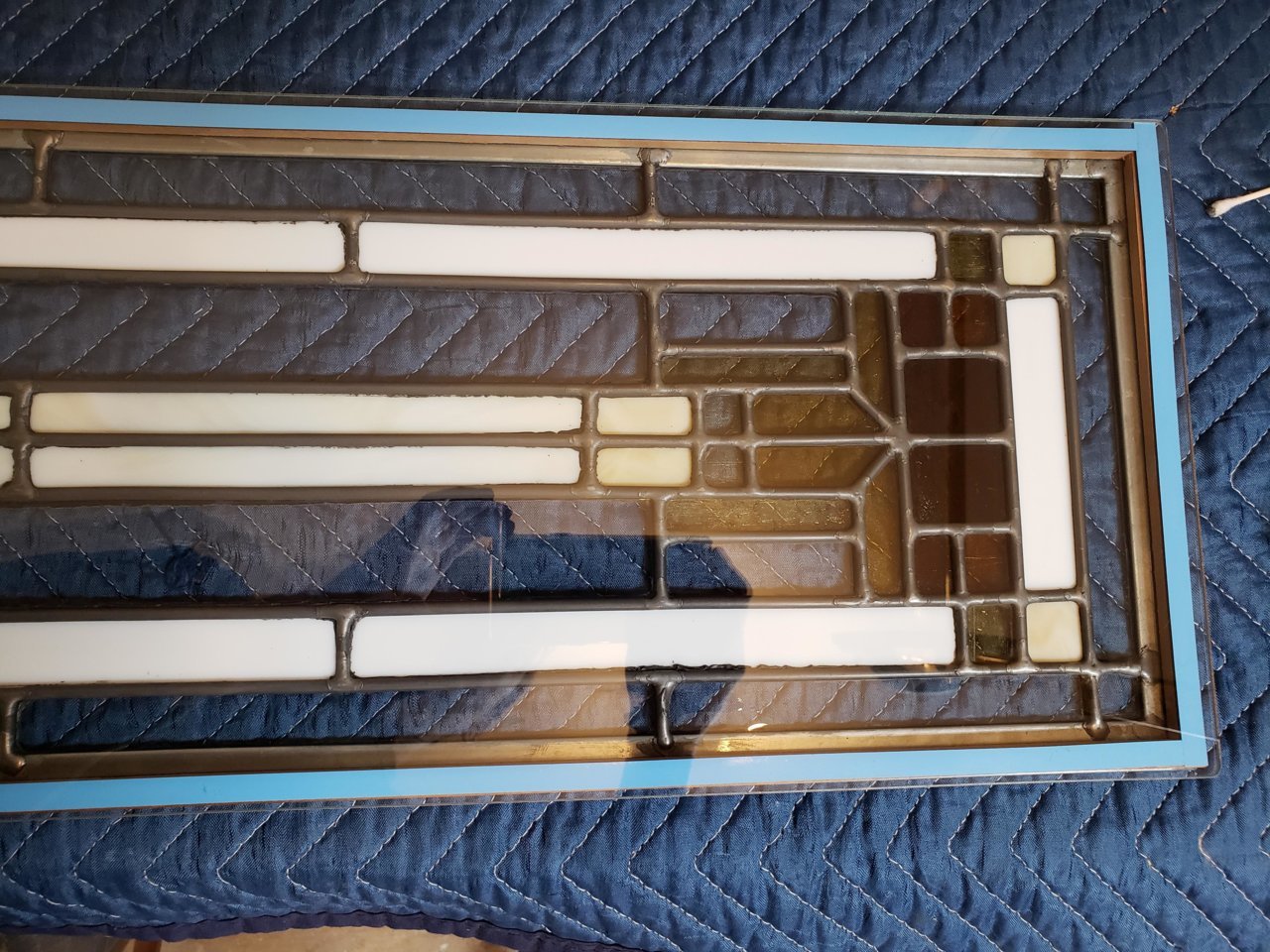

    So, this was the trickiest part... I needed to remove the tape covers and place the glass on top, in alignment. You only get one chance with glazers tape. I thought about a jig, doing it on it's side with a spacer... In the end, I asked my wife for help.20200328_4.jpg
    Now for the other side...
    So, the pro's have a, er, "tar gun" that oozes black goo around the edges. I'm using butyl tape.
    Then, I had to decide on edge tape... what did I have lying around... Foil duct tape?
    Going to install this one today!

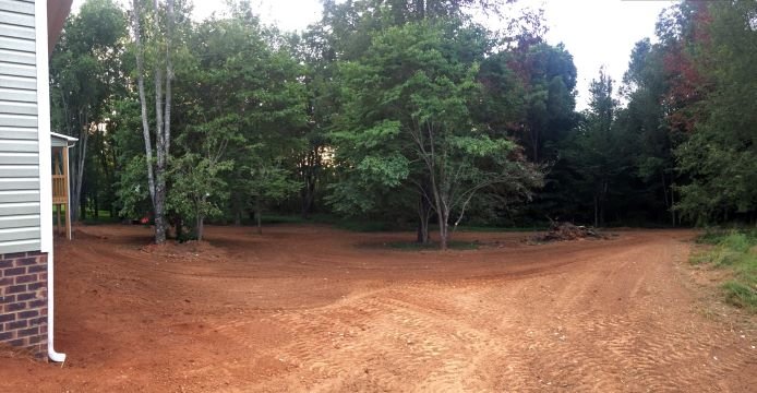

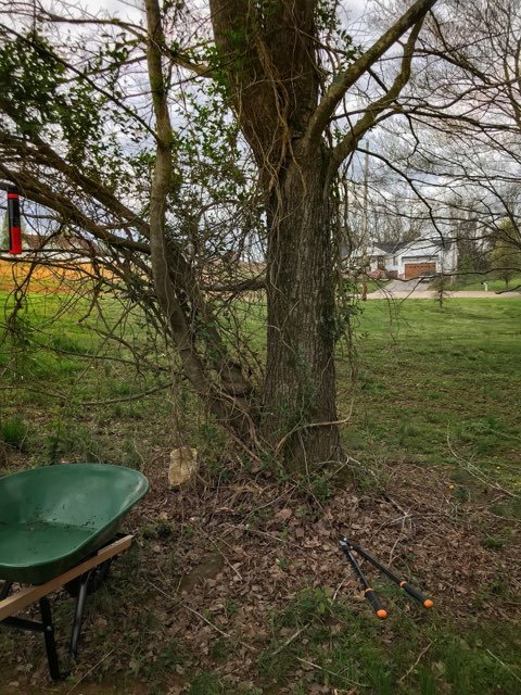

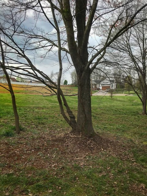

    Anybody else have an unhealthy obsession with their grass?? This is a before and after from a year and half ago when we built the house. I put down some fert this weekend and also got this tree beside the house cleaned up.
