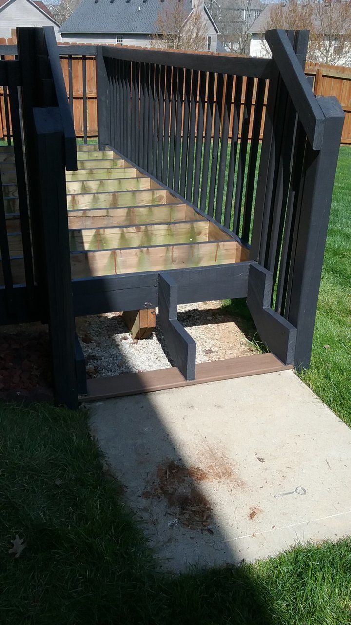

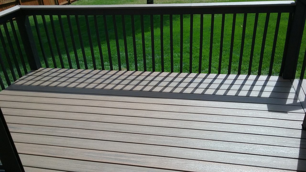

    So we have this small 10x12 deck that's 14+ years old. I've maintained it over the years...replacing a few boards and staining it and whatnot. But it had just become your typical tired old wooden deck. So I decided to strip it down and assess the frame/structure.
    Turns out the frame was solid...no issues. The stairs, though had some problems. Frankly I'm surprised they hadn't collapsed on the left side. Nothing but rot.
    The wife said she wanted before and after pix. She failed at the before. But you get the idea.
    So we cleaned up the frame and railings, stained the railing and posts black, along with all the joist tops. We also added some butyl joist tape to further protect them. I rebuilt the stair stringers. Not pictured is some additional structure I added between the stringers. The Trex composite decking requires a 16" OC. That spacing exceeded that.
    Next came the Trex composite decking in Sand Stone color. It has some subtle black streaks in it that compliment the black wood. I decided to pony up and use the Trex hidden fasteners. Very tedious. But certainly worth it. Where I couldn't use the fasteners, I used color matched Deckmate composite screws. These things are great. No splitting or mushrooming. I still pre-drilled each hole just to be safe.
    Finished product.

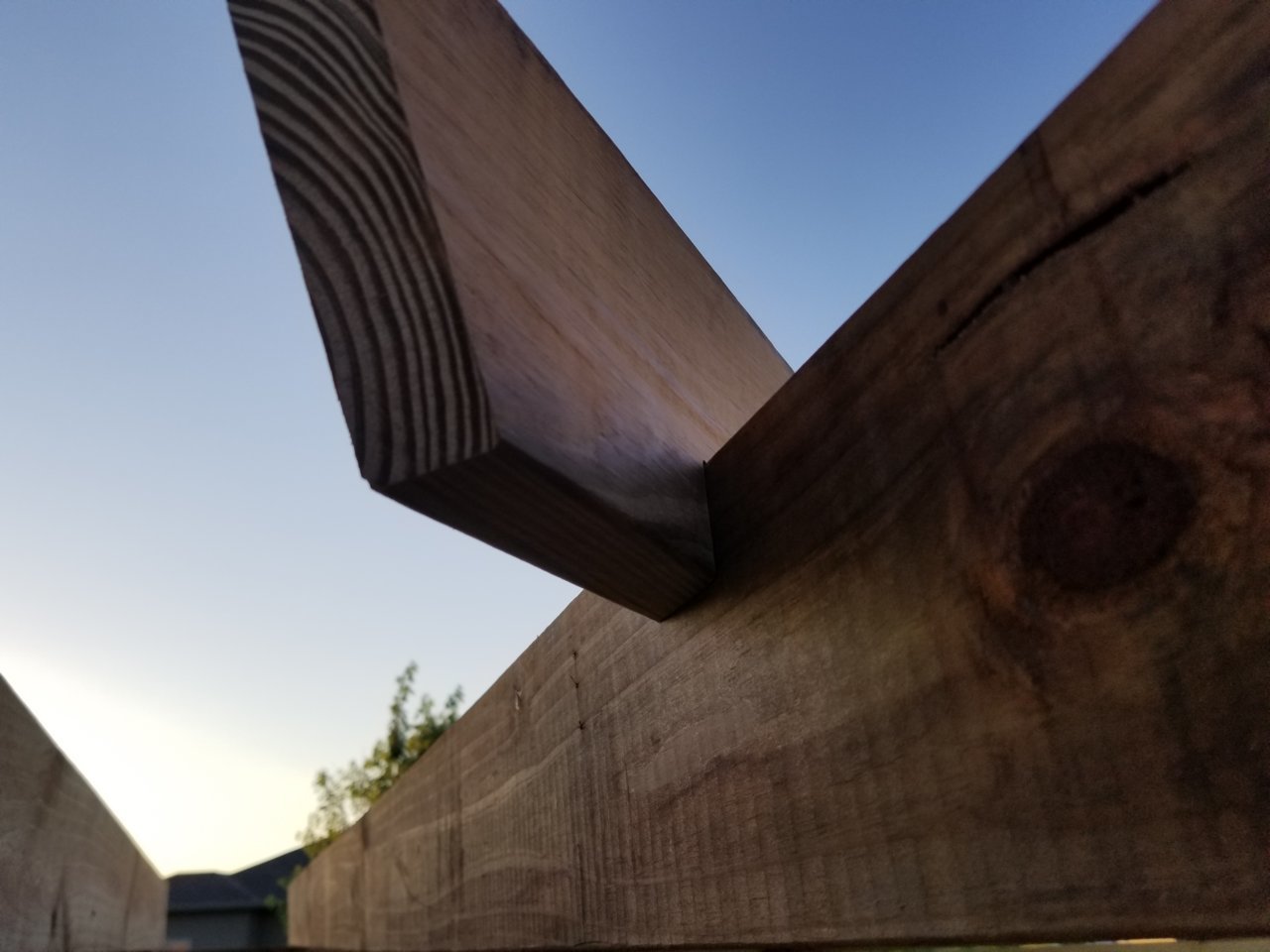

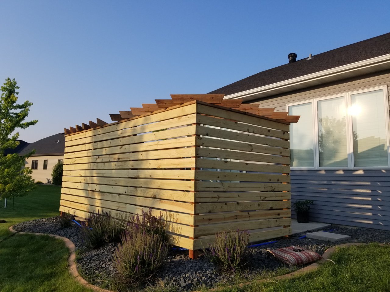

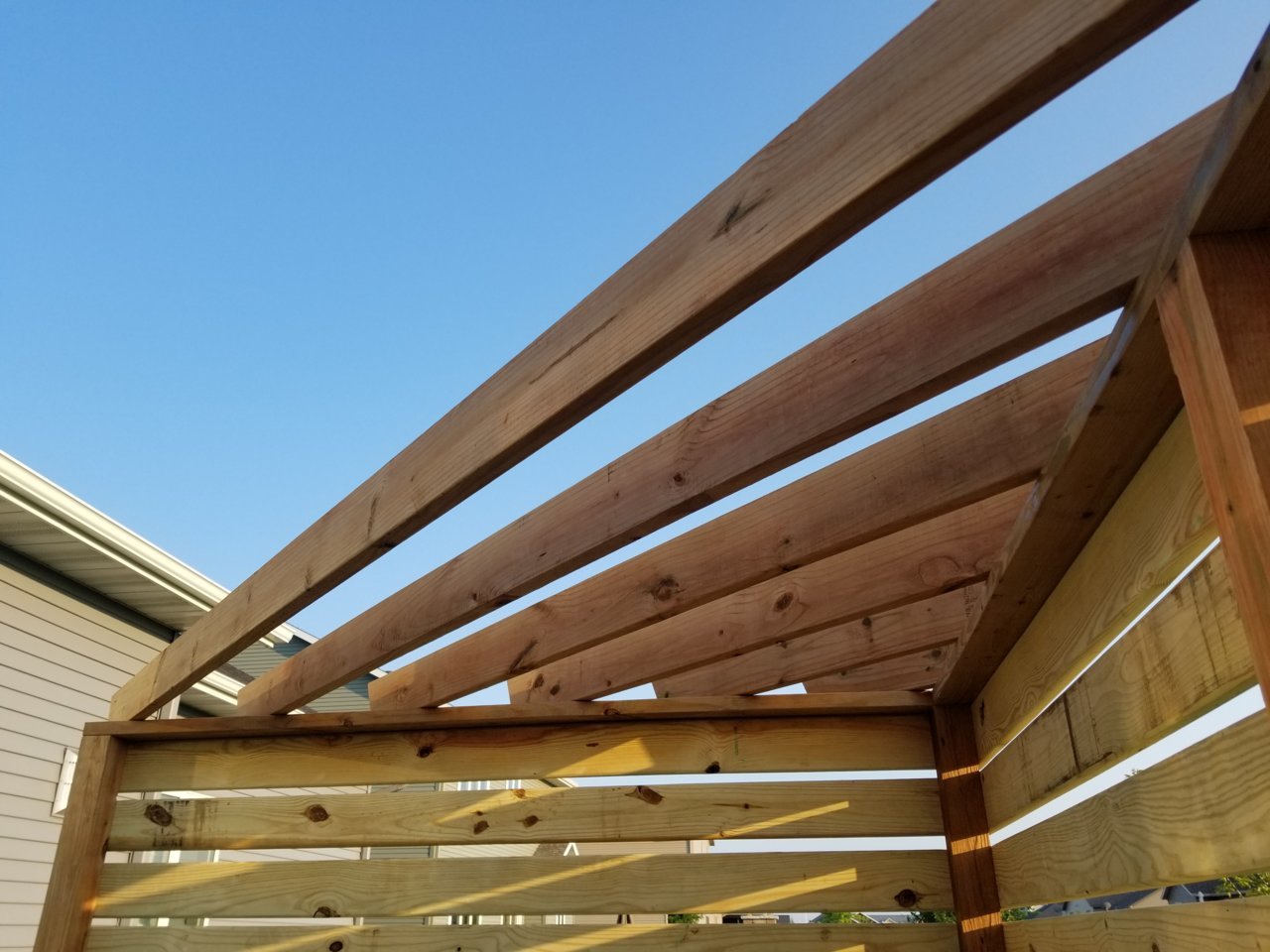

    I built a surround around my patio last summer, but since I wasn't a member here last summer, I'll post it now. :p
    The closest I got to before pictures:
    During:
    After:
    Details:
    Those notches were an absolute pain in the ass!
    I wasn't going to build this without having a switch for the string lights. Took a bit to figure it out bit it works great.
    The patio faces the west so in the evenings, it's absurdly hot out there with no shade. After building the surround, temps dropped about 15 degrees and the 5/4"gaps let plenty of breeze through still. I'm very happy with it.
    I have a few things to finish up, most shouldn't be difficult, other things I still have to draw up then build. Once the snow is finally gone, anyway.
