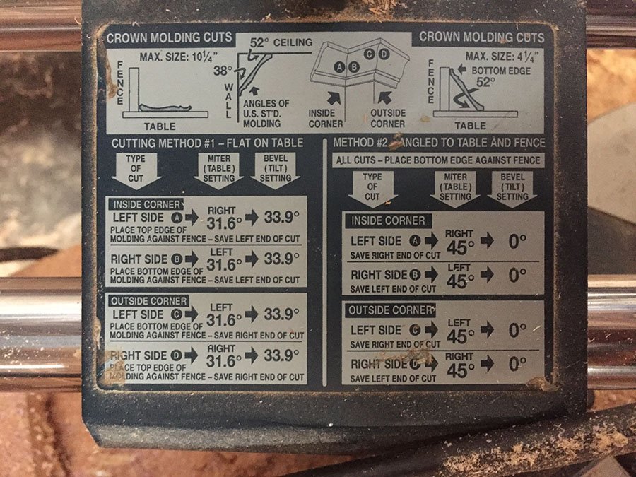

    Is your 45 degree cut actually 45 degrees? Two cuts will double any error you have in your angle and it doesn’t take much to make things not line up

    The saw is calibrated, and I’m lining it up on 45. That’s about all I can say lol

    It’s not a question if your saw is set right, it’s really a question of your actual wall angles

    Just cut it flat with the bevel at 33.85 and the miter at 31.62. There's lockouts on almost every saw for those angles. That's because it's how you cut crown molding properly. I've installed a lot of crown and I've never used a jig.

    My crown molding is “vertically nested” though, not flat on the wall.

    That's why they are weird angles. Here's a visual.

    Yep. Just google flat cut crown molding. It's how I cut nested crown. It's a compound cut. The numbers I gave you are for a 38 degree spring angle. If your using 45 or 52 degree spring angle those numbers change but neither is that common.
    https://www.protradecraft.com/video/cutting-crown-molding-flat

    ok. I think this is going to work. If I can wrap my head around it. I keep doing it exactly backwards on my scraps haha
