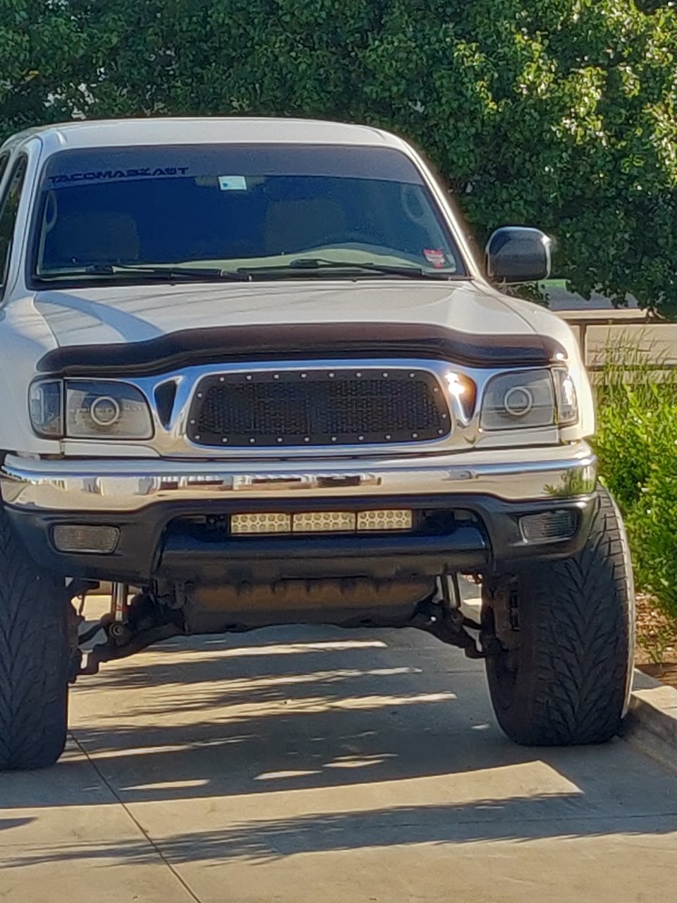

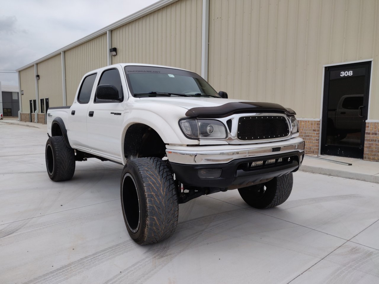

    Finished up a home-made grille I've been working on, figured I'd throw it on here.

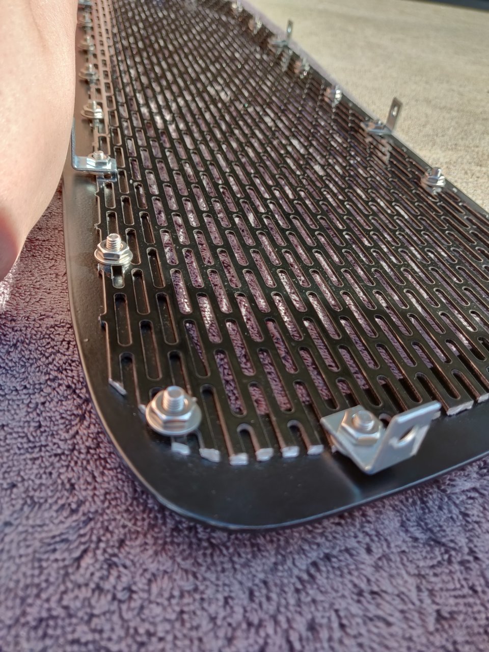

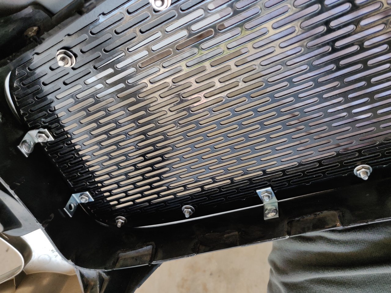

    if you ever want to share how you did it, I'd be keen to read!

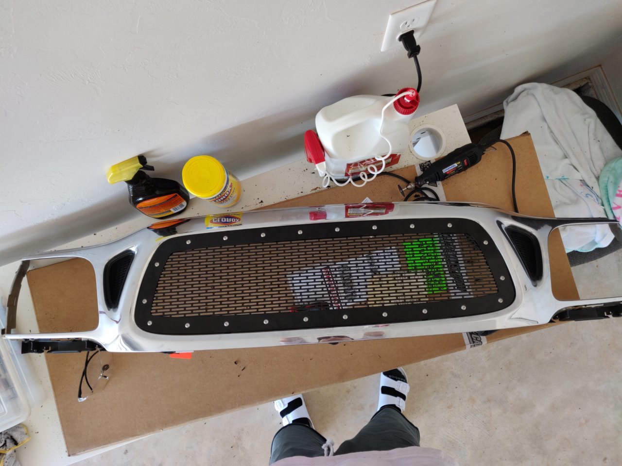

    For sure, had a guy with a cnc table cut the outer frame of the grille out. Then ran to the hardware shop and grabbed some stainless steel nuts/bolts and a handful of 1/2" 90° brackets to mount the new grille to the plastic shell of the stock one. Got the sheet of mesh off of @customcargrills website and went through about 15 cutting wheels to shape it to my new grille :sawzall: then just cut out all the plastic from the stock grille and drilled a couple holes, bolted the new one together and then we're gucci :woot:
    Edit*Forgot to add, had the outer piece powder coated satin black by local powder guy

    Looks great, how much did it cost you in total to make?

    I think all in about 100-150 bucks, I've gathered pieces for about 2 years and haven't kept track of what its added up to :rofl:
