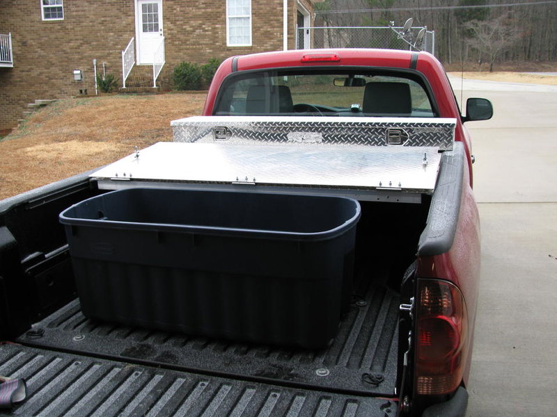

    035.jpgPhantom,
    I thought you had a great idea so I tried it myself.
    Found a site on the internet for the treadplate and had it cut in varying sizes to compensate for the fact that the bed is tapered.
    I found some T-Handles on the internet also.
    Got the 2x2 angle at a local place and pop-rivited some floating cage nuts on the angle.
    Found the plastic tub at Home Depot. The angle blocks the tub from moving very much. Add a gate lock and presto! I have a cap that will outlast the truck and it will keep my stuff secure.
    Cost was maybe $600 if you include the box.
    It was a fun project. I could get it painted to match my truck but I like it the way it is. It takes maybe ten minutes to remove and put back on.
