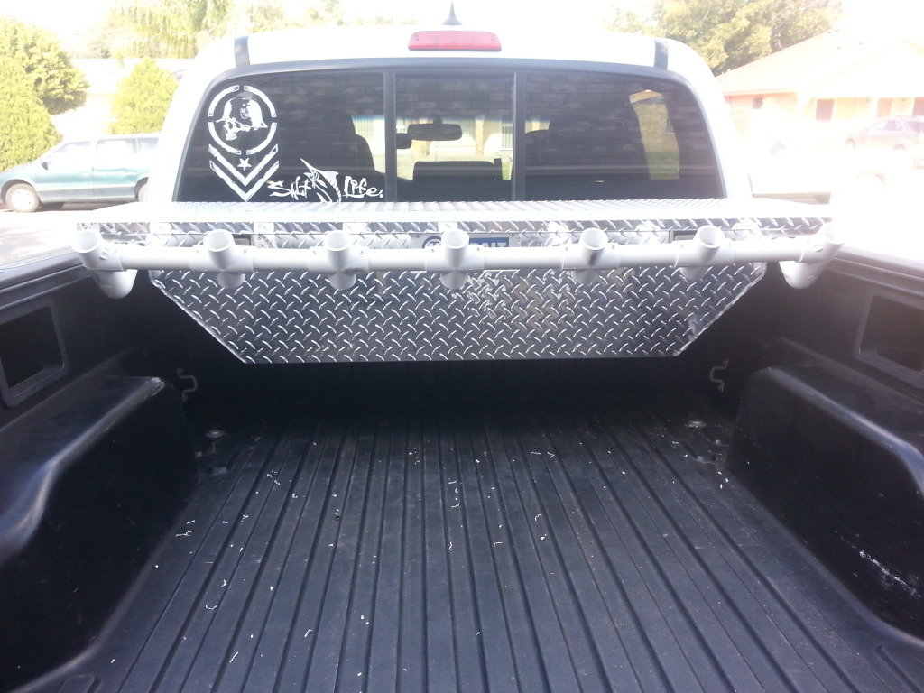

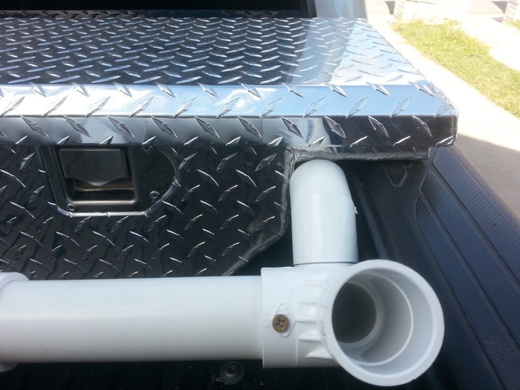

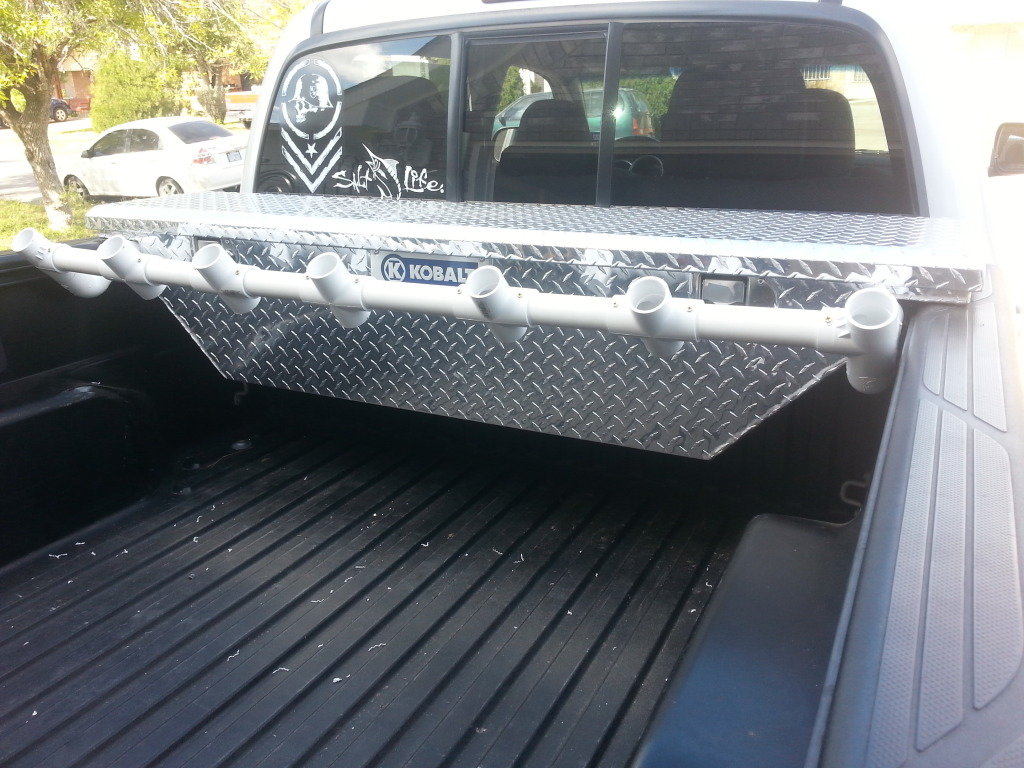

    Going fishing tomorrow and I have been wanting to make a rod holder for the back of the truck. Finally decided to make one. Let me know what you think. I used 1 1/4 inc pvc, 5 cross joints, 2 t's, 2 90 degree and 2 45 degree joints. I made it so i can easily remove it when i"m not using it. Its mounted to the bottom of the toolbox.

    Very slick, good job and use of PVC.
