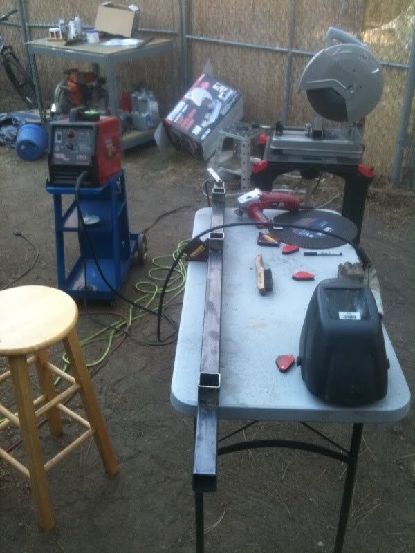

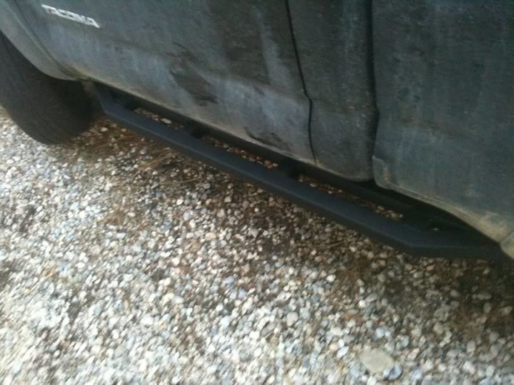

    Nice man, i like that set, whats the specs on the metal? How big, and what kind of heat are you using welding on those?
  6. Nov 28, 2010 at 9:50 PM
    Yoytoda
    Yoytoda The Little Truck That Could
    Oct 2, 2009
    #23690
    4,947
    Roland
    Big Bear,CA / Upstate NY(Saratoga)
    2010 Tacoma Regular Cab 4x4
    completely stock
    2" square 1/8" wall for the sliders, 3/16" plate for mounting plates and gussets
    i have a 140A 120V wire feed lincoln welds up to 3/16"

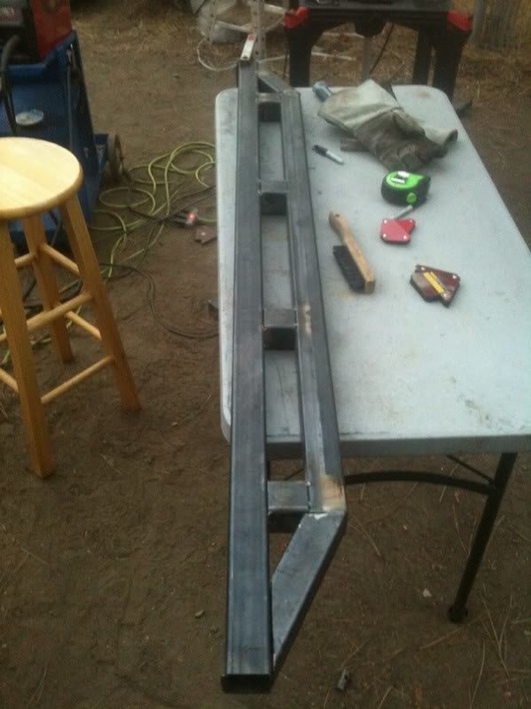

    i welded them on first... should have welded the sliders to the mounts then to the frame... it was a pain to weld all around the sliders and put in the gussets on top

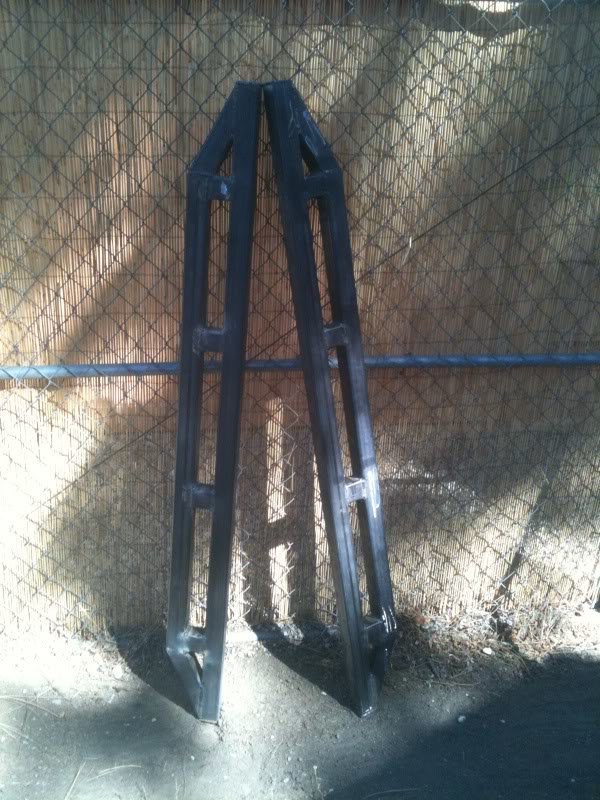

    How many supports do you have going to the frame?
  11. Nov 30, 2010 at 8:10 PM
    Max-4_Yota
    Max-4_Yota The Welfare Cadilac
    Dec 10, 2009
    #27357
    4,245
    Michael
    South Carolina
    04 Tacoma 4x4, V6, 5spd
    Squattin'
  12. Nov 30, 2010 at 8:24 PM
    Yoytoda
    Oct 2, 2009
    #23690
    4,947
    Roland
    completely stock
    4
    most reg cabs have 3 but i did 4 and they are seriously rock solid...

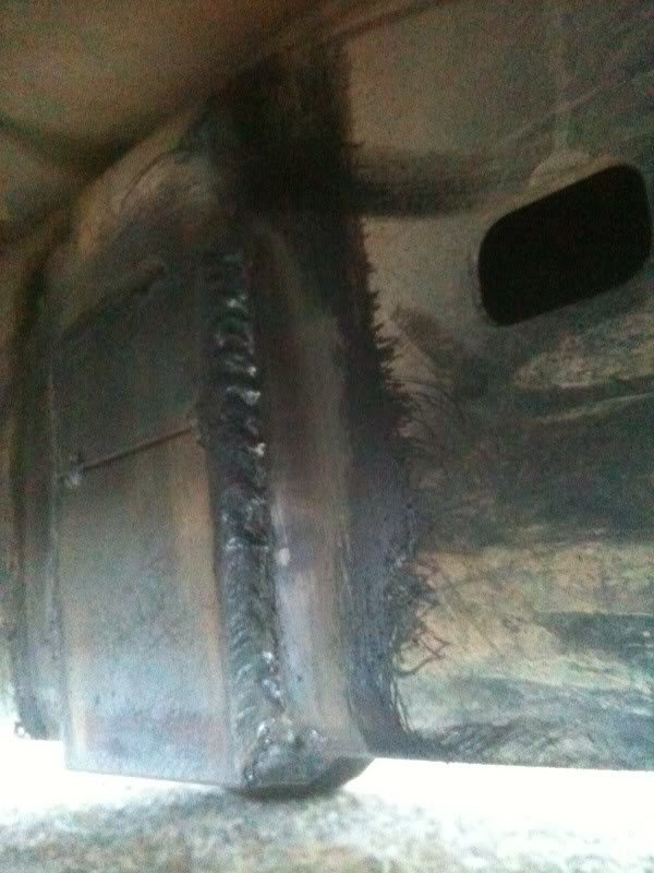

    i used angle for the frame mounts so the mounts went under the frame, look at pic above.
    3/16" is plenty. the frame is only like 1/8" think so 3/16" is already tougher than the frame itself...
    i also bought a 2"x3" angle scrap about 36" long and cut 8 4" wide pieces for brackets. also bought 3/16" thick 3" wide strap for making upper mounts (notice my mounts are 2 pieces welded together) and cut 3" triangles from the strap for gussets
    bought a 12" square 3/16" plate too for misc. crap. hade to make a mount on for the rear most support because the frame curves up. ill get a pic for ya tomorrow

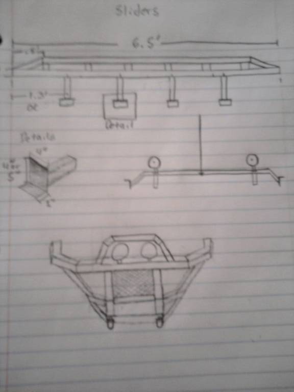

  19. Dec 2, 2010 at 9:37 PM
    #19
    01tacoprerunner
    01tacoprerunner [OP] Lifted 'n Locked 4WD Prerunner
    Jun 5, 2009
    #18077
    3,265
    Brian
    Raleigh, NC
    01 4WD Prerunner with No-slip locker
    4WD Conversion, No-slip locker, 5100s set at 2.5" and shackles in the back. Black 2nd gen rims, and Courser M/T tires, Bull Bar,Fog lights, UWS toolbox, CB Radio, Fiberglass antenna, 2nd Gen Badges, Deck Plate Mod, Diff Breather Mod, Sockmonkey decals.
    Some plans i drew up for the sliders, and a bed bar and a front bumper. The bumper looks kinda crappy but ol well it wont be made anytime soon.
  20. Dec 2, 2010 at 9:51 PM
    #20
    steve o 77
    steve o 77 braaap
    Nov 29, 2009
    #26726
    19,954
    Steven
    In a corn field, OH
    1990 Chevy Siveraydo
    245k+ miles, rust, working AC, bald eagles
    nice, If you feel like it sketch up is fun to make 3D drawings of things. Plus its free.
