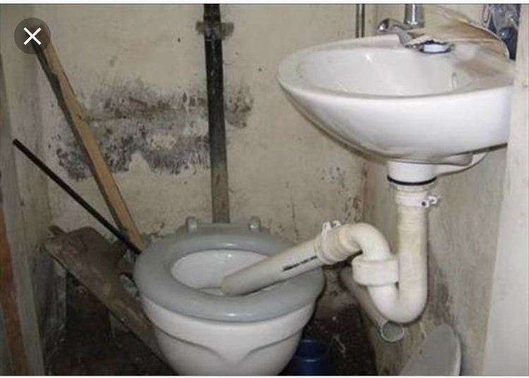

    upload_2019-10-16_12-18-18.jpgWhen I see stuff like this, I may differ from helping
    Silentshredr and wilcam47 like this.
  10. Oct 16, 2019 at 9:22 AM
    #30
    TRD-ED
    TRD-ED [OP] Well-Known Member
    Sep 12, 2016
    #197086
    3,147
    Lenoir NC.
    2020 Army Green TRD PRO - 2023 Genesis GV70
    Stock FOX 275/65/18 At3w 18X9 Fuel Vapor's
    Makes you wonder why they even took the time to use a P trap.
    wilcam47 likes this.

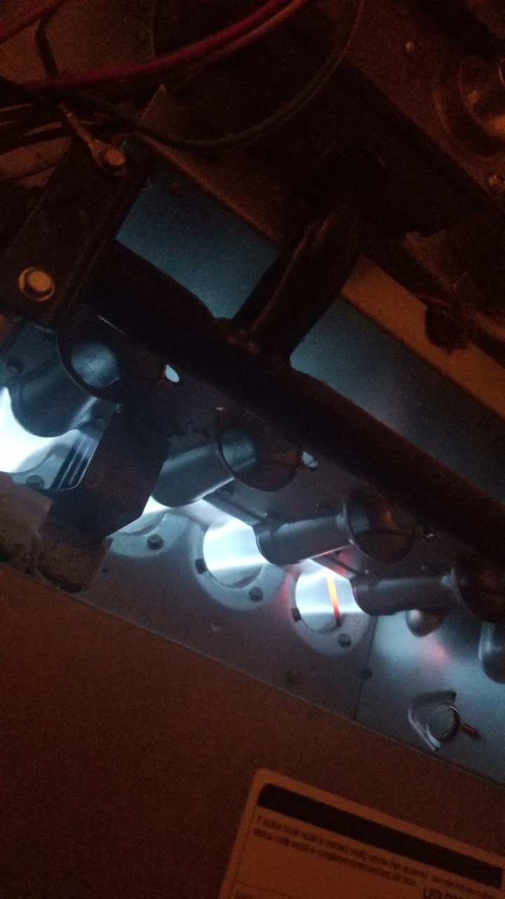

    Today is that day. I turned on the heat Friday morning to take the chill out of the house. There was a faint electrical buzz but no whirr of the inducer motor, no spark, no gas, no heat. Well shit.
    I'm guessing the inducer motor is on its last legs, since it's the one giving that groany electric buzz.
    As per the helpful label on the furnace cover, I turned the gas feed switch off for 5 minutes, turned it back on, gave the inducer motor a hard rap with my wrench, and then called for heat on the thermostat.
    The motor spun up immediately, and four bright blue flames followed. :yay:
    That was definitely my warning sign though. One fifty dollar replacement motor (thank you Amazon) is now on it's way.
    wilcam47 and TRD-ED[OP] like this.

    It's probably a bad start capacitor which you may or may not be able to buy for a lot cheaper than a whole motor. I personally would bench test it and keep it as a spare.
