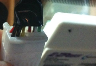

    i think we've figured out that im missing a pin...
    on the right in this photo, below the green wire, is a missing pin... thats supposed to be the power to the Homelink module im going to put a pin in there, and tap it into the overhead 12v...

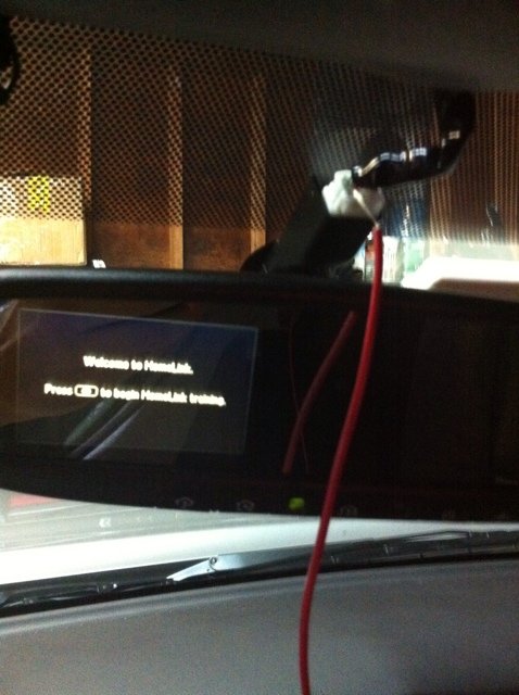

    Okay we got it...
    i put 12volts to the slot above the green wire, and the homelink now works... now i need to get a pin in there, and t-tap it to 12 volts above the overhead panel...
    anyone have a wire color up there i can t-tap for 12volts?

    for those searching...
    i t-tapped a wire into the white (not the white w/ black) front over head map light wire and dropped a female pin into the wiring harness. went to radio shack, purchased a pack of female pins, attach it to the wire, you can just push the pin into the factory harness above the green wire in the corner, theres no need to take the harness apart. Now the homelink module has power and will fully function.
    the only important note with this set up is: the homelink will have always power (as the map lights do). which means the truck will not need a key in the ignition for the homelink to function and your garage door to open. example, someone smashing your windows then activating the homelink to open your garage, which would be the same thing as someone smashing your windows and grabbing your clip on battery operated opener and using it.

    Thanks for posting what you found really helped with the install of my gentex. I had the same problem. Factory harness did not have power going to the number 8 slot.
