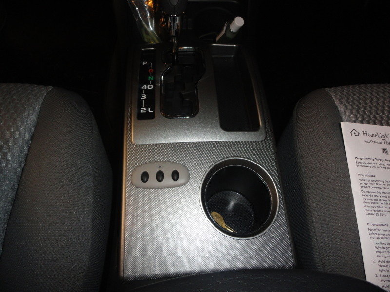

    A half what? Or is that 1 to 2.... please specify units.
    Anyways. Nice install!
    I really like the placement.
    The other good thing is that now you have 12V down there. I originally ran a 12 volt line to that area to power my CB radio. Since then, I have made the wire much thicker and use it to power my in cab inverter and to power the actuator on my rear center window as well as some other things.
    It is fused under the engine, but I'm about ready to have a small fuse block under there haha.
    One more tip, if you really wanted to over do it, you could color match the homelink to the trim, or wrap it in some 3M rap of some sort. Don't get me wrong though, it's a great install.

    Thanks for the tips.
    I thought the grey would be darker. I can always spray the homelink cover a darker grey.
    The shifter bezel just snaps in. No biggie pulling it off.
    The HomeLink module is fairly big. There is not much room to move the buttons back any further.
    There are some ridges on the bottom side of the shifter bezel that I had to grind flat to make it all fit.
    I should have taken pics along the way, but I was in a hurry to get it done.
    It won't be nothing to remove the shifter bezel and take some shots, if requested.

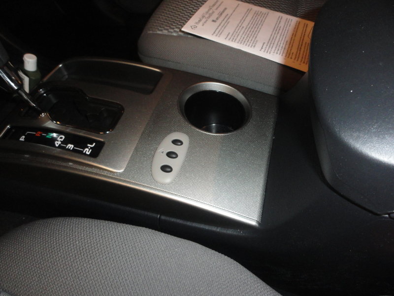

    HomeLink works really well. I can open the garage from 40 feet away. that proves that the HomeLink does not have to mounted in the headliner.

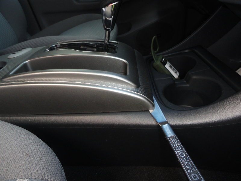

    To pop the shifter bezel off,unscrew the shifter knob, insert a butter knife into the gap at the front and lift up on the handle. Then gently pop the bezel off.

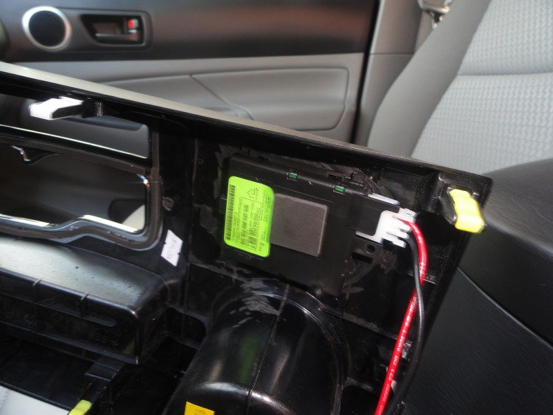

    Here is a shot showing the HomeLink module and where I had to grind the ridges off the bottom of the bezel. I put some RTV silicone on top of the module to hold it to the bezel.

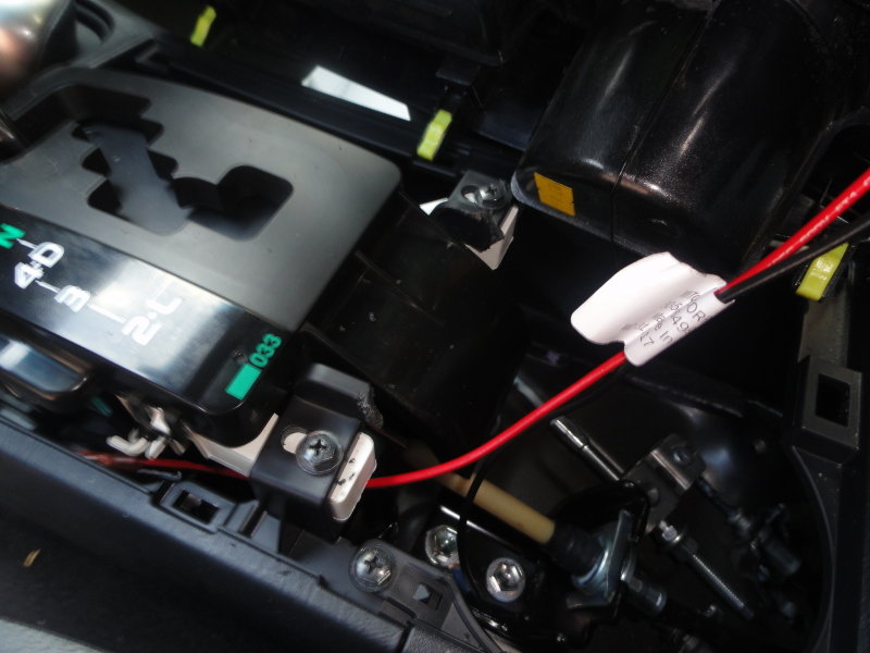

    I did have to remove the plastic cross brace across the back of the shifter housing. Shown below.

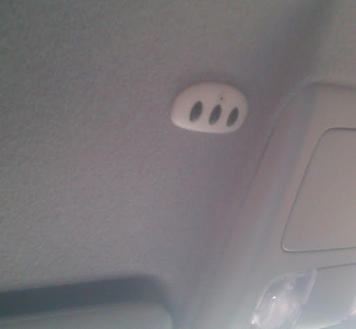

    I did the same thing but I cut mine into the headliner. More logical location IMO since most people are used to looking/reaching up plus constant power was right next door in the overhead console for easy wiring.

    Yeah, hole cut in headliner for buttons & then snapped back together sandwiching headliner then wired.
