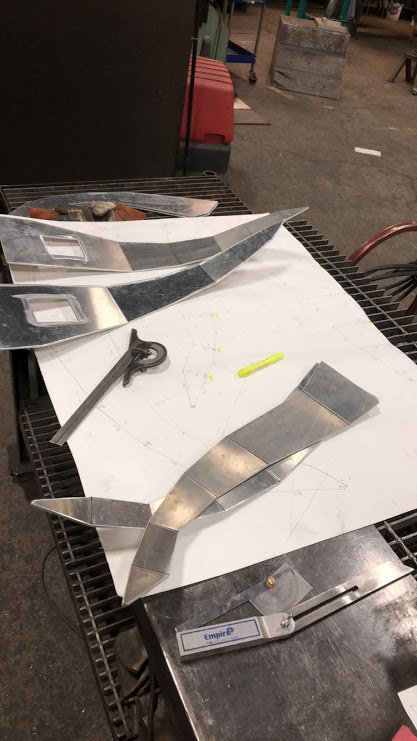

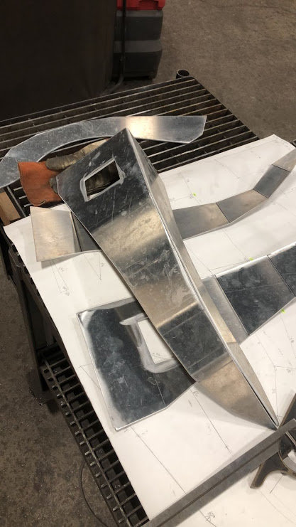

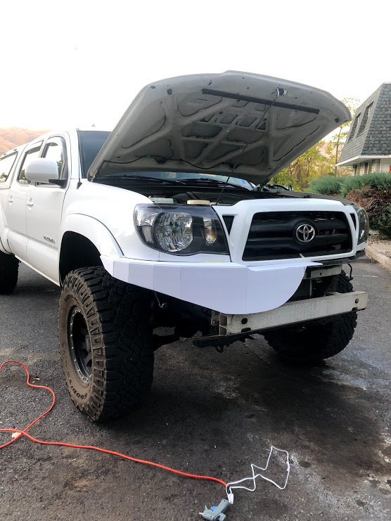

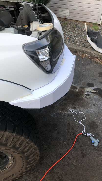

    Started building a front bumper for my 2nd gen. It will house a winch and possibly get some sort of grill guard but havent decided yet.
    Design stages. Hot glue and foam poster board.
    JGz31yyROrwYBuga5Nrd87ZsXRA8XX1XB6kXc--W_a31635b683090562c805117b44dada0ebd727704.jpg
    6dl2BdbOLNS0l23ovchAwrwCNp9dRbH9apZxulTL_afa4a5b20ebbf168b8ccea5dd342f487ba7a269f.jpg
    RpiHz1E2E5S0d-h646cAmlM6iRCBs5a3dLst85QV_06197d48d2ae44136d00bc1a8cf4714ef38df315.jpg

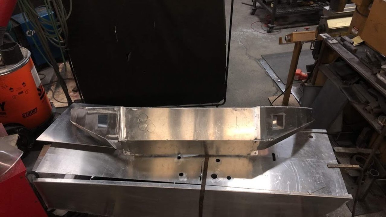

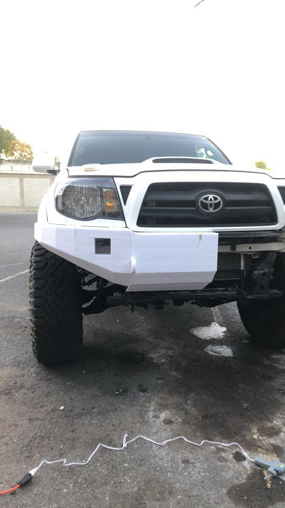

    Here is the final prototype.
    rSkwwhqfQtKCsnmN2lQqZ8qTG_M-FZcx4NQSNqv7_ff02c5efa3eadea78c2f08607a1164077a703839.jpg
    VmOvvm4ewohPHkERlo9j4djToCmlpjxFsa9rbYf5_7345be740c57900d01686c05a5783fada5f99631.jpg

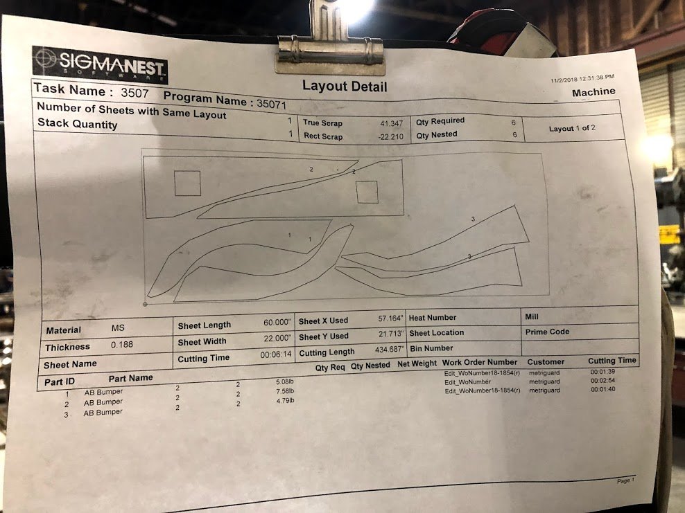

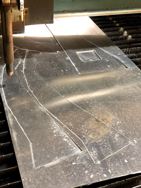

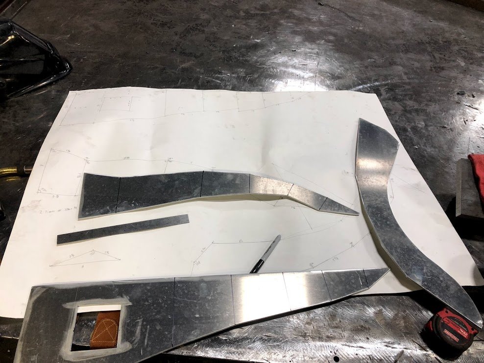

    Measured everything up and input it into autocad and nested it all for our cmc plasma table.
    l9iEASB9aDDMlTz4iRR2ypTG5vu1cAnA6_9jlXil_9dc5fbec2e6ae77eb5fe61e417ab55d7965030f8.jpg
    Load the file and hit the green button.
    f52CAAxePKU9YmIdtOWF_nSByw43x-ciVZbJnZf-_5bf78f8a0a8c4ccd816096b949c60c70600b9dc5.jpg
    Lay out all of my break lines for the press.
    je5wUyIO6D-4O-A1DEq3Ecc2QfMYrZ46KgQ1egsC_940663ef915040720fa3ebb23baf73001aaa93d2.jpg
    This is where I am now. Let me know what you think!

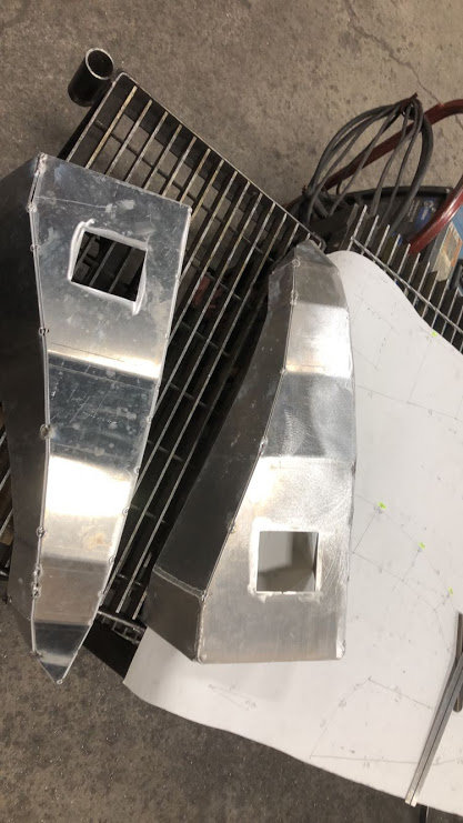

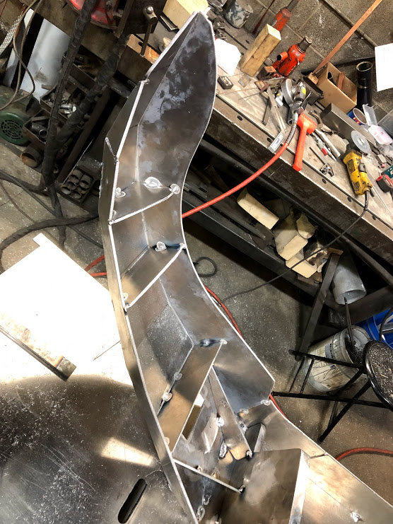

    Got the pieces broke and tacked together tonight. The material is pretty dirty so the welding part will be interesting.

    Might make some more progress tomorrow.

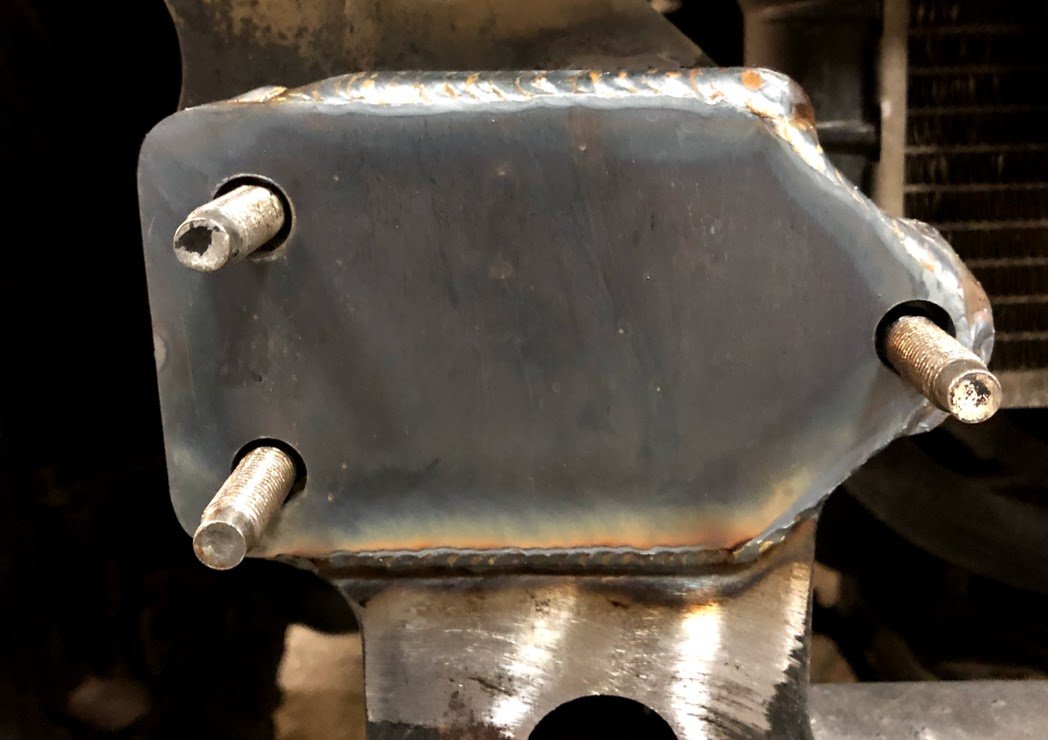

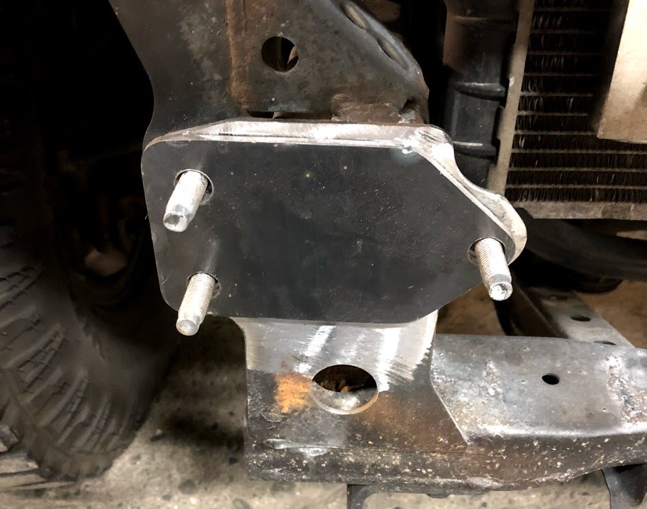

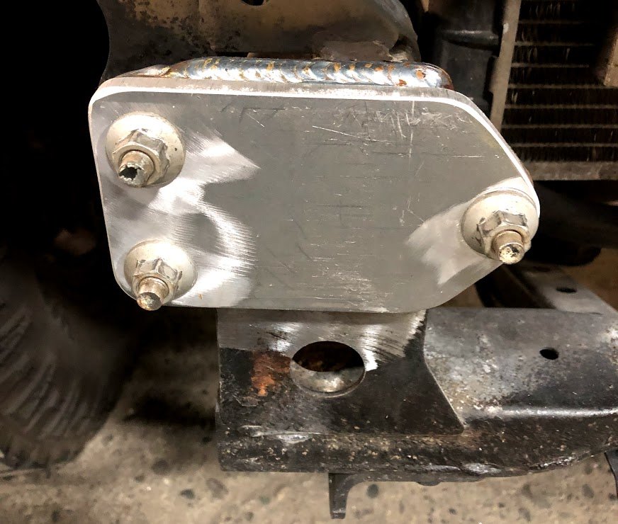

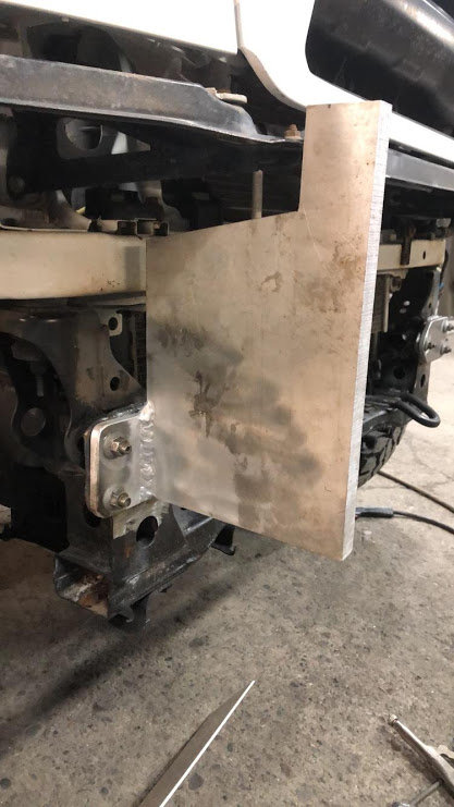

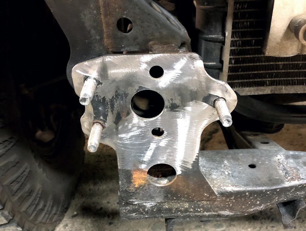

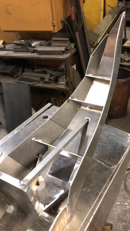

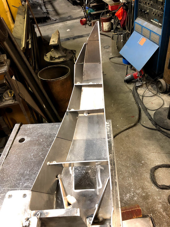

    Update! Got the stock mounts stiffened with some 3/16” plate and got my mounts made out of 3/8” and 3/4” plate and the front and one side put on.
    Ill let the pics speak for themselves.

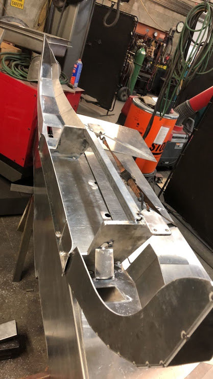

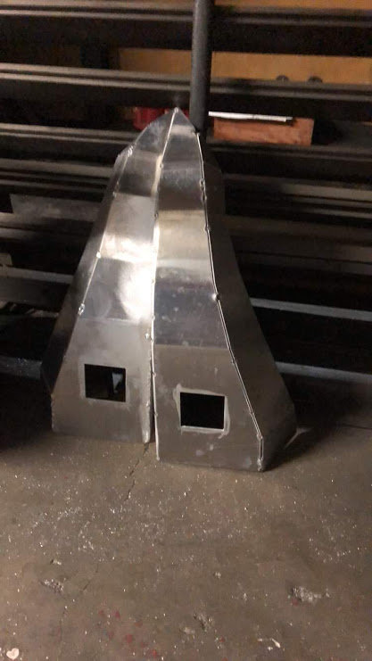

    Its starting to look like something now not just a bunch or pieces!!
    Got the back braces figured out and more of the center piece put together. Still need to dimple die the lower part and cut access holes for the winch in.
    The winch plate will be a tight fit but should work just fine. I'm very happy with how its looking so far.

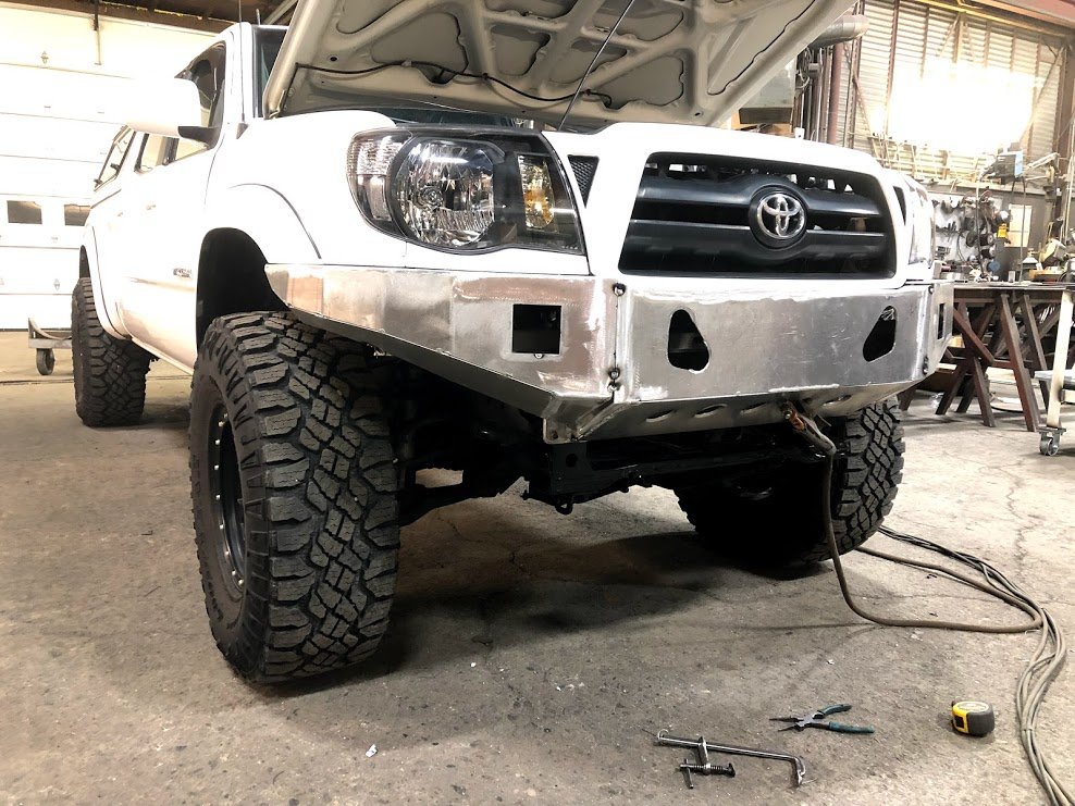

  13. Nov 24, 2018 at 10:06 PM
    6 gearT444E
    6 gearT444E Certified Electron Pusher
    Feb 3, 2018
    #243372
    7,798
    Deep South
    Herculiner Hootus

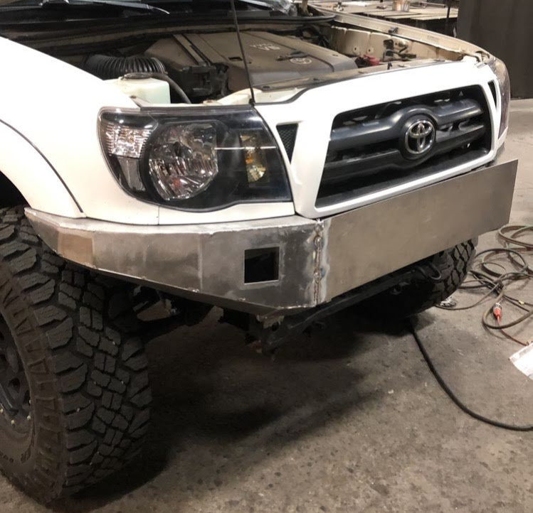

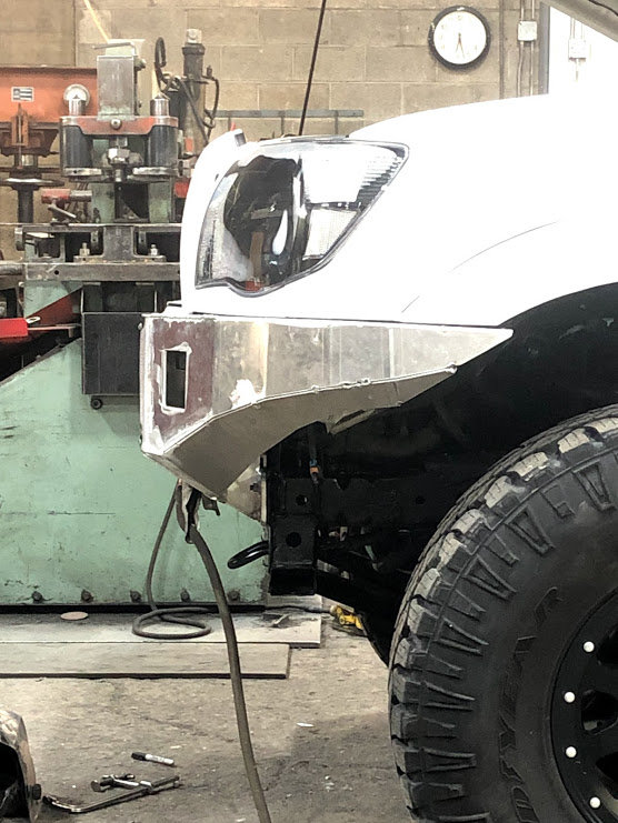

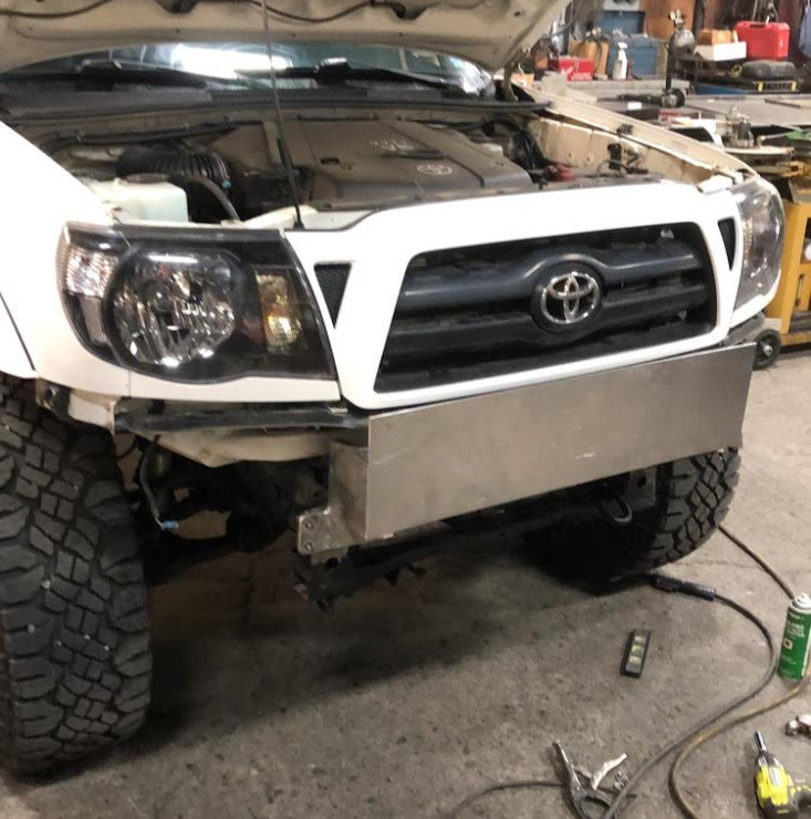

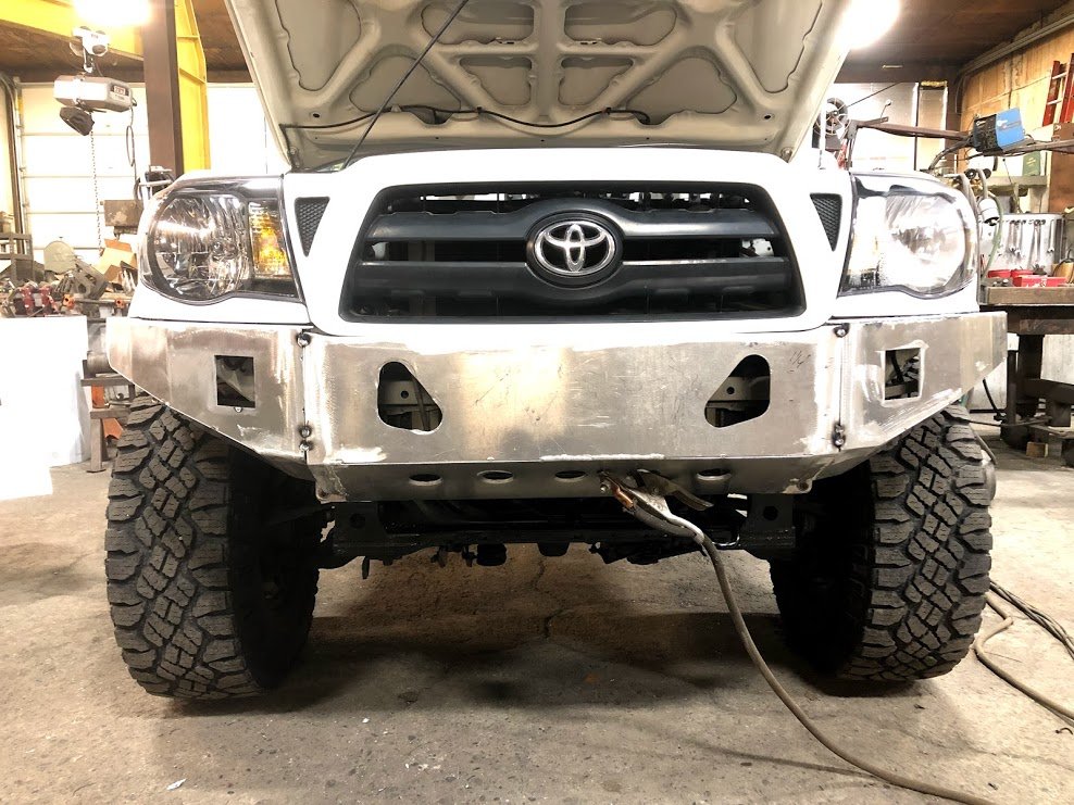

    Look nice, might want to leave more of a gap between the bumper and fender though, otherwise you'll crinkle that fender when the body flexes. Good job reinforcing the mounts from the get go!
    CanisLupus and whiteyotaguy[OP] like this.
  14. Nov 25, 2018 at 7:21 PM
    whiteyotaguy
    whiteyotaguy [OP] Well-Known Member
    Jun 24, 2018
    #257372
    55
    2007 DCLB Sport

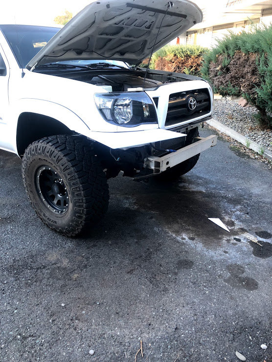

    Thanks! I ended up moving it down about a 1/4" from the last picture with it on the pickup. I looked into a lot of posts where people had either hit things or pulled things too heavy with there aluminum bumper and the mounts always bent and the bumper tore so I decided to just over build it to begin with.

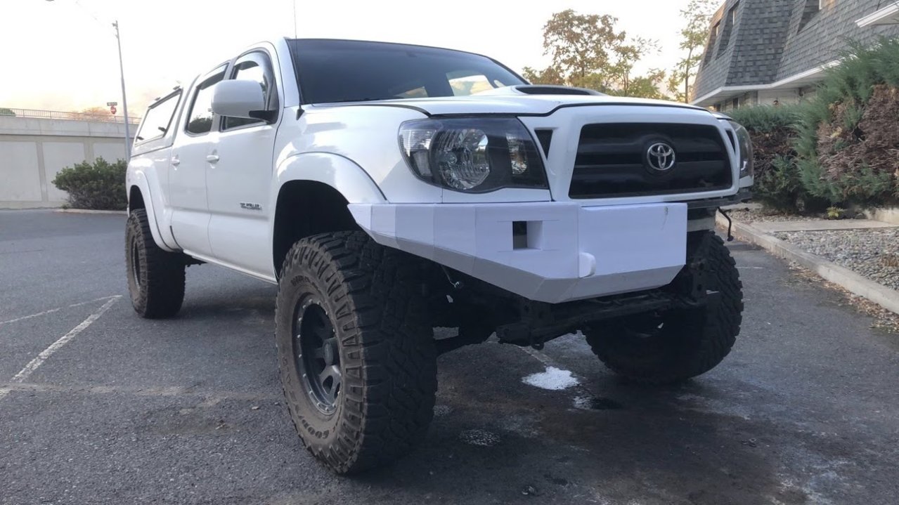

    Got a little farther on the bumper. had to cut it all the way apart and make some adjustments but got it looking the way I want now. Yes you can still fit a winch in there.

    Looks like Baja or Ridged pods will fit in those square openings nicely

    That’s the plan with amber covers!
