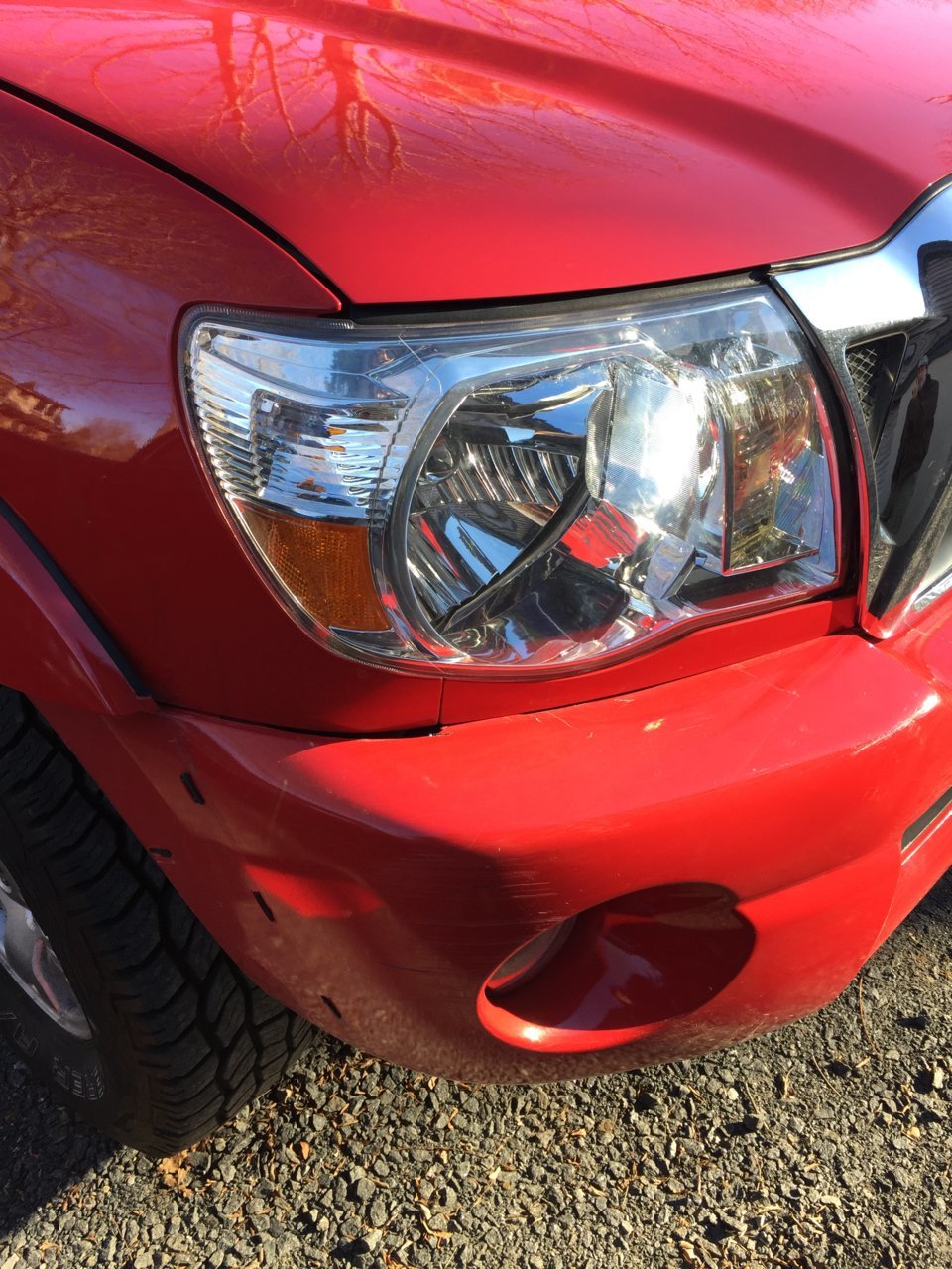

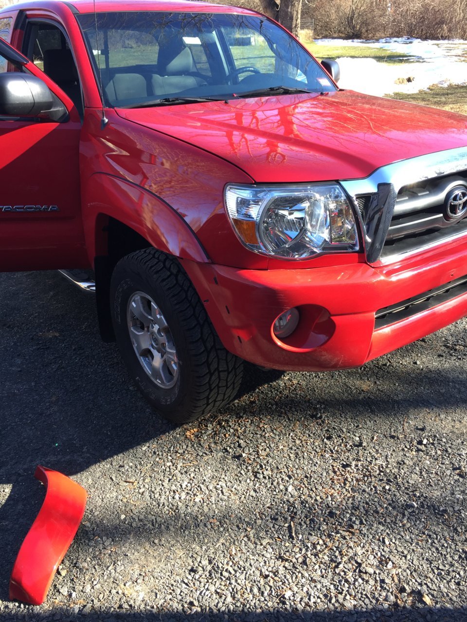

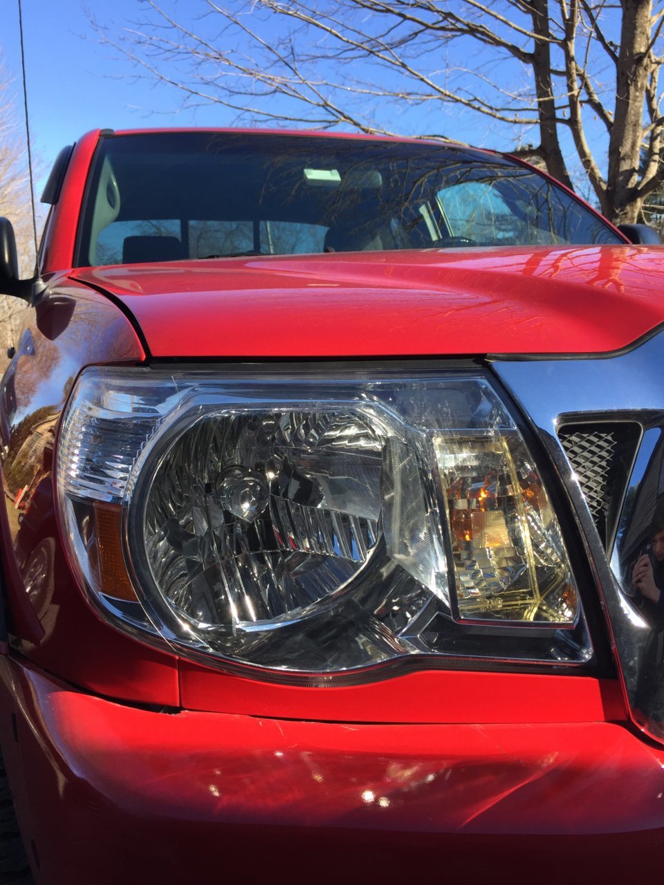

    damn im jealous... i hit at boxer (probably like 45-55lbs) at 15mph and my stock bumper is much more fucked than it should be. (dog is ok dont worry) headlight and grill and metal fender are all misaligned. headlight points at ground in front of car now. here are pics7025C430-DFCA-4731-900E-B898E6BB61DF.jpg4DB8CAFF-7001-4714-8468-5920644CA9C4.jpgD3AC0D69-5D6A-4D49-B805-5D99753A6C0D.jpg

    Bummer. The front did exactly as it was designed to do, unfortunately.
