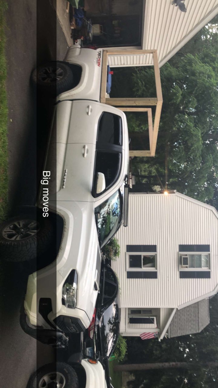

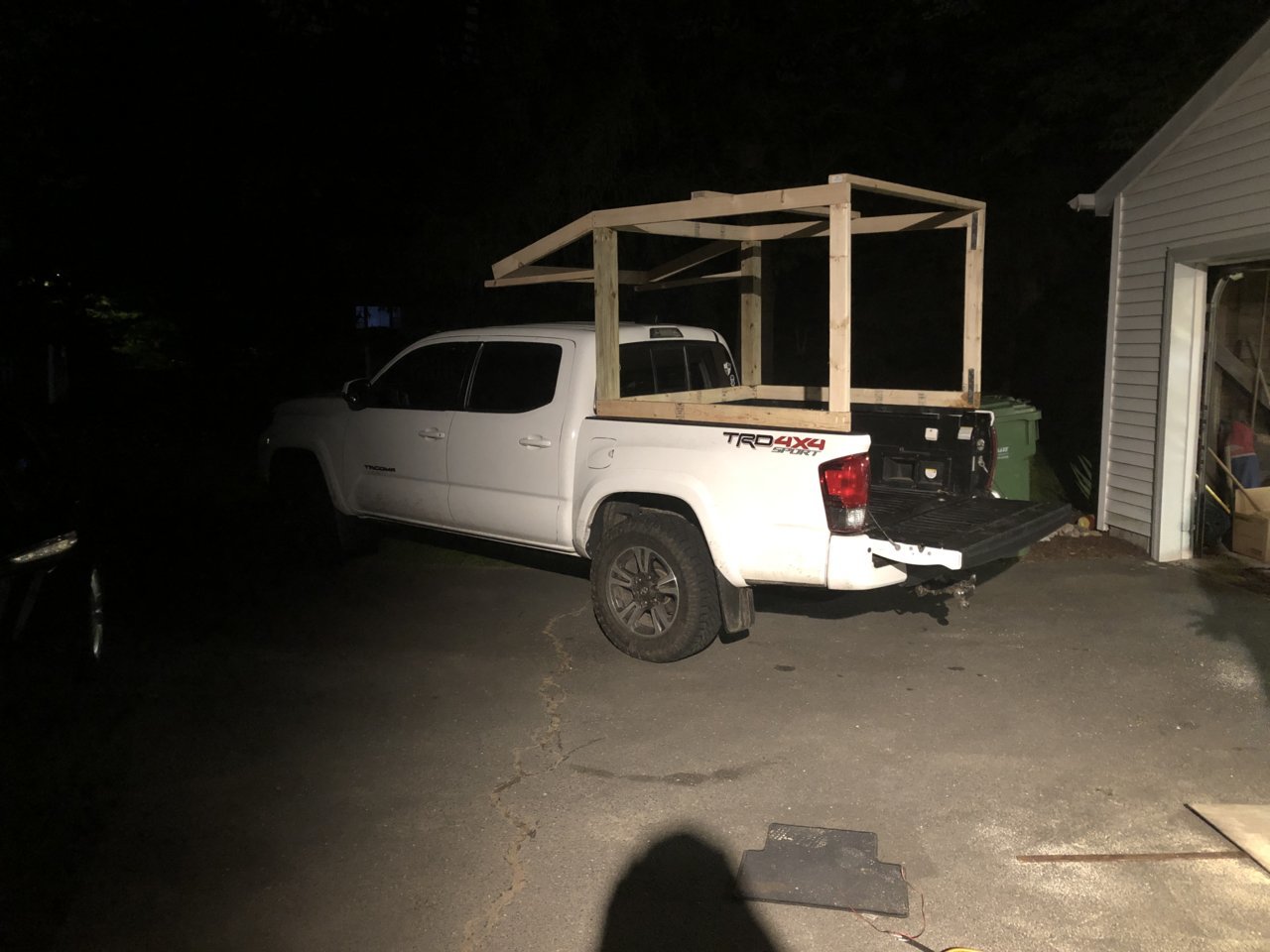

    Making this custom cap out of wood and then putting metal siding on the outside but for the front over the cab I think I have to lower it and I might make it just a rectangle or should I lower it and then make it angled on the top. All ideas are welcome I need to finish in less then 3 weeks going on a 22 hr drive to Florida with a few other guys.

    I'd say make it small and level with the cab, just based on your time constraints

    I would lower it and make the valence up top flush with the cab. Or at least have a fairing so you essentially don’t have a giant sail.

    The weight.of that thing will negate any savings you have in the increased cost of the fuel.
    Buy a used one. Drink a beer.

    There are lots of plans online, just google it. Most use 2x2’s or aluminum, and a lot of framing, 2x4’s are overkill if you frame it correctly. Also sheet it with ply and use lightweight aluminum over it to finish it. Good luck, these things take months to do right!
    Perhaps a softtop camper would be a cheaper option?

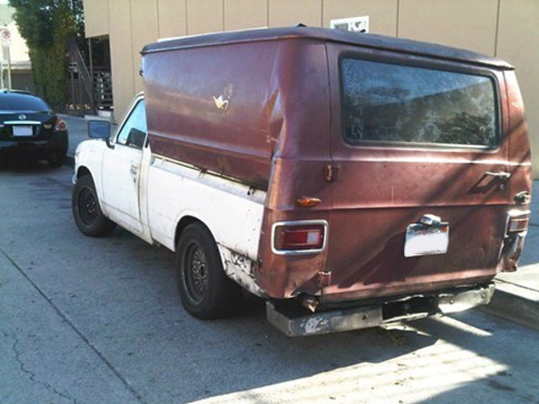

    What most guys do is just buy an old van to cut up and use that. I see these things absolutely everywhere.
