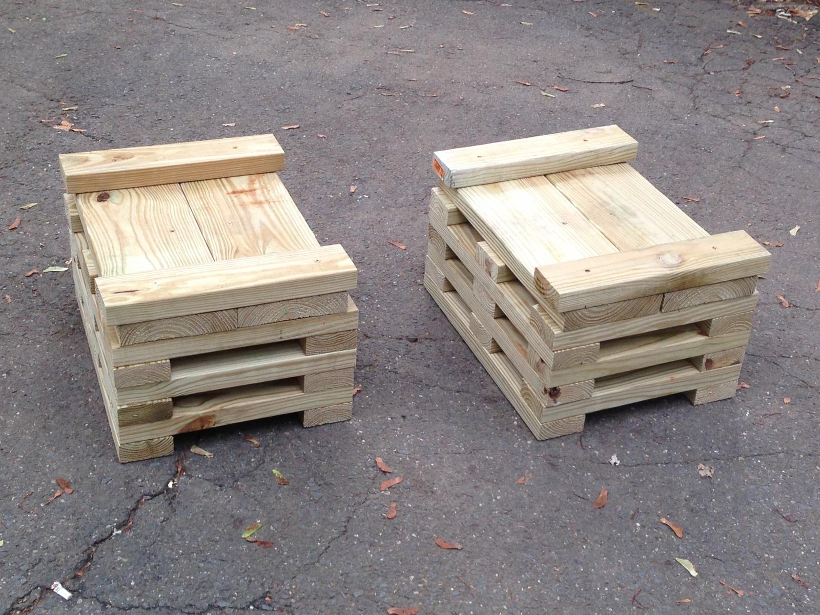

Homemade jack stands. Sketch or good to go?

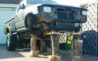

    The only acceptable wood jack stands.
    I used them to lift all 4 tires on my Miata to work under it. In that instance the wood blocks actually felt safer than using 4 jack stands.
    But just so you know metal jack stands don't go bad, I've had mine for 20 years. Hell my dad's set has to be at least 40 years old.
    Seems really, really, really stupid to cheap out on a very critical safety device that doesn't cost that much in the first place.
    Also always remember to chock your wheels too.

    Okay I agree these are sketch. I may beef them up with something to make them solid and sturdy.
    Also to those who think I am poor and cannot afford good quality jack stands. I actually own real six ton jack stands. And they're not the recalled Harbor freight ones. I had these 4x6's and some large bolts and wanted to do something with them. That's all. People jump to conclusions really fast. I didn't even do any work under the truck with these.. Chill out or talk some shit just don't be so serious.

    Then why replace a good tool with homer's wonderbat?
    Toss 'em or repurpose to a less load-bearing application. Its just scrap wood.
    We did talk shit. Nobody will condone your tinkering on the off chance that they will be later accused of encouraging/egging on a fatality.

    thats a lot of $$ in wood there. Just go get some jacks

    These would potentially be useful when used with a proper set of jack stands for some additional support, but definitely not as the primary/only means of supporting a vehicle

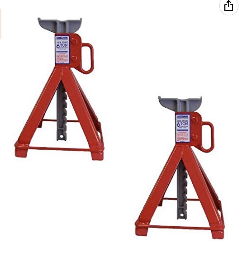

    https://www.amazon.com/US-JACK-D-41610-Garage-Stands/dp/B00P248NYO/
    I have 2 pairs (4 jackstands) of these. Picked them up when they were still $200 a pair, not $275.
    Expensive peace-of-mind.
    Ngl - I trust my life to them, no backups. I don't drag a tire under the frame or stack up 4x4 wood cribbing every time I get under the truck.**
    **I do have a dead flat, smooth concrete garage floor to work on, I chock both sides of both on-the-ground wheels (with massive rubber tire chocks fit for a bus) when I am only jacking up one end of the truck, and I use max body strength to shove & oscillate the jacked-up truck in all directions to check jack stand stability before I go under.
    Doing this last part every time is useful because most of the time I do hear creaks and pops as the jack stands & their bases shift tiny amounts to "lock in" against frame rails & concrete floor surface. After a couple of seconds the settling is done & there's no further movement no matter how I push.
