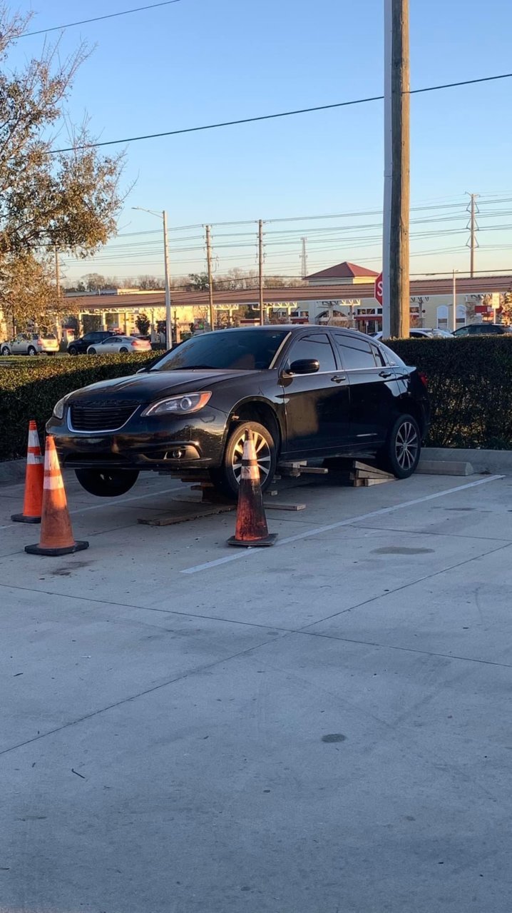

    He asked for opinions. We are just being honest about it.

    To OP’s credit, he does have a jack set up as a third contact point.

    Depends on what you’re doing. Tire rotation, sure. Crawling under the truck wrenching on stuff, I’d get real jack stands.

    I'd be more comfortable if they weren't sitting on the end grain and had some feet.

    It's a pretty serious subject.
    To act like the thing preventing you from being crushed by a two ton vehicle isn't serious is asinine.

    100% Sketch. But hey I ain't the one crawling under it. Play stupid games.....lol

    Sketchy as hell.
    But as you stated, you already knew this.

    I've been using blocks probably the same length for years. But I got some screws just short so they don't stick out. Drill holes a little smaller than the screws, then drive them in. Keeps the wood from splitting.
    If you have 2 more to make em triples instead of doubles, that would be better. If you're on uneven ground, leave the nuts loose so they sorta grab the ground.
    I used to use 4x4s, I forget, maybe 6, to make a big square, 2 long bolts, washers, welded the nuts on loose. This would be the base to set jacks on to lift a railroad car, around 100k#.

    Is your organ donor card up to date?

    probably safer than harbor freight ones a few years ago.
