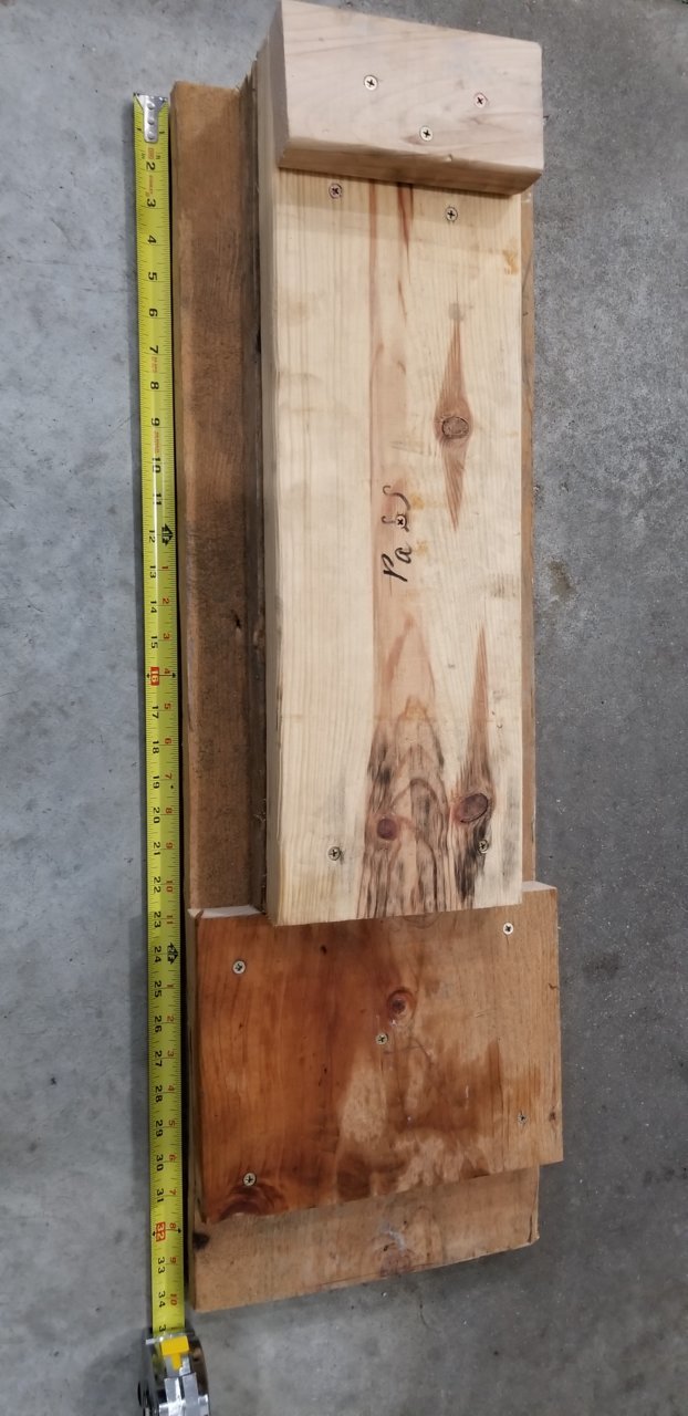

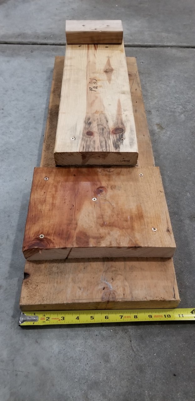

    I love them too! Nothing really there that can "fail" as long as it's lined up properly.
    Here's the rough dimensions of them...

    I'm in the camp of, those are damned strong, stronger than most here realize.
    But, they aren't stable. The base needs to be wider. Wood, against the frame of our trucks is less likely to slide than the steel of a jack stand. If you're not getting under the vehicle, and you're leaving the wheels and tires on, you'd be fine. Even if the truck fell off, you still have room under your truck to not be crushed.
    Again, they need a wider, secure base.
    If you've ever seen riggers raise a large, heavy piece of equipment, they use wood as support, not big jack stands. Wood is very strong from a compressive load standpoint, you just have to be considerate of the design and intended use.

    If this thing starts to tip the only thing holding the outriggers in place are the 2 screws on the sides of the outriggers; those metal brackets will do squat for that. If you put a piece of plywood on the bottom and linked all 5 pieces of wood it would be a lot better. Also I can't tell how good your cuts are or how long and what type of screws those are. The flusher everything is and the better it will be.
    I would still go with metal jack stands over wood ones as they'd be less bulky and I wouldn't have to worry about them being prone to as much damage over time (water and loading the main portion along the grain and causing splitting would be my 2 main concerns.) The only way to adjust the height on these wood stands is to add shims on the bottom... and that opens up a whole new can of sketchiness.

    Strength wise they are fine. It comes down the the overturning moment which is a function of geometry indicating how far the stands would need to tip before toppling. Would need to know the specific geometry to calculate. The height to base footprint looks a touch on the small side. In pinch I'd use them without hesitation. Personally I'd notch the saddle to center the load and maximize the the overturning moment. The way the Plan B support legs are attached doesn't add much...just the four the screws per side...the straps are nothing more than a week hinge. Jacks stands are generally a better choice, but I doubt many smaller jack stands, 2 ton types, have any better overturning moment and are in fact less strong axially.
