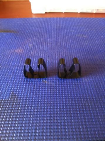

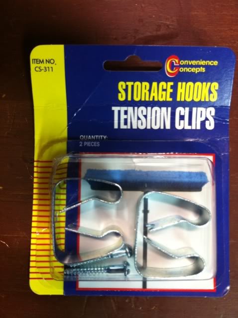

    Had these laying around the house for awhile...I bought them to mount some brooms in the garage but ended up using another system. I was going to toss them away but thought they would be perfect for a Mini Mag Lite!
    You can get them at OSH for under $3

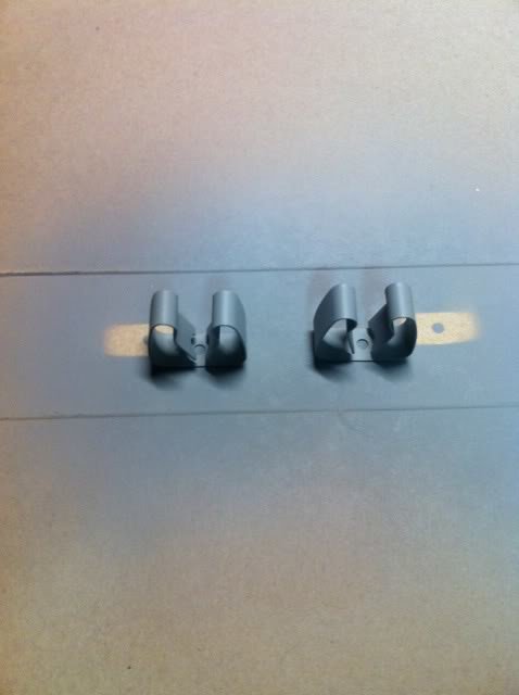

    First I painted them black to they wouldn't get look so "industrial" in the Tacoma :D
    primer...
    ...then paint

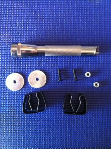

    Items needed to mount it

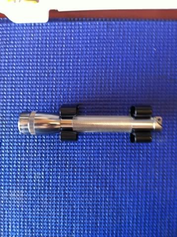

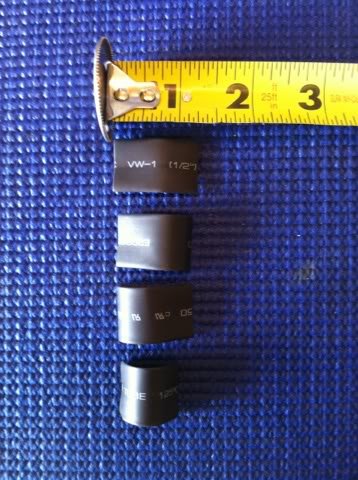

    Added shrink tubing to the clips so they will not scratch the Mag Lite

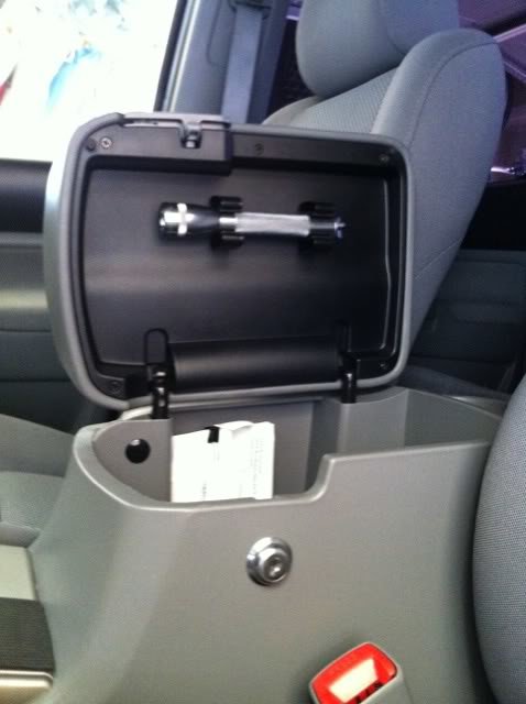

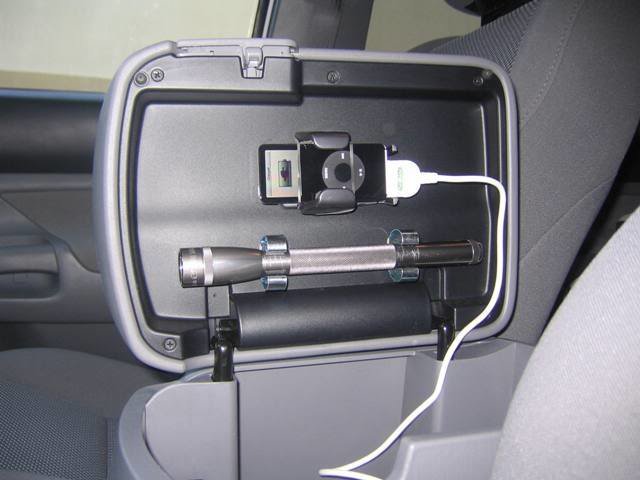

    I decided to mount the Mag Lite in the center console lid. The interior piece is very easy to remove. Just 5 screws is holding it in.
    Mock the position of your Mag Lite and mark your mounting spots. Then drill 2 small holes.

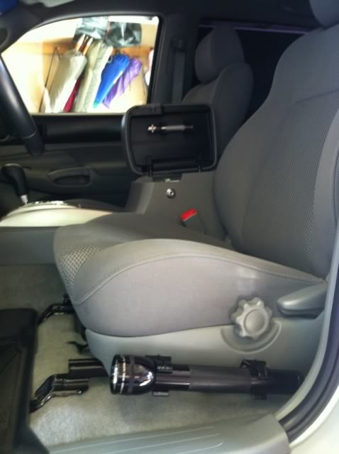

    Reinstall in the truck and voilà!

    That's a great idea putting it under the lid like that, might just have to do this one for my mini Surefire.
    Nice work!

    nice job how well does it hold the maglite i looked at those and didn't think it would hold so i used a spring loaded broom holder

    It holds it in well. The shrink tubing gives it a little grip but you can also press in and pull out the clips to adjust them for thickness.

    I dig the ipod mount. My luck though I'd put something in the console that is just too tall and smash the face of my ipod my I close it.
