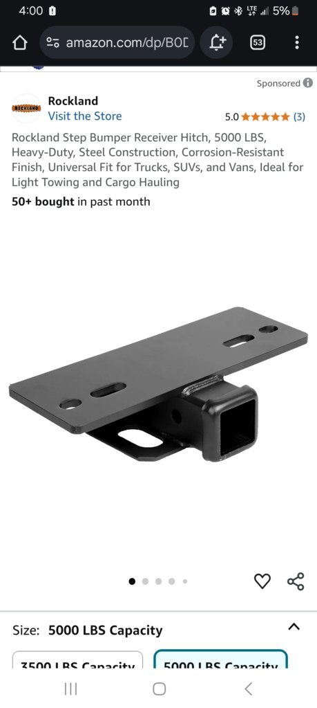

    I'm building a rear bumper for my 2004 tacoma, based mostly off the design from overlandunderbudget.com (3x5" tube bumper). Looking for advice on how to build the hitch receiver. I don't want to incorporate the receiver "in" the bumper, rather I'd like to just weld it to the bottom of the bumper. I do pull a small trailer occasionally with firewood, generally not exceeding 2000lbs, combined trailer and wood weight. I'm thinking of welding this receiver to the bottom of the bumper, and possibly reinforcing it a bit:
    I plan to fill in the holes in the plate with weld, and possibly as reinforcement weld a piece of 2x3" tubing on the back end of the plate and attached to the inside sides of the brackets that mount to the truck frame. My question is, will this be strong enough, assuming my welding is good?

    Yeah I don't have any pictures yet to describe what I'm talking about. The best I can say is I'm going to weld the above hitch receiver to the bottom of the bumper I'm building that follows the design in the following video:

    The pictured part is designed to be bolted in place. Does it come with bolting instructions? If its good for 5000 lbs as advertised - why not just create a way to bolt it on? The mating plate has to be attached as securely to the bumper - as the part's mounting plate is attached to the hitch box.

    Seems like extra unnecessary work to weld a plate to bumper so I could then bolt the hitch on.
